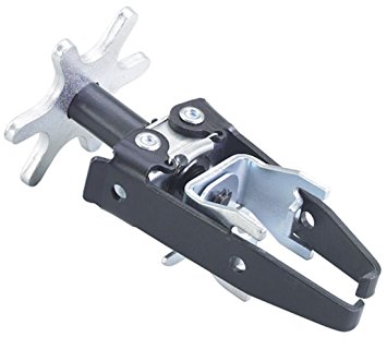

But this is a very easy job to do with the engine still in place, should you have the correct spring compressor on hand. Chances are you could get one of the cheap ones from the parts store that cranks down from the top and clamps the spring. Easy for stock springs, but a huge bitch for any sort of spring that has some ass behind them, i.e. solid roller, solid flat tappet, etc.
This is my preferred spring compressor...I love this one.
I can change springs/seals with the heads installed, no need for compressed air, valve locks come off easily with a couple gentle taps with a rubber mallet, etc. etc.
