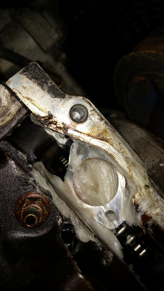

ai1266.photobucket.com_albums_jj521_XJsavage_Mobile_20Uploads_IMG_20150105_195344486_zpsfe210a35.jpg
The ole Vaseline trick worked! Had a hard time keeping a straight face texting, explaining to my buddies what I was doing exactly.... Jamming my hole up with Vaseline... Mmkay.. :lol:

can you fellas help me understand the mechanics of this. if we are plugging the 'pickup' side wouldnt we be preventing the pump from sucking up the oil? Wouldnt it make more sense to plug the "out port" or whatever to create the vaccum on the pickup side until there is enough pressure to punch through the vaseline on the "out" side of the pump?
^hope that made sense
im gunna do it cause i trust you guys. Just trying to understand *how* that works
You apply a petroleum product into the pump so it has substance to pull/push as it spins. The Vaseline will be forced through the outlet and allow the oil at the end of tube to be sucked up into the pump.
This.
Drop the pan, pull the pickup, and pack the pump full of as much vasoline as you possibly can. Assemble, and give her a go. ;)
