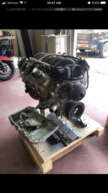

Heck I'll save a lot of trouble I've got ya a factory harness already to go with a flashed ecm with hp tunes and dbw throttle pedal with a semi built 4th gen 6.0 with ls2 intake, fuel rail
throttle body Texas speed stage 2 cam for 2000$
You keep that Texas Speed cam and that'd be a deal! :D
