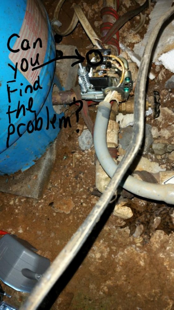

Ok..I saw Ron's post about well house covers and I decided to post my own problem from yesterday and last night.
Came home from playing in the woods. My wife washed her hands to start supper. Kids went to wash up and poof.. No water. Wtf?
After checking the breakers, which were fine, I slipped on the overalls and headed to the crawl space to check the pump tank and pressure switch. Pump tank seemed fine but the pressure switch didn't have power on one leg. Spent over an hour scratching my head and just staring at it. I kept checking the same things over and over. Flicking the switch on and off and manually moving the pressure switch trying to make sparks..Still Nothing.Crawled back out and killed the power to the switch and decided to replace it...again. (I just replaced the switch last month)Crawled back in to start the sucky job that I was to cheap to call a plumber to do. I'm glad I did. So now I'm all up on it getting ready to start unscrewing wires and I saw the problem.
A damn stink bug had crawled into the switch it must have just crawled there while Brooke was washing her hands..then the switch kicked on and the bug got caught between the contacts.
Turned out to be a cheap fix after all. But what a pain in the arse.

Spider did that to my hvac unit 4 years ago. Took a couple hours to figure out. The struggle is real son

I have had regular sugar ants stick a contact on an AC unit and cause it to freeze up.
I keep Combat ant bait there now and change them out a few times per year.
