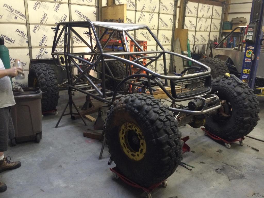

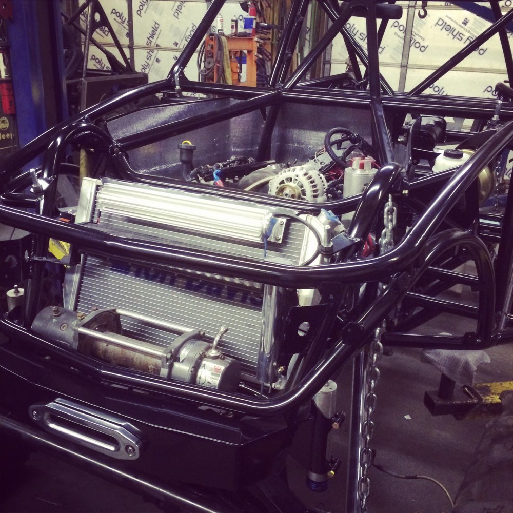

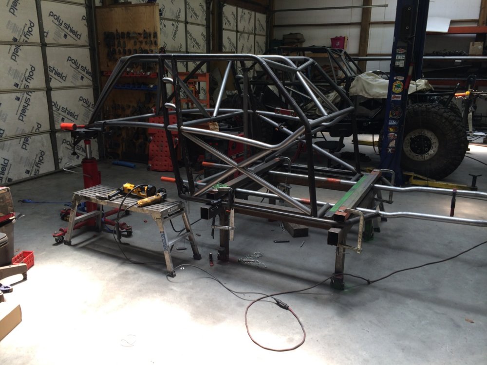

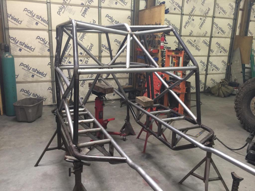

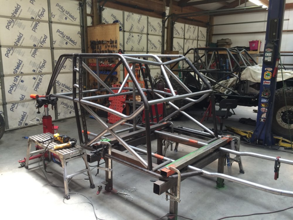

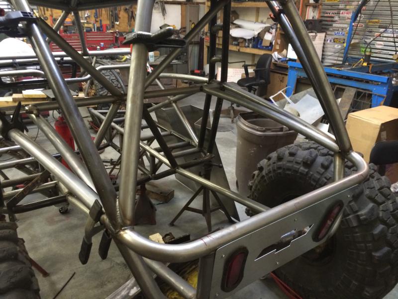

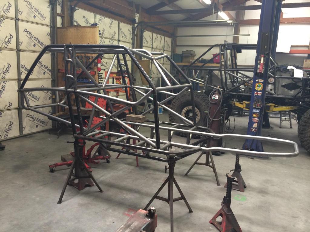

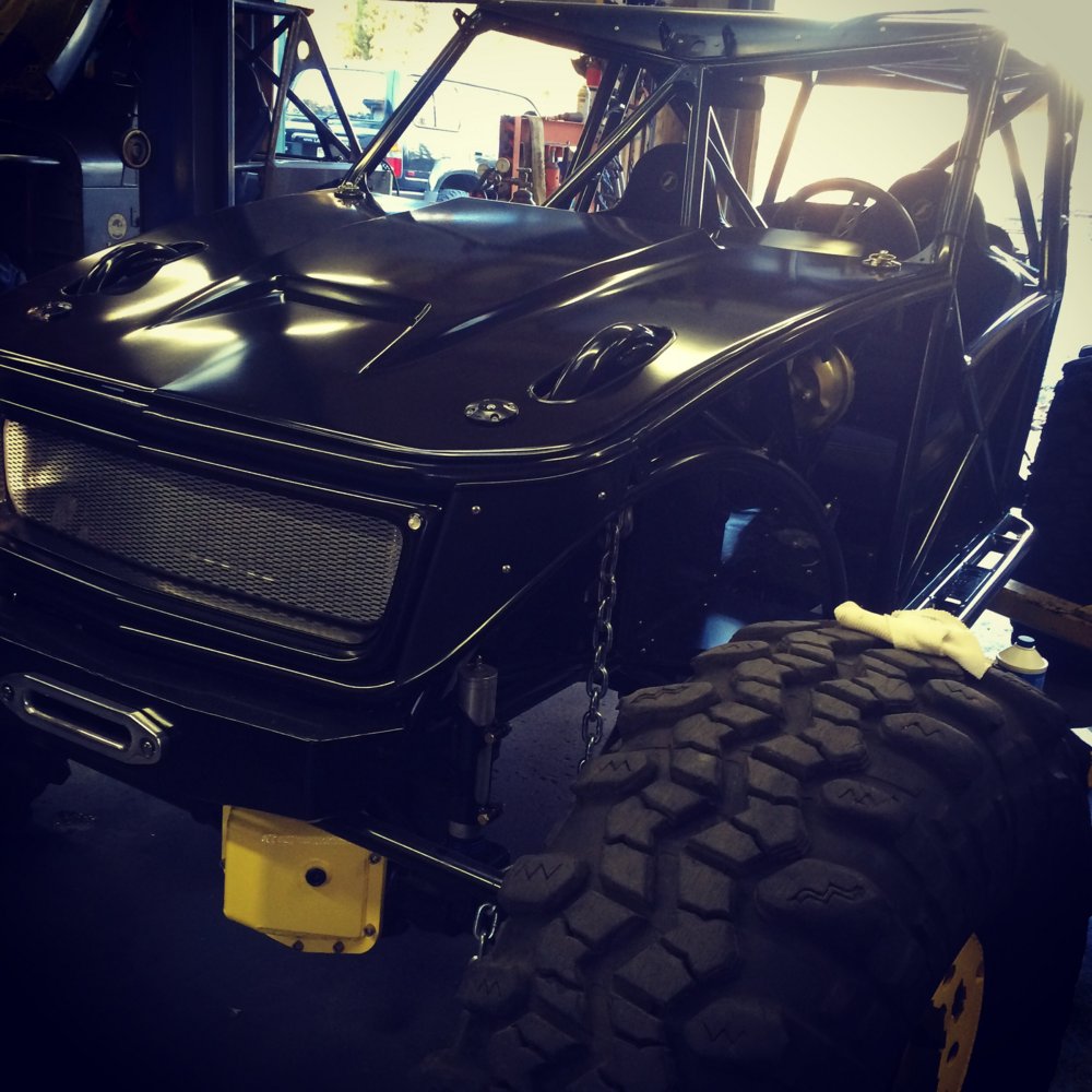

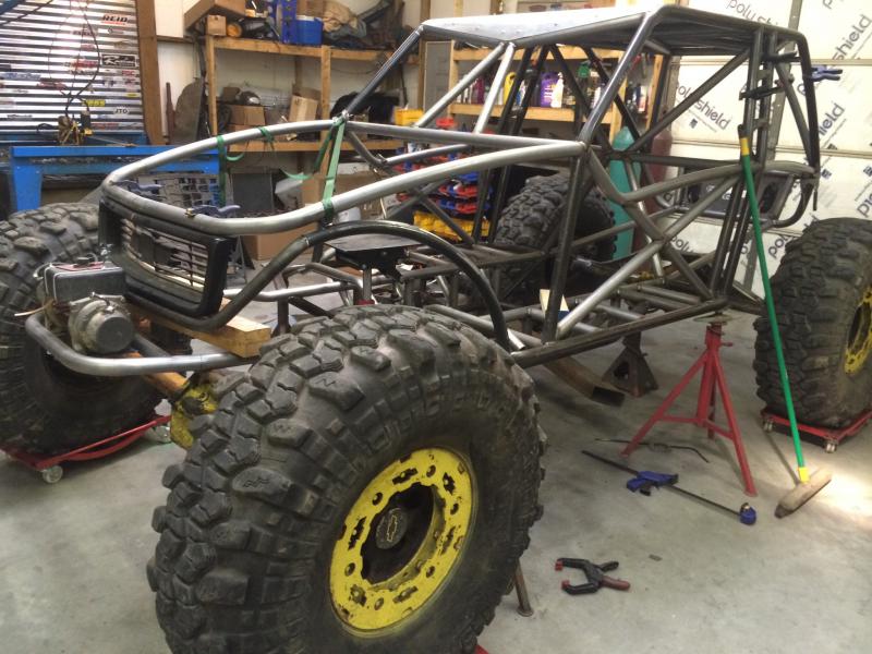

This is a new 4 seat build here at the shop. We just go started on the chassis and i wanted to get up some pics. It uses the proven 4 seat "Triple Threat" Chassis design. A little change on the front clip though.... More details to follow, especially for bow tie fans....

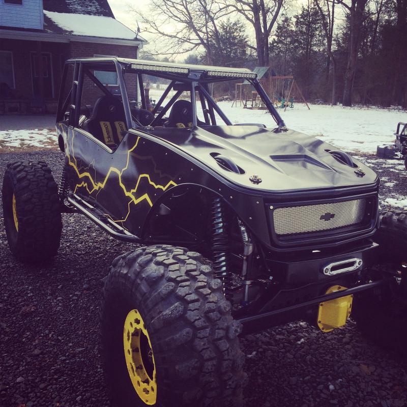

should be interesting to see how the front clip ends up. it'll be cool and make the bowtie fans happy :massey:
couple he sent me from his phone!!

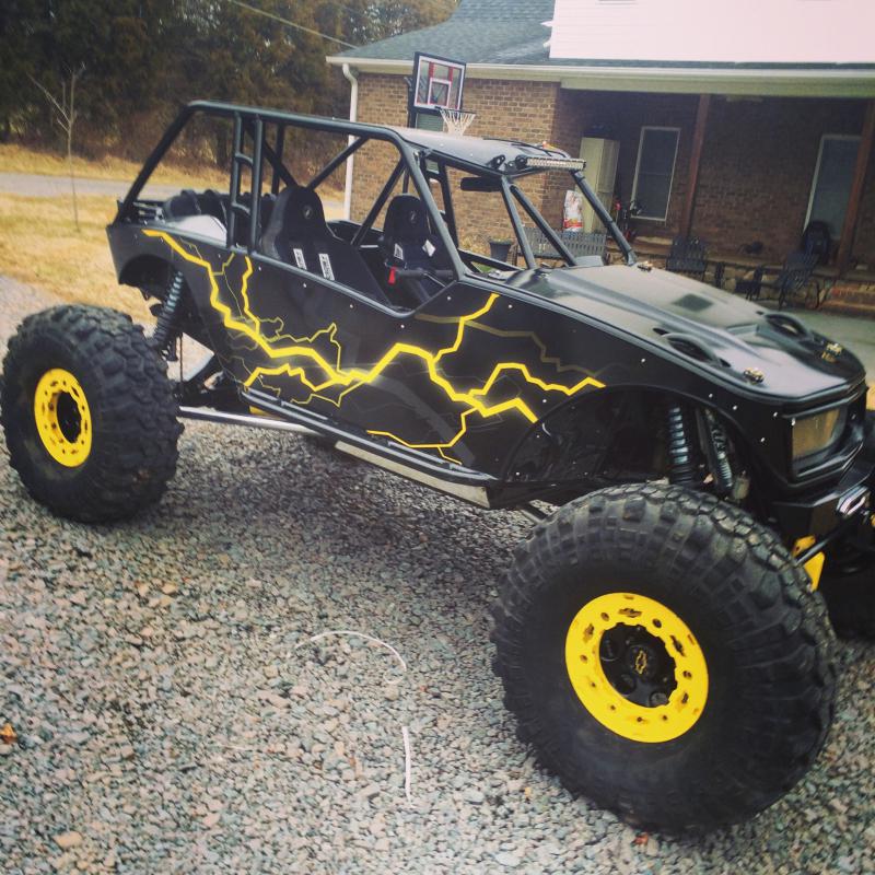

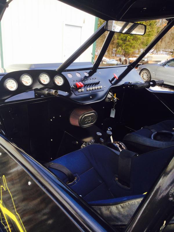

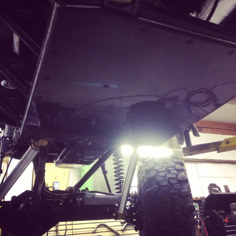

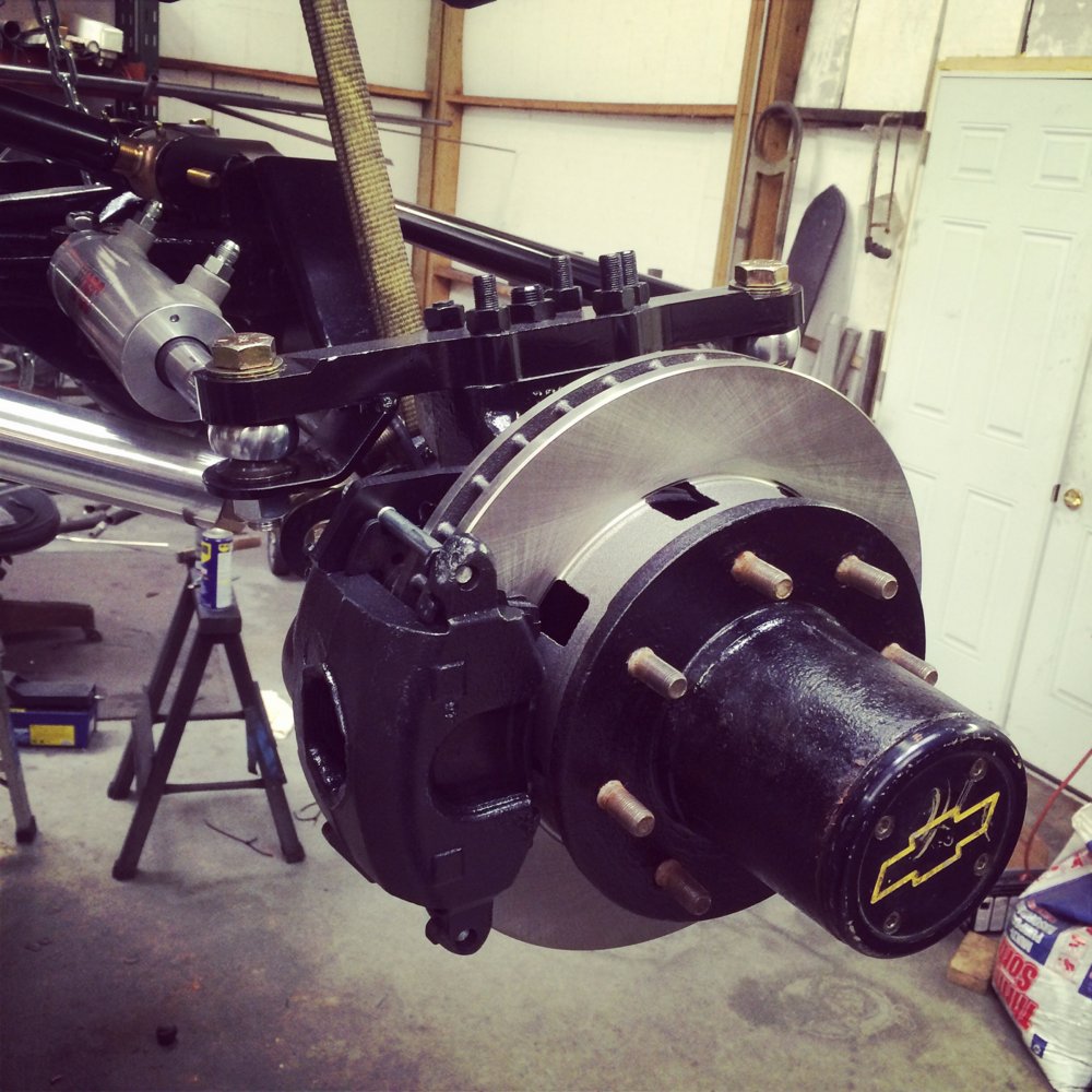

here's a decent list of specs going into it.....
6.0 LQ4- cammed, headers, Texas Speed heads (225 as-cast). should be in the 450hp+ range (dyno'd 362 with 35s on a dynojet)
th350- deeper first gear swapped
atlas 3.8
D60/14- 5.38s, lockright/spool. 14 bolt has 1541h Yukon shafts and D60 is 10 factory 35 spline with 300m joints. drive flanges
42" SXIIs on H1s with rock rings
winters shifter

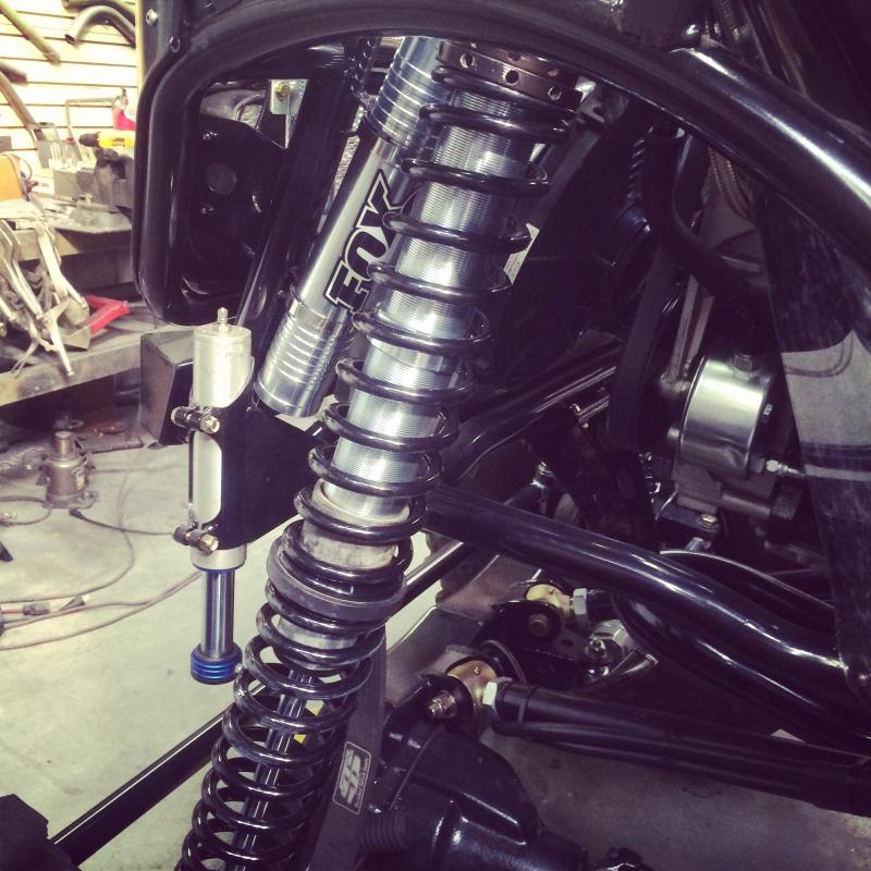

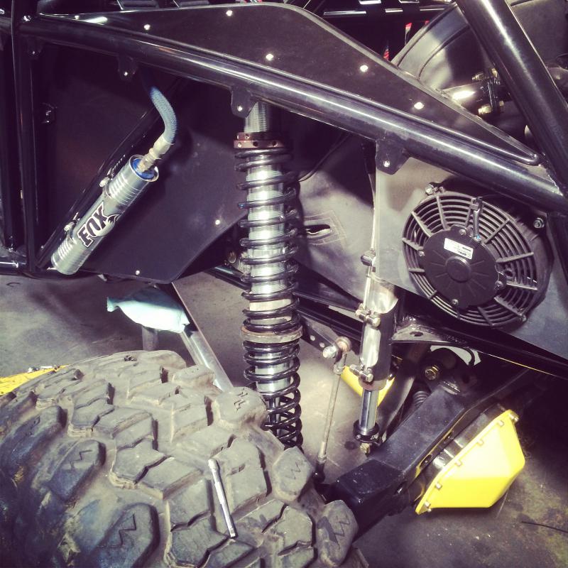

fox 2.5 co's

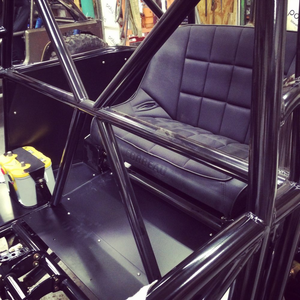

corbeau seats with 5 pts
psc full hydro
I'm sure there's more I'm forgetting.
not a roller yet, but getting there

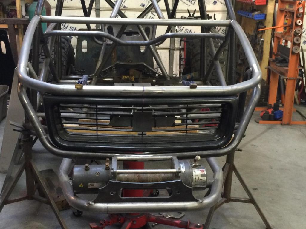

awww.pirate4x4.com_forum_attachments_general_4x4_discussion_146ac5f4b7c7dc77e0568883d8dce6cac0.jpg

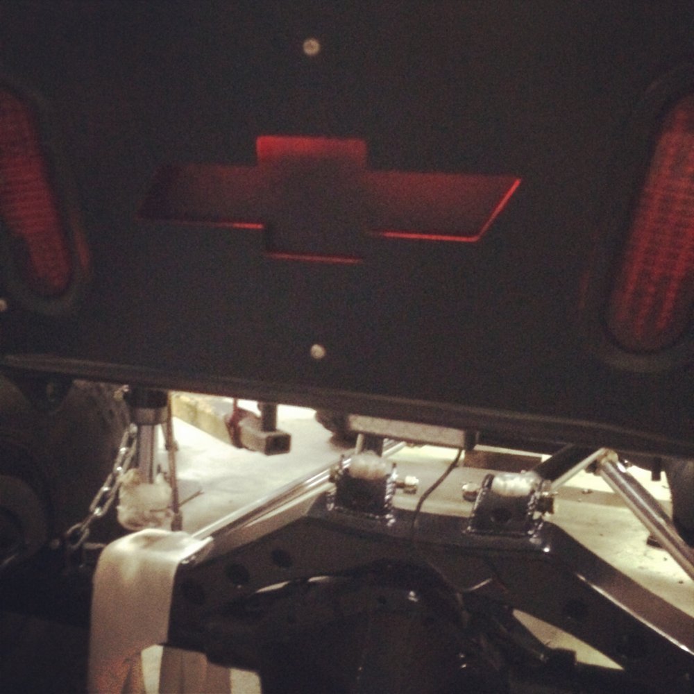

pretty sure it's from a Sonoma (since my last rig was a built s10 and wanted to keep a similar look)
