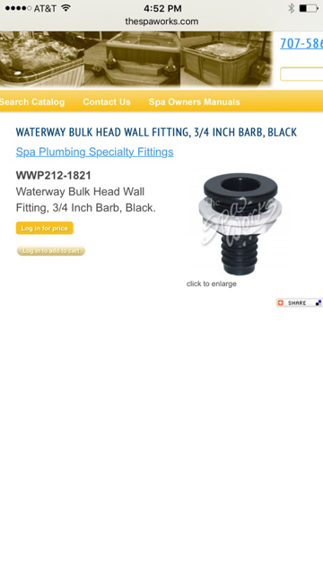

Pool supply was a good idea, probably something similar to this with a smaller diameter.
Thanks again. Searching for bulkhead fittings led me to aquarium supplies. Even found a ball valve too.
