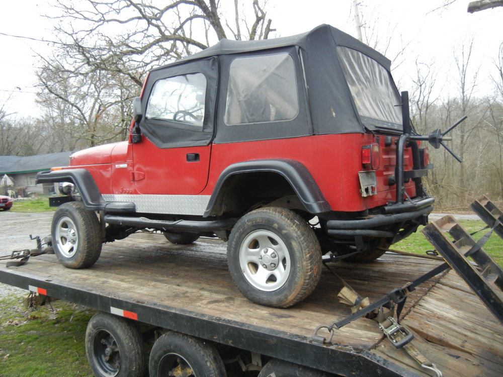

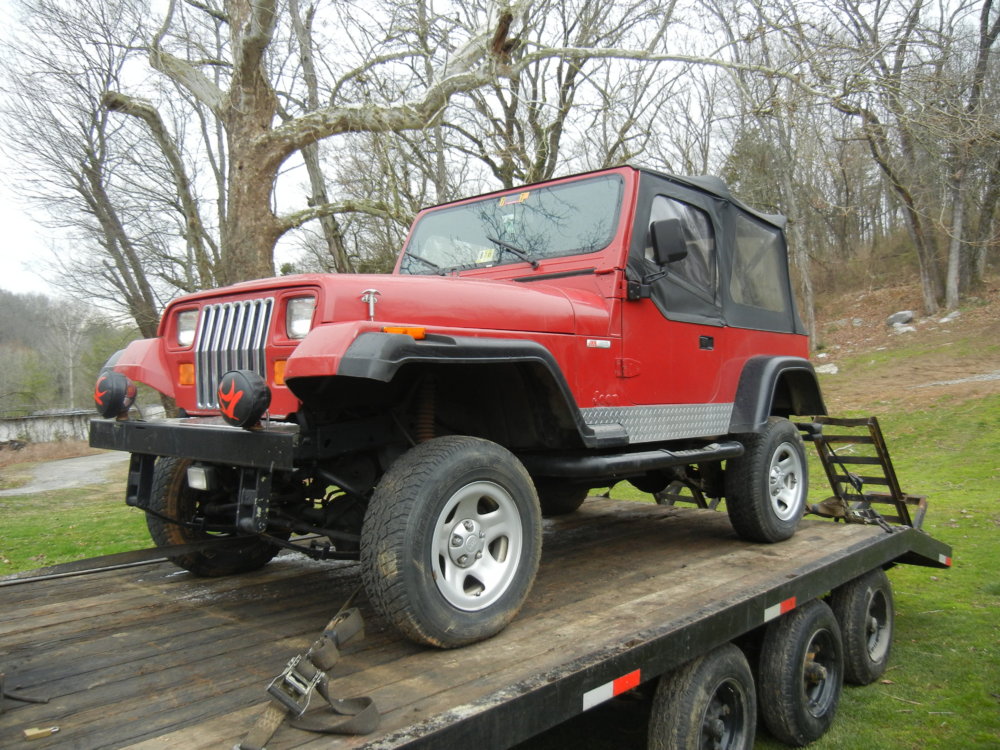

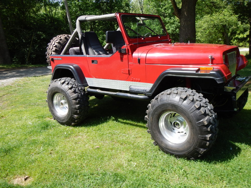

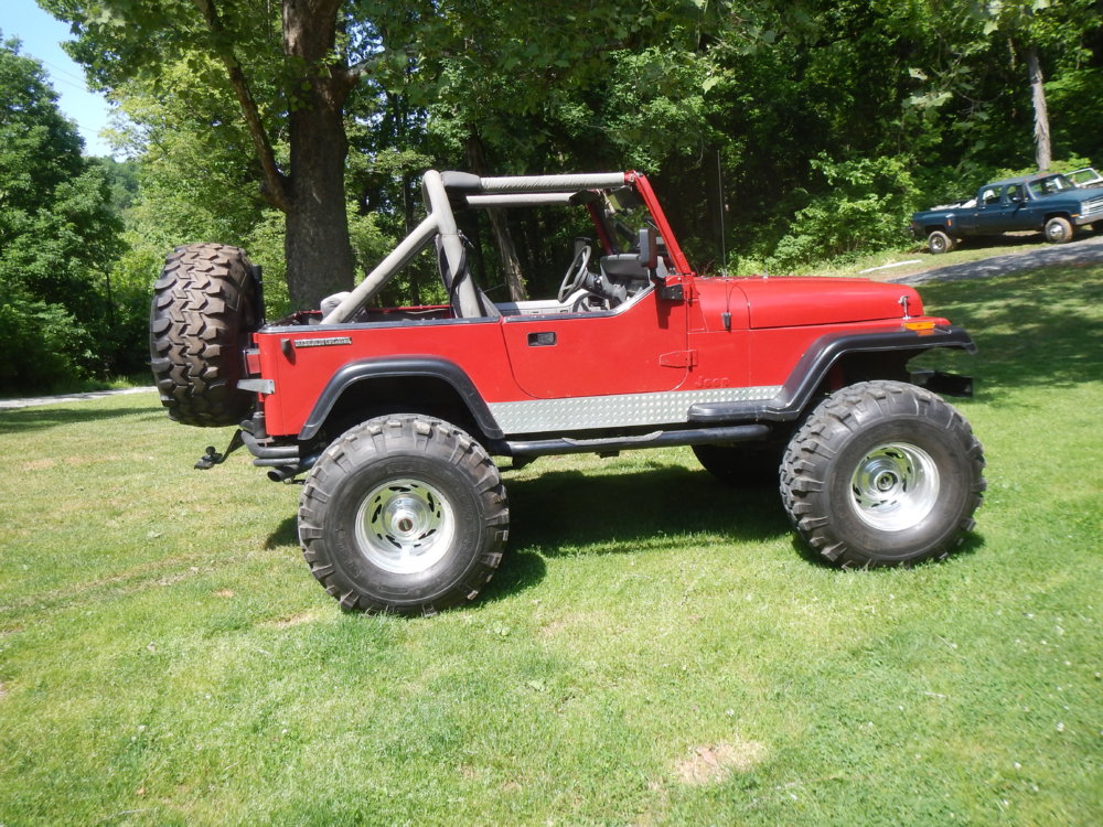

I bought this YJ a year ago Feb off a guy on here and have been workin on it since.MY wife wanted a big axled,big tired Jeep to cruise around in the summer w the top down(the jeeps not hers).

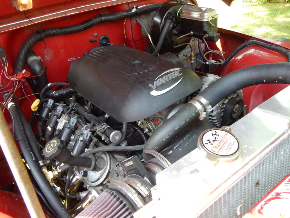

Short of tieing up some loose wires and fixin the broke glove box door and dash bezel its pretty much done.
03 5.3 w 90K,Jims perf harness,TH400,SYE dsd Chevy 241,Ford LP 44 front w crossover and 4:56's,14 bolt rear w disc and 4:56's,38.5/16/16.5 TSL's on 16.5X12 Weld typhoons
