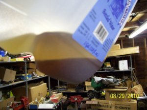

i just spent 2hrs draining / flushing / my fuel tank and removing the carb and flushing / scraping / cleaning & reassembling .
all this on my lawn mower .
in the last 2 years of so i have had nothing but problems with my lawn mower and gas. yes diffrent stations to try diffrent fuels.
the 10-15% federal mandate of ethanal fuel mix for all fuels sucks big time.

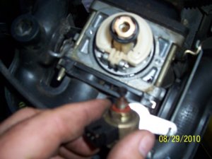

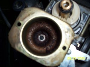

this stuff sucks up water 10-20x faster than reg old gas. i had so much crap in the tank it wouldnt run. so i drained it and refilled. then still wouldnt run so i pulled the carb out and removed the bowl. wow what a pile of rust/crap/scale inside of there.
scraped / filed / rinsed out all the crap i could. then reassembled the whole lawn mower and she finaly fired up and now runs good. my mom even said it sounds better than it has in a long time.
the fed's need to get there f__kin heads out of our gas and tires ( tire pressure sensors ) and get a fu__in life and get the more important stuff done first.
pic #1 = bowl. almost 1/16" thick of junk
pic #2 = some sensor or valve in bottom of bowl. full of junk
pic #3 = tiny bit of gas on top of all the junk from tank and carb clean out. prob still some junk in my electric fuel pump i used to remove gas from tank.
sorry for my rant but i hope this helps someone else.
