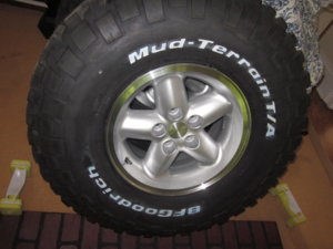

Here is the tire wheel combo I will be running. 15X8 OE replica wheels. They look awsome, was a little worried about a replica type wheel but the quality is amazing. The tires are 33X1050 BFG's. More to come soon....

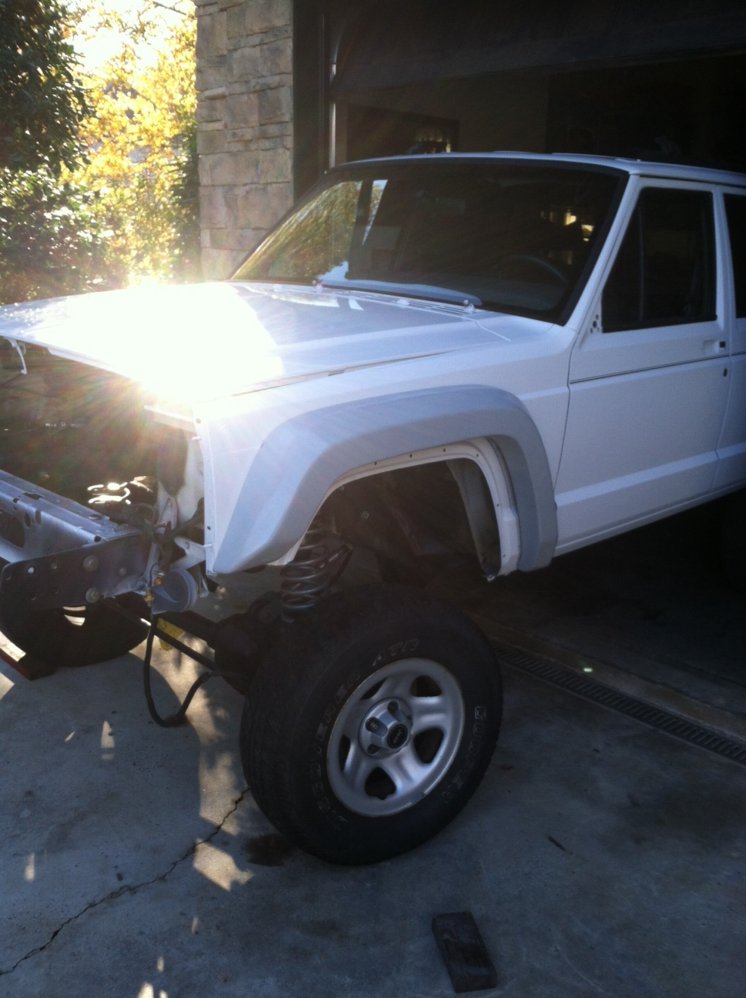

Almost done with another flare....... Been busy working on a Comanche as well. Trying to be carefull to perserve as many pinch welds as possible on the rear. I will have to cut through and re-weld the inner fender but don't want to cut any more than I have to. So far I am happy with this build. The jeep almost looks like a "Hot Wheels" car.

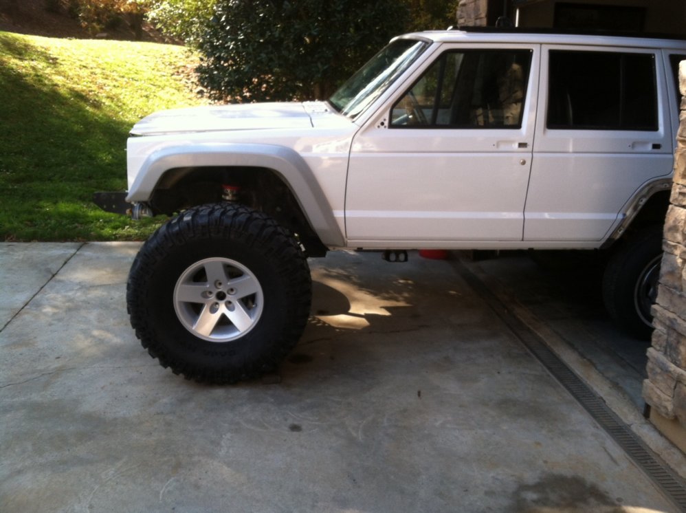

Still have a little more trimming to do on the rear fender but getting closer. The second pic is close to ride height with the 36 inch tire. Looks like I may lower it a little in the rear...

I started working on this again a few weeks ago. I finished cutting sheet metal and drilling holes for the flares. I also bed-liner sprayed the lower body panels of the jeep. All of these areas will be covered up by the flares and body armor. I figured this would provide additional rust prevention.
I had the flares color-matched to the jeep. They turned out great. It took painting them 3 times to get the color right. The jeep is a little tall in this pic. The engine is not in yet. I also plan to stretch the front about 2 inches

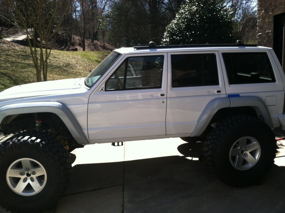

Fenders done! Also installed body armor at the rocker panels and at the bottom of the doors. I had them powder coated light grey.
