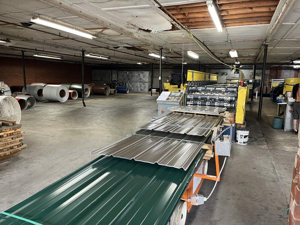

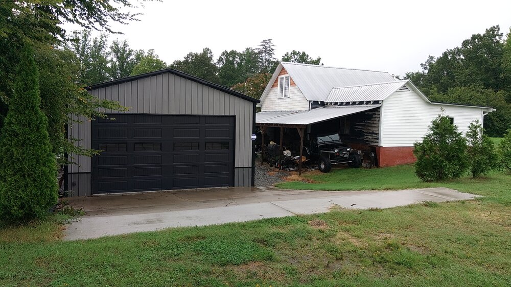

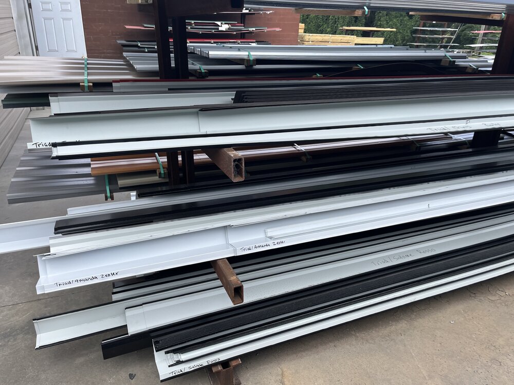

Appreciate the referrals fellas. Jesse and Triad are good people (considered buying them at one point). They get their metal from me. He’s even built a few carports for me when my crew is too busy. If you want additional quotes…I’d definitely see what the best price I could do through me, for you. But you can see some of triads orders on my shelf…
The green carports are the ones he put up for me about 6 months ago…

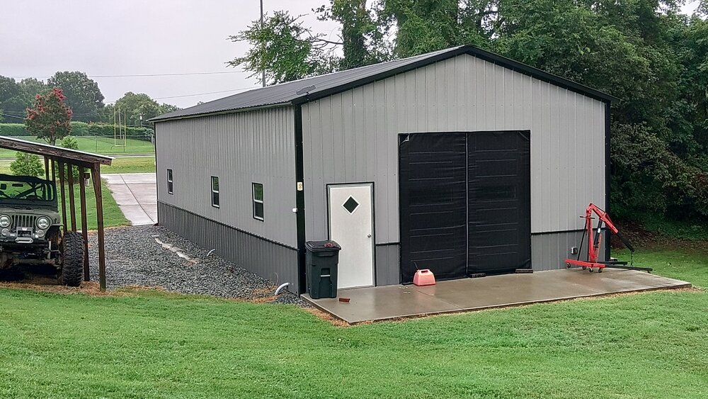

Not trying to hijack the post, just following along... This has me SERIOUSLY thinking about doing this exact same thing for just car storage to free up space in my shop. This would allow me to park 2 vehicles plus the golf cart and 4-wheeler in there and get them out of my shop. Ben, I'd be interested in getting a quote from you as well if the offer is open to any of us. I'm not dead set on it having to be those exact dimensions, but would like to keep it at least 24 wide so that I could back my CCSB (roughly 21ft) in and close the door.
Not sure what provides the most useable space, RUD separated by big space and WID in the center like pictured in Triads post, or the two RUD on one side and all the open space on other side of the building with the WID.

Absolutely...shoot me a note with some specs and I'll get anyone in contact with one of my sales folks.

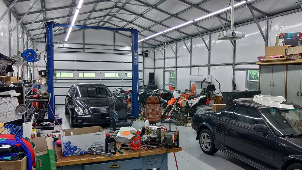

Projector included? Nice mancave!
If you plan on insulation do it now if you can afford, batting seemed to be the best among my research. To make it look nice it needs to be put up as it's being built. It is however pricey. Skip the roll up doors and put for real, insulated, garage doors. I put in side mount lift motors on my garage doors so I would not have a third track hanging in the center, again pricey but worth doing if insulating. I have 3 ton mini split that will heat and cool without issue. I spent extra $$$ to avoid having mine look and feel like a big metal box in the back yard. So 1500sq',12' walls, floor coating, concrete, HVAC ,rear drive way, wired, plumbed turn key was in the 50k neighborhood. That was with me doing nothing but making phone calls to sub contractors. I only tell you the total expense because I couldn't get that answer out of anyone I asked before having it built.View attachment 422523View attachment 422524View attachment 422528
24x60? Happy with the mini split it sounds like? I’m insulating my 1400sqft with 13ft walls next week and am contemplating what size mini split. I was considering a dual zone 3 ton, and it sounds like we have similar sized buildings.
