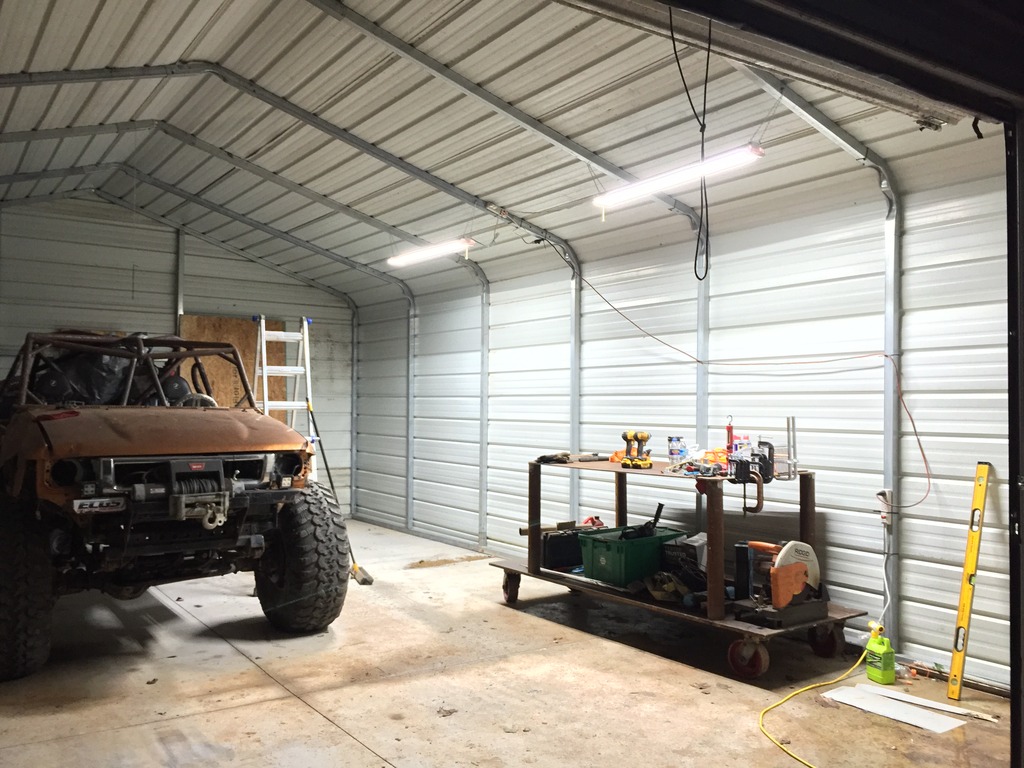

So I have a 20x30 metal, carport style, garage, 8' walls, 12' peak. Picture for reference.
ai895.photobucket.com_albums_ac151_kouperstein2_0B3392C1_3BFE_49E0_BA1D_AEE7D6A4F945_zpsfyvasfwz.jpg
It's loud as shit inside and I would like to mainly muffle the noise generated inside, not soundproof it. Aside from the obvious, have it sprayed with spray foam insulation, which is pretty damn pricey. A DIY kit will cost $1,200-2,500 and I got quoted $5,350 from a local spray foamer. What are my other options?
I picked up a few rolls of Peel and Seal, it's a roof repair tape, a lot of car audio guys use the shit out of it, since it's basically Dynomat, at literally a fraction of the price. It comes in 33.5' rolls, 6" wide, $16 a roll at Lowe's. I figured a few strips of it up the walls and across the roof should help the reverberation and help contain SOME noise. But I think the results will be rather pathetic and pretty much a waste of time and money. My take was, if it doesn't work, whatever, I can spray foam over it, since it's only 3/32" thick.
I don't really want to sheathe the inside with osb either, since the posts are 54" apart, the amount of scrap and cutting will just waste my time and money.
There has to be another viable option.
Also, anyone do or know anyone that does spray foaming around the RDU area?
