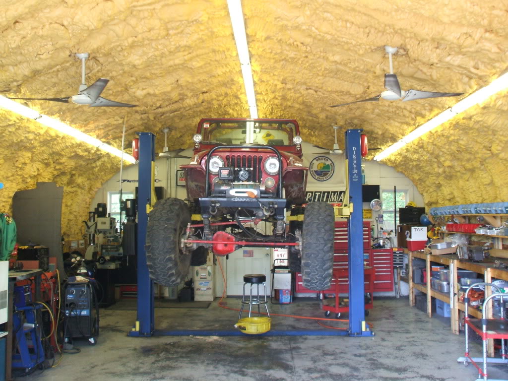

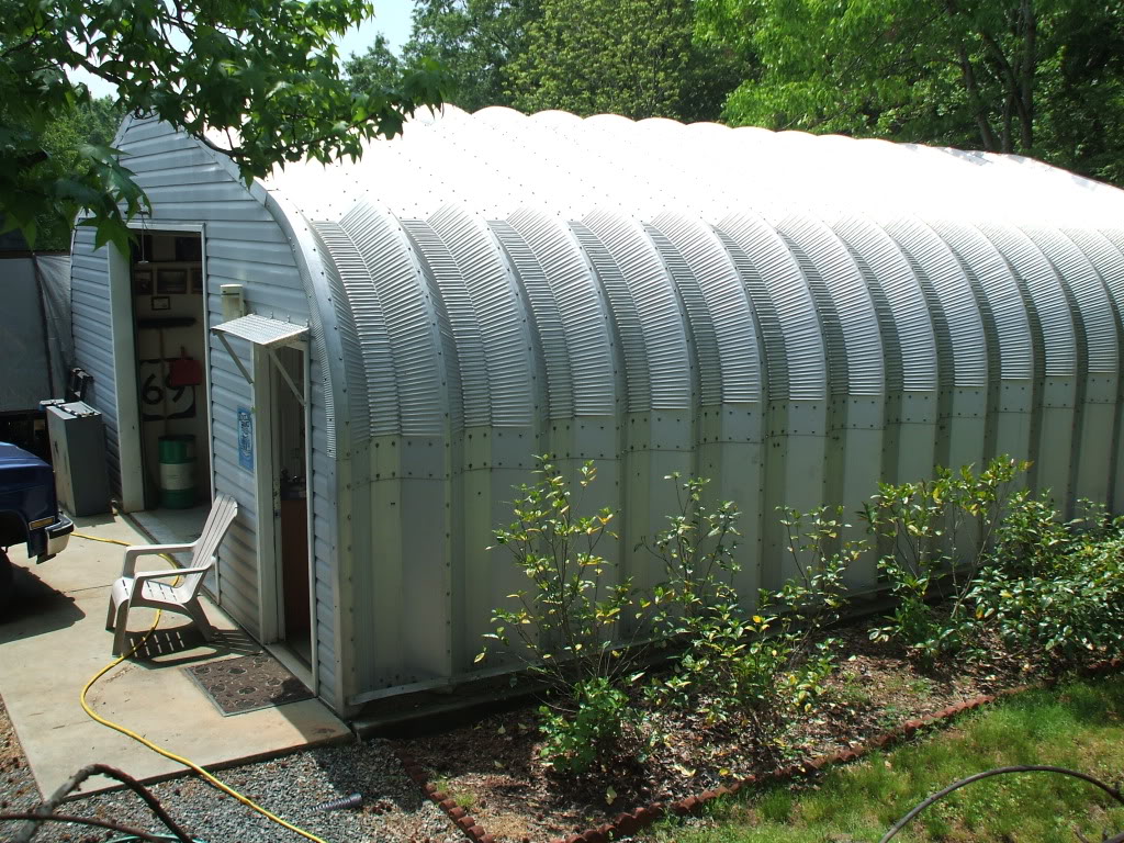

You sheet rocked and insulated the inside as well it looks like. Any worries about structural strength? Also I assume going directly through versatube allowed for a taller overhead door option? Thanks.

That isnt sheetrock. I hung 5/8 tongue and groove subfloor then painted it.
Going thru versatube directly allowed me to order exactly what I wanted. My shop is the size I wanted, with the doors I wanted, frame spacing is 4' on center instead of 5' on center, and insulation. Versatube sourced the roll up door as well.

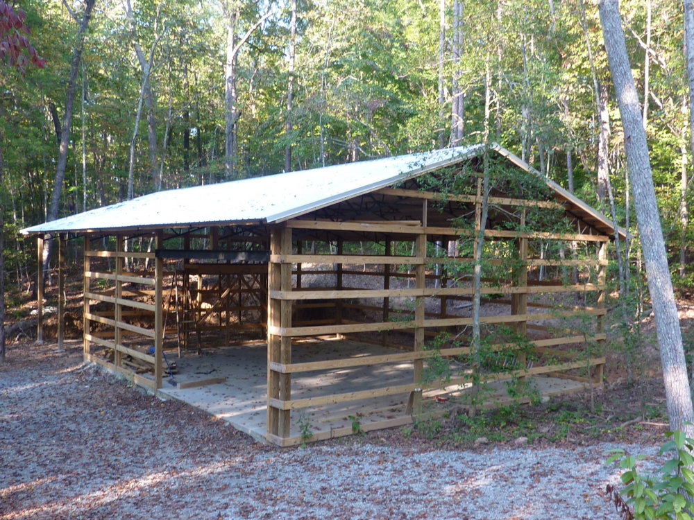

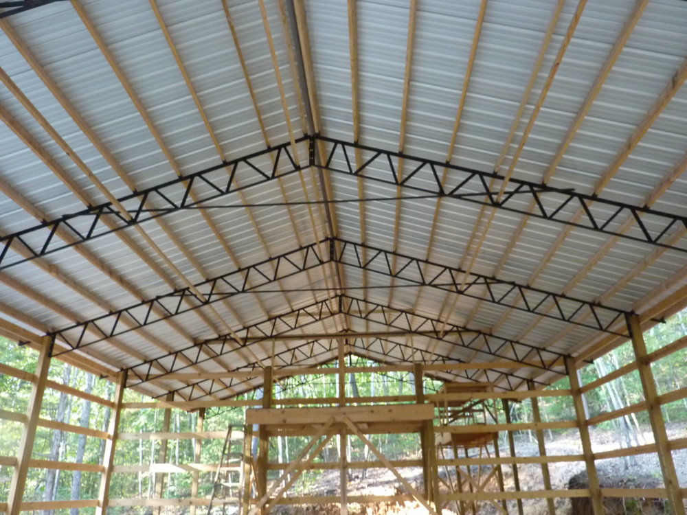

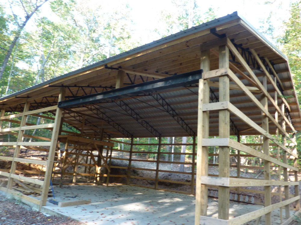

The building you linked to doesn't include concrete ($4k plus) or doors (pic your price). I'm in the midst of building a 34x40x13.5, and I've been doing everything as cheap as possible, doing all the work myself (except concrete), and its going to finish out at about $18k. I did all of the grading myself, got trusses on Craigslist for 1/4 the price of new, got a good price on lumber because my mom is in the construction industry, and I'm building the door myself because its 1/3 the cost of a regular garage door (18x11'). I am including insulation and electrical in that, but those were about $1k each. Take those out and you're still looking at $16k, and I don't see any way I could have done it cheaper other than doing the concrete myself, which would have probably not turned out well. It's closed in now, but here are some pics from late fall before I got the walls on.
Feel free to PM me about any specifics.

The key to these types of shops is the insulation(as pictured).I rented one for about two years and it was about unbearable hot in the summer and a ice box in the winter,and they sweat so sad you can forget about leavin any bare metal exposed.

Yeah, used the same material as the roof. Its $2/linear foot (3ft wide panels). It was the cheapest/simplest solution. The galvalume (silver color) stuff on the roof was only $1.50/linear foot, but I didn't want a space age looking building, haha.
