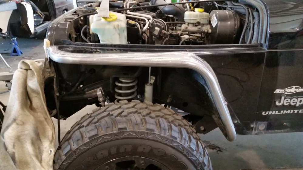

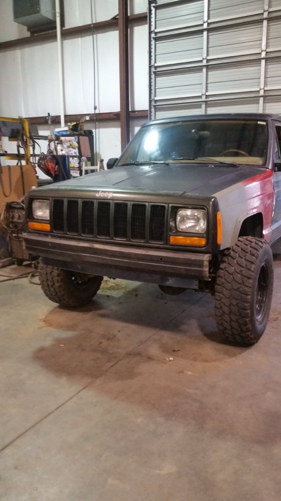

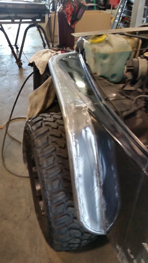

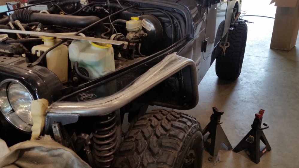

Today, finishing up a set of Tube Fenders and quarter panel armor on a Jeep LJ!
Headed to paint! Hope to have 'painted' pics soon!

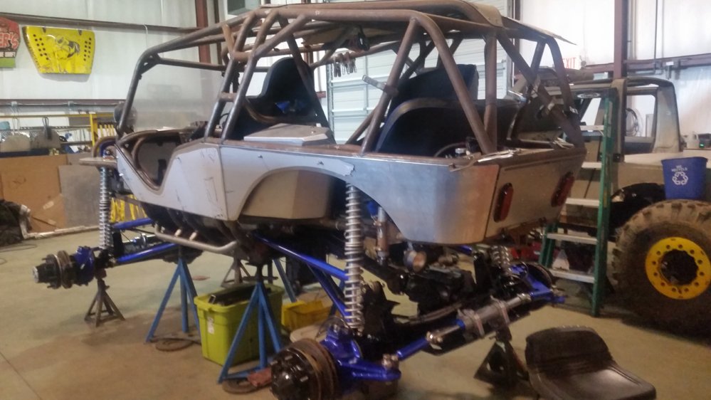

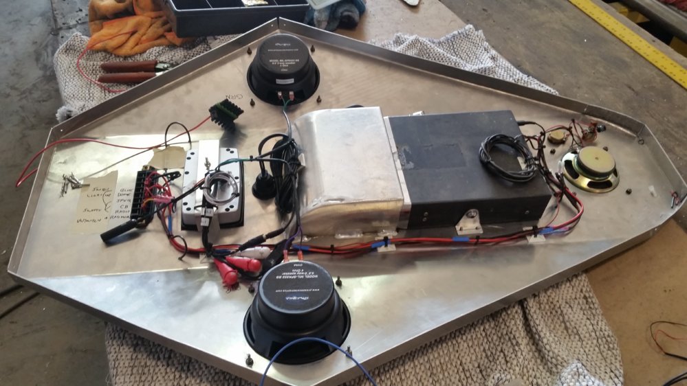

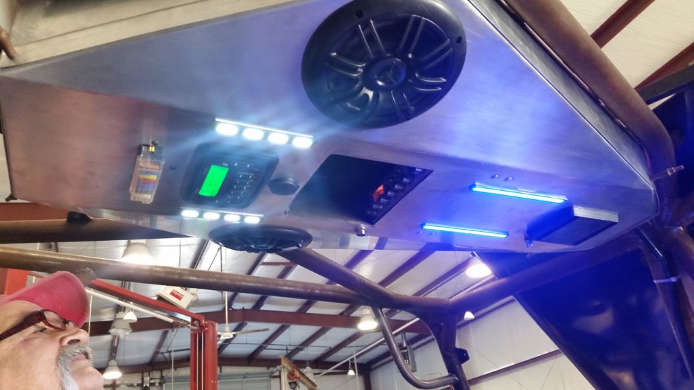

Also, Recently finished finishing a buggy for a customer. Went through the Rockwells, and sent them to powder coat. Finished fitting hood and grill and made the sides. Smoke Lexan roof. Set up the Suspension, and coilovers
Built over head console for the sound system and the CB
Sorry no better pictures! Not had much time for picture taking!

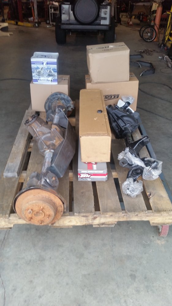

Also have two more projects in work Axles, Link suspension and cage in a Jeep ZJ. Axles arrived the other day from ECGS, ready to build!

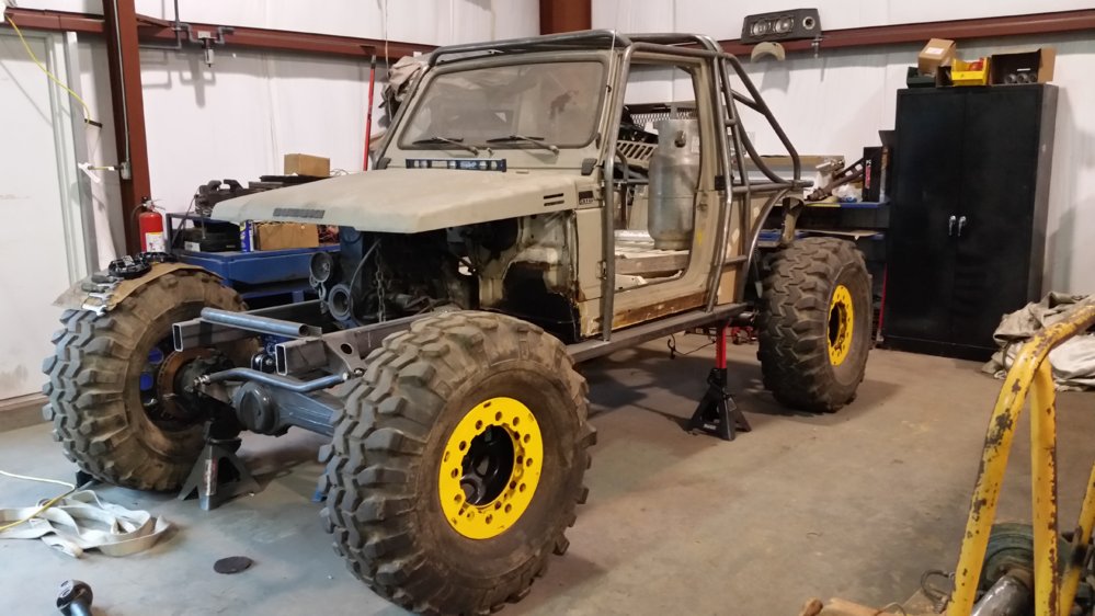

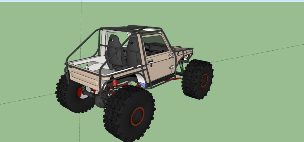

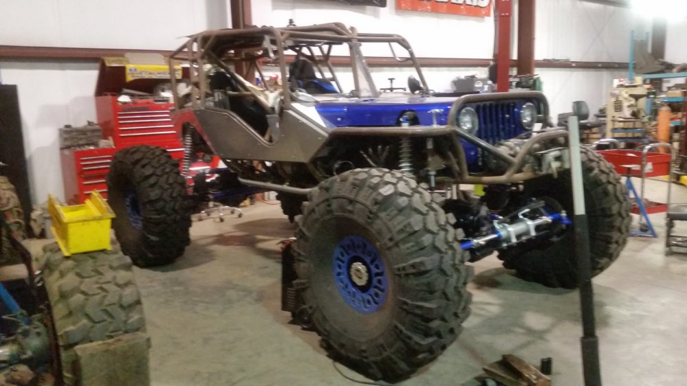

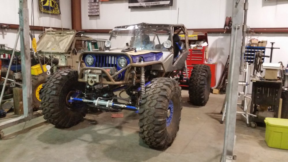

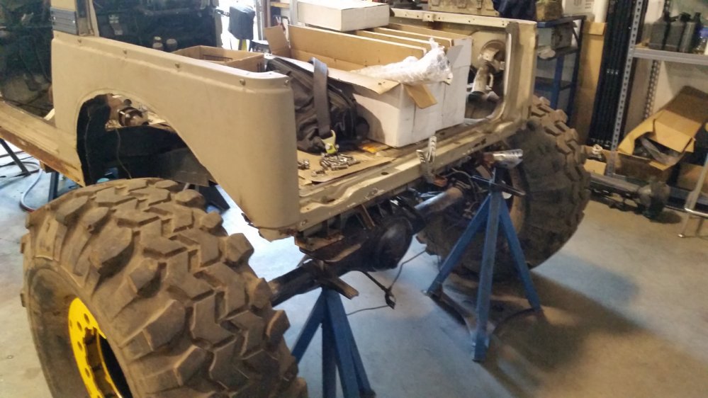

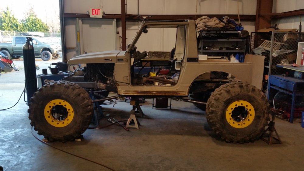

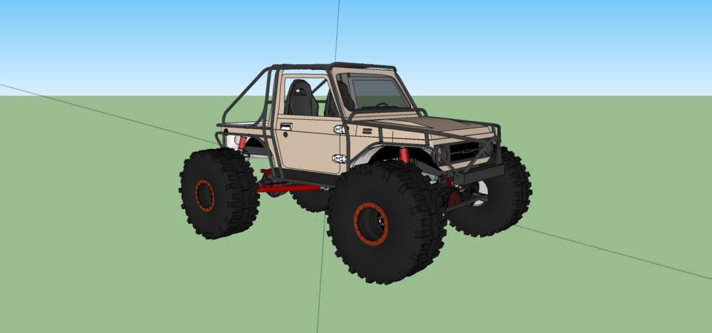

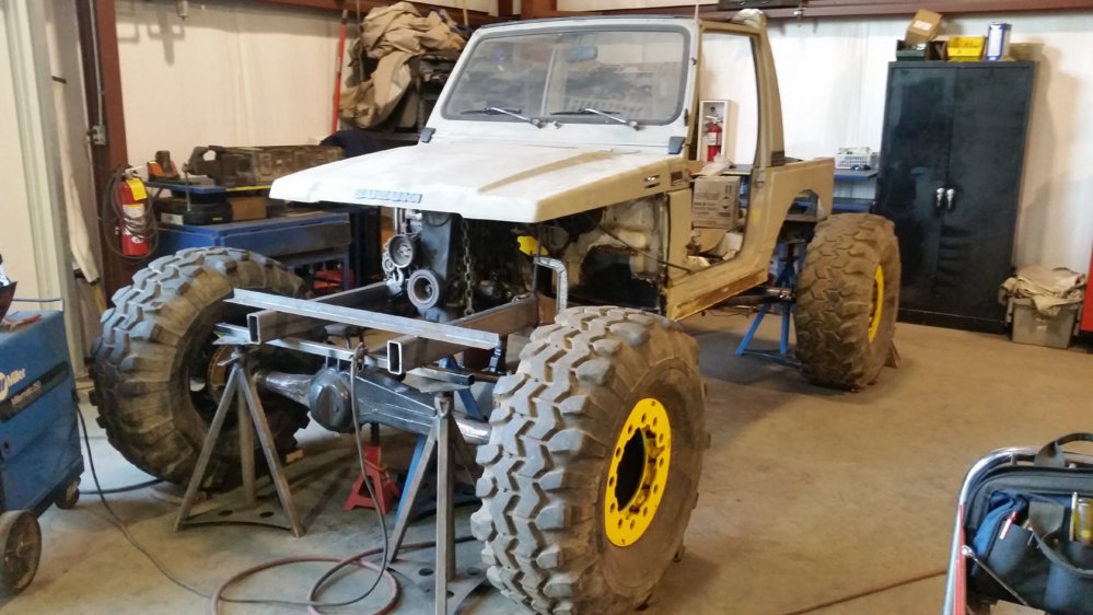

And have a Samurai back in work! This is a full treatment! Body and frame cutting, full exo cage, 3 link front, 4 link rear, with coilovers. 112" WB of FJ80 Axles. 20" belly clearance. Doubler. (no V8...yet!) Rendering of what were after...
Just finishing up the suspension links. About ready start finishing the sheetmetal cutting, and start the cage work!
What size tires are you running on that Sami project?
View attachment 203700 View attachment 203701
View attachment 203698 View attachment 203699

Sami is on 39.9 tires.

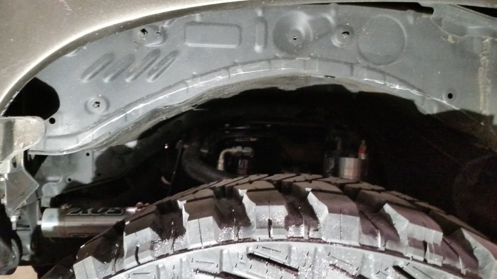

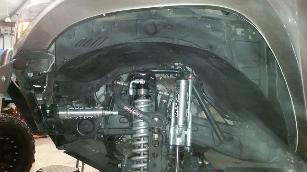

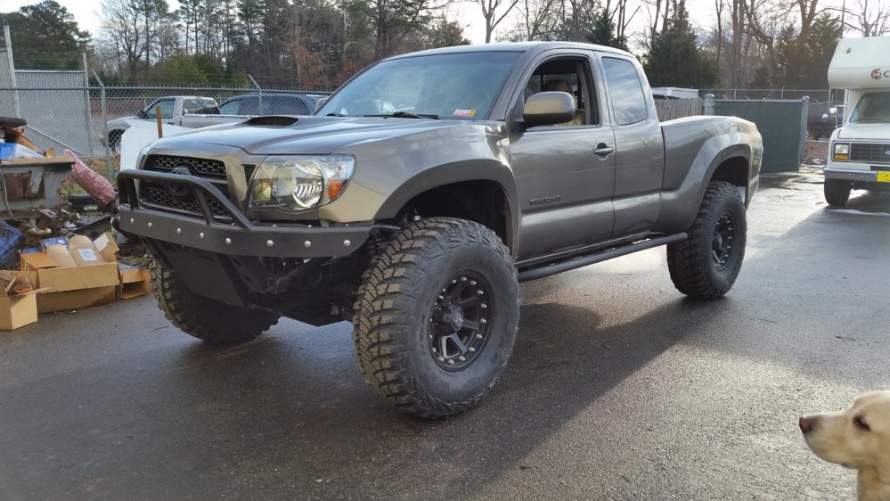

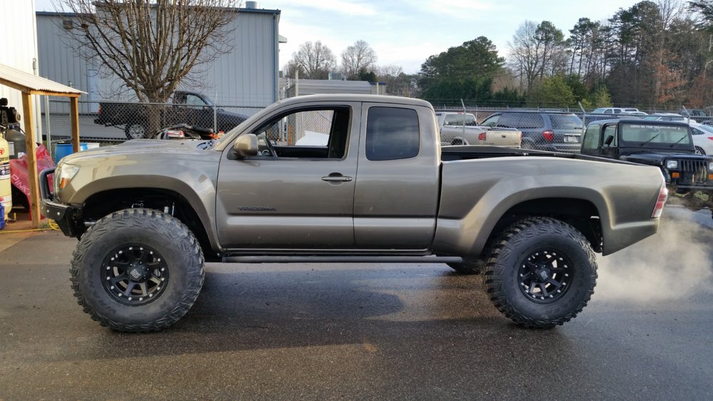

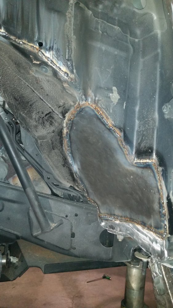

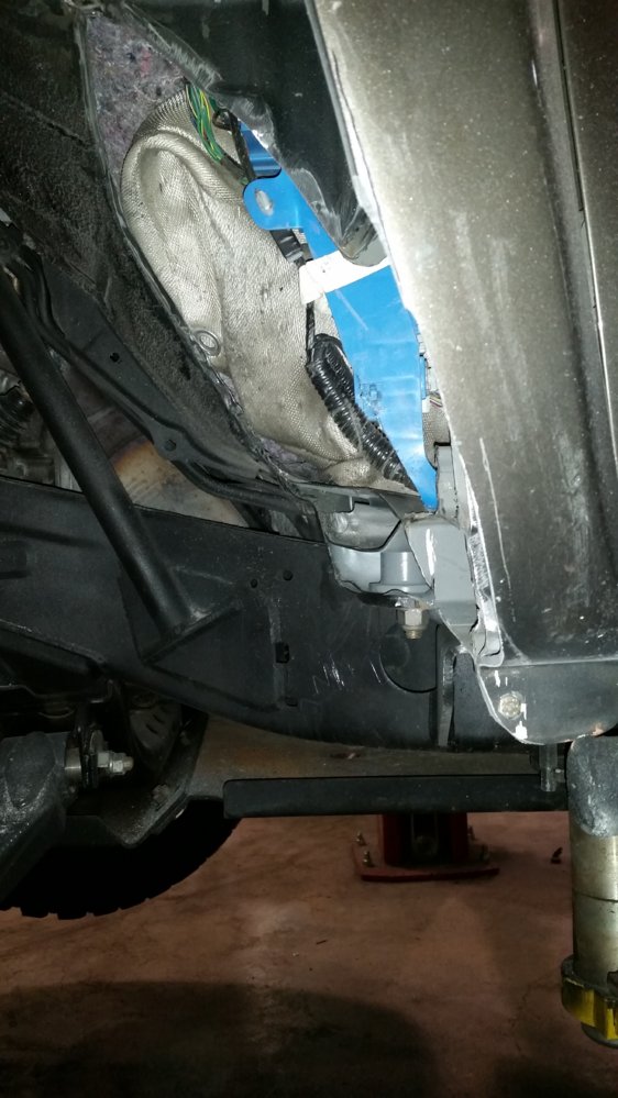

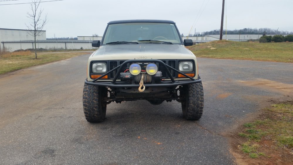

Just finished a trim for 37" tire clearance on this awesome 2011 Tacoma! This Tacoma is all Camburg and Fox equipped in the front end, with pre-runner fenders all around. Tubbed the firewall and trimmed the front and upper wheel well. Took a lot of cutting and moving to get the 37" to clear in full stuff!

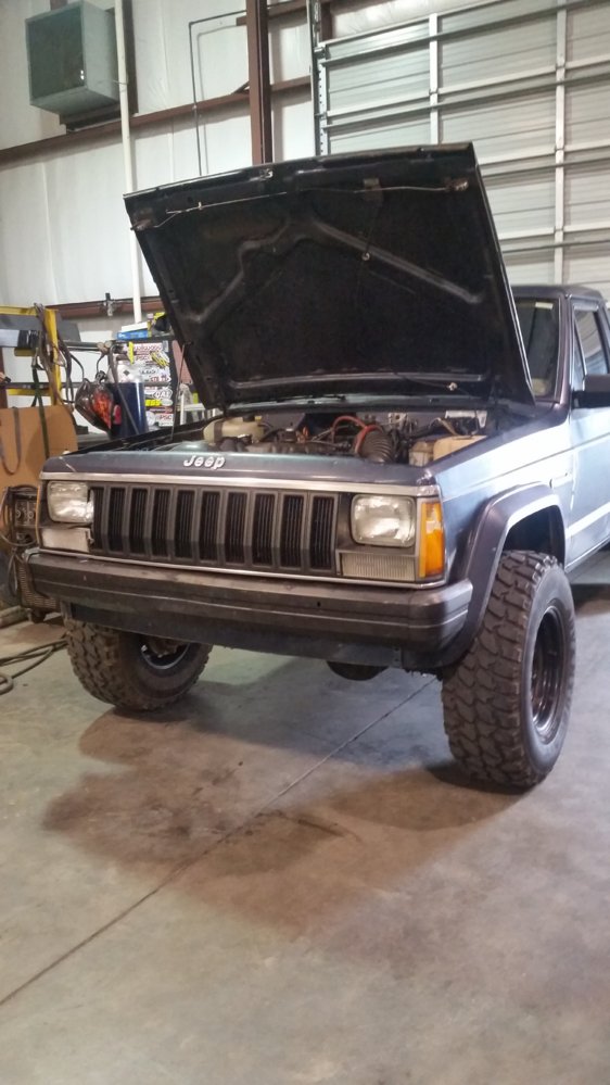

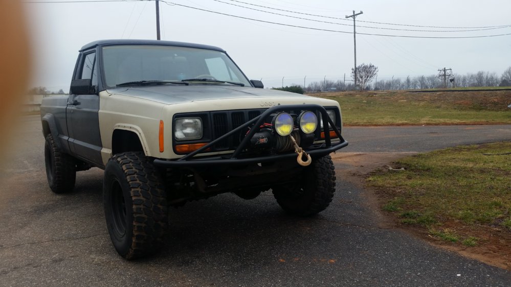

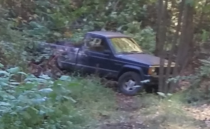

Recently sold my TJ and bought this 88'Comanche for a shop truck. Have started to "unstock" it!
Only picture of the stock pic...
First, Added some lift and some tires. Then had to update the front end!
Last weekend, Got the front bumper built. Winch and some lights!

Any progress on the sami?
This thread needs more Samurai. Lot of nice work done since last posts.
Hellfire fab works holdin up progress. :)

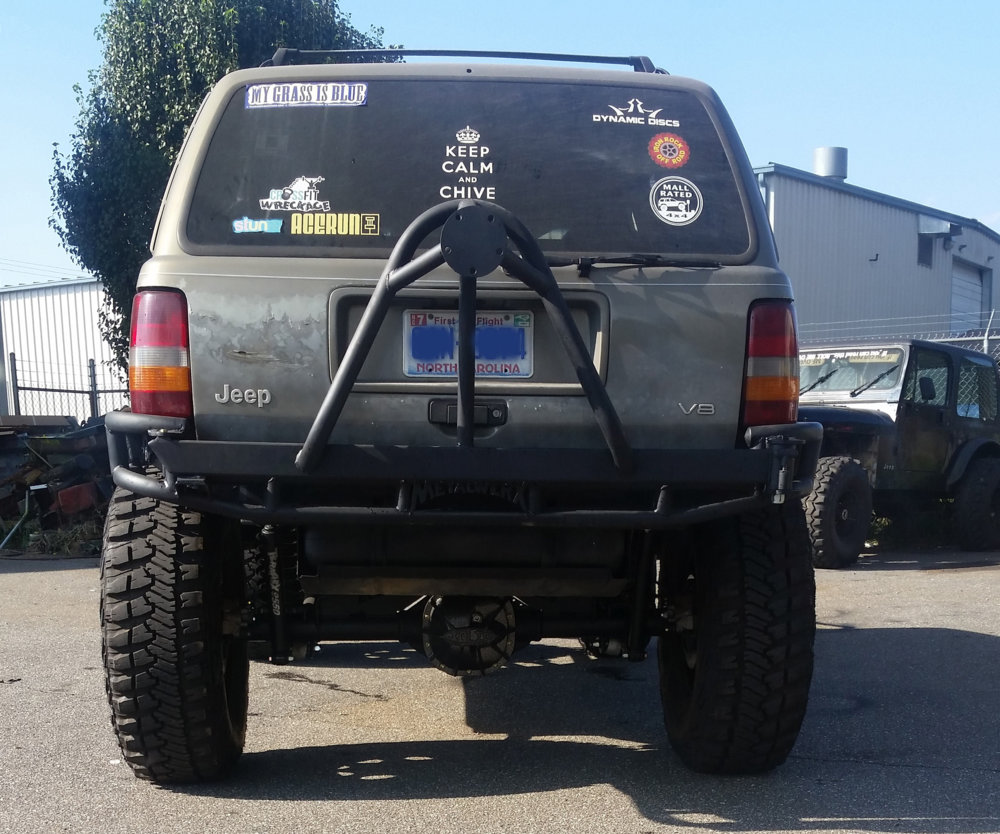

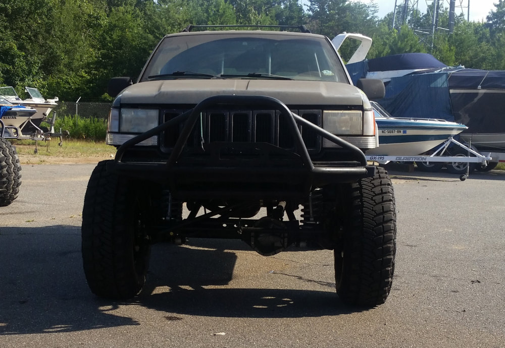

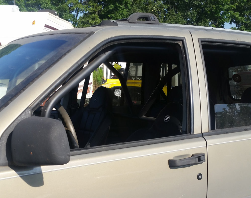

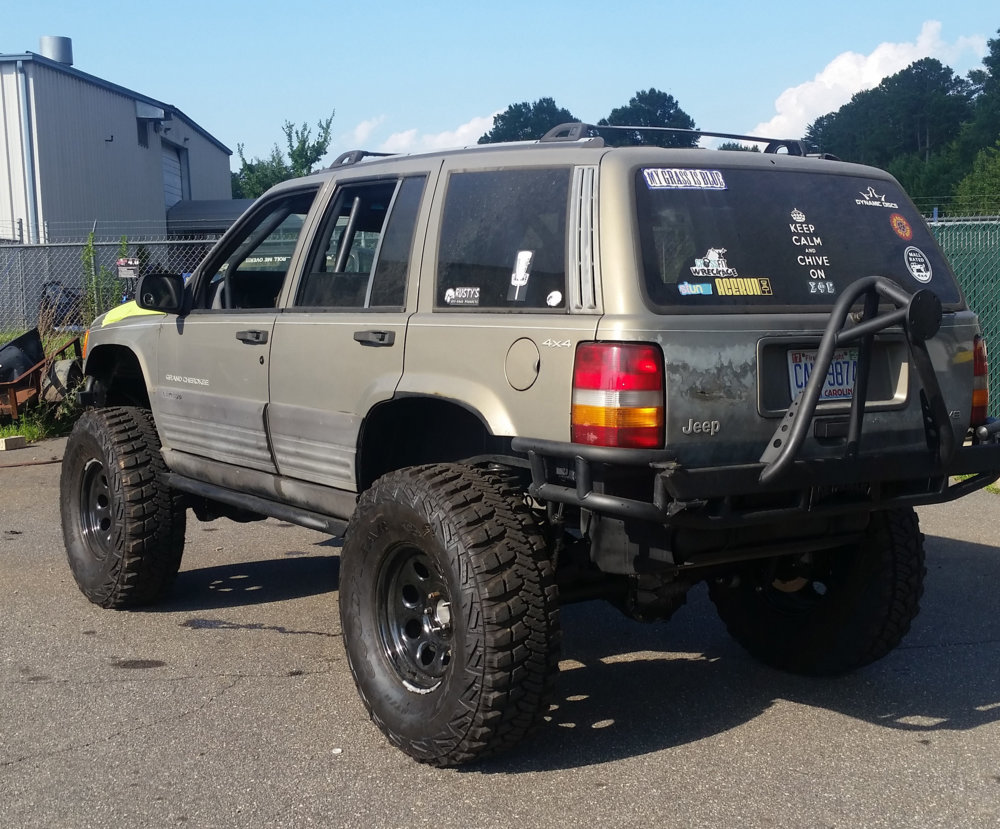

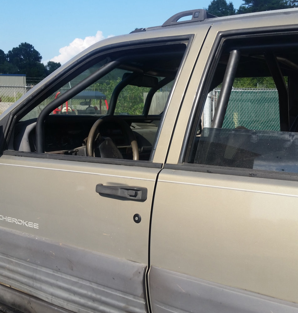

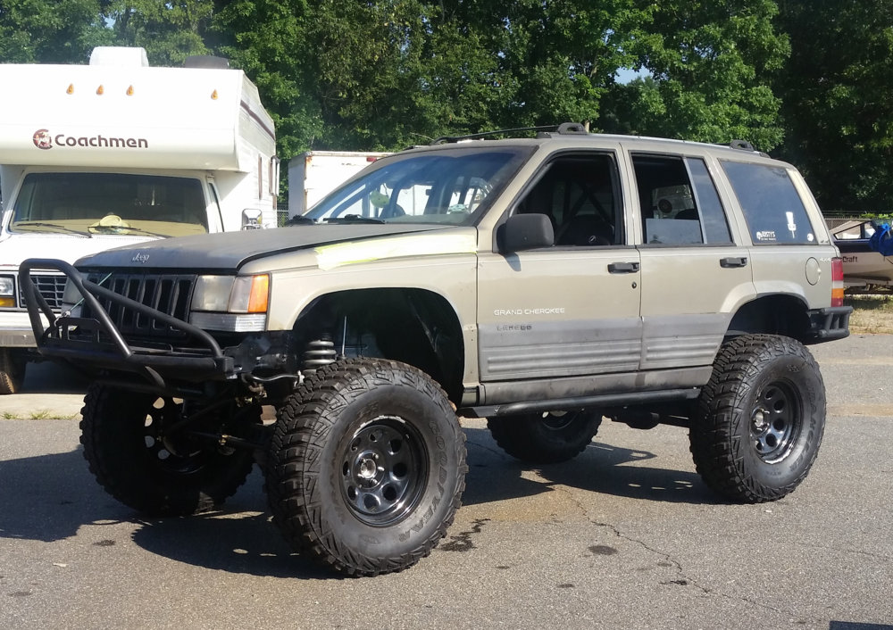

Most recent project finish. 1999 5.2L Grand Cherokee. We built all new axles, Rubicon 44 front and F8.8 rear. All trussed, geared and locker'd in the rear. All alloy shafts. Fabricated Long arm 4 link rear, and long arm 3 link front. Coil springs. DOM cage through out inside, tied to the fabricated sliders and frame stiffeners. Corbeau Baja Seats in the front. Fabbed front and rear bumpers with winch mount and tire carrier. (Lots of wheel well clearancing for the 37" MTRs!) First ride a drive today! Customer picks it up tomorrow!
Some awesome work! Looks like LS swaps are gonna become second nature at your shop.

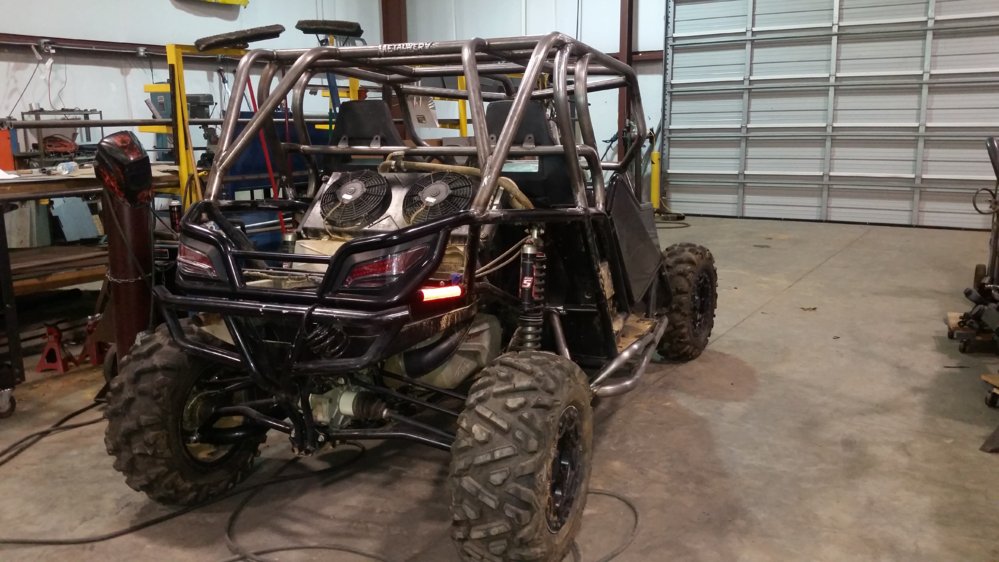

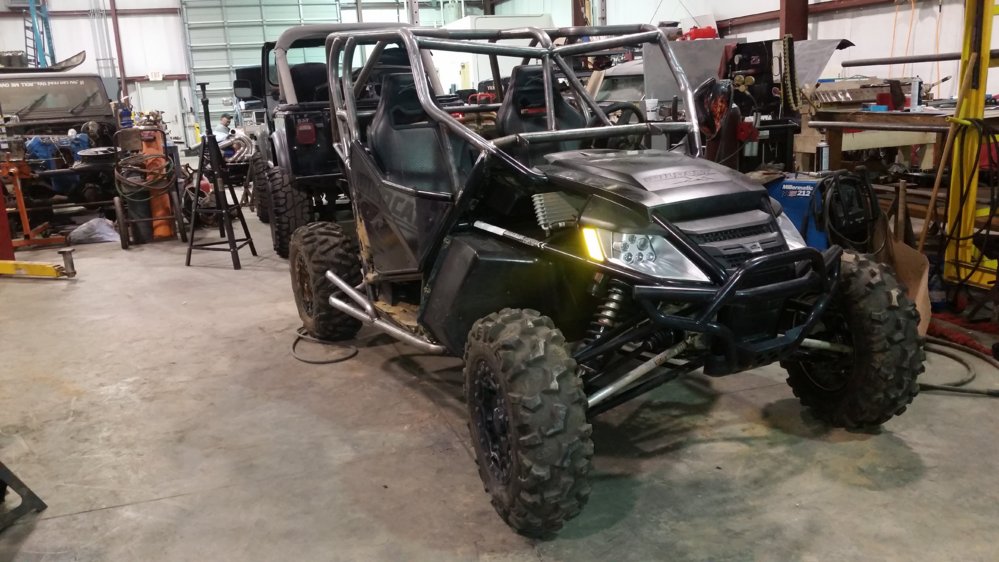

How's that RZR additions going?
