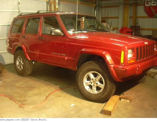

I put a Rough Country 3" on my daughter's XJ. National Tire and Wheel, $239 with shocks. Ride is great as well.
