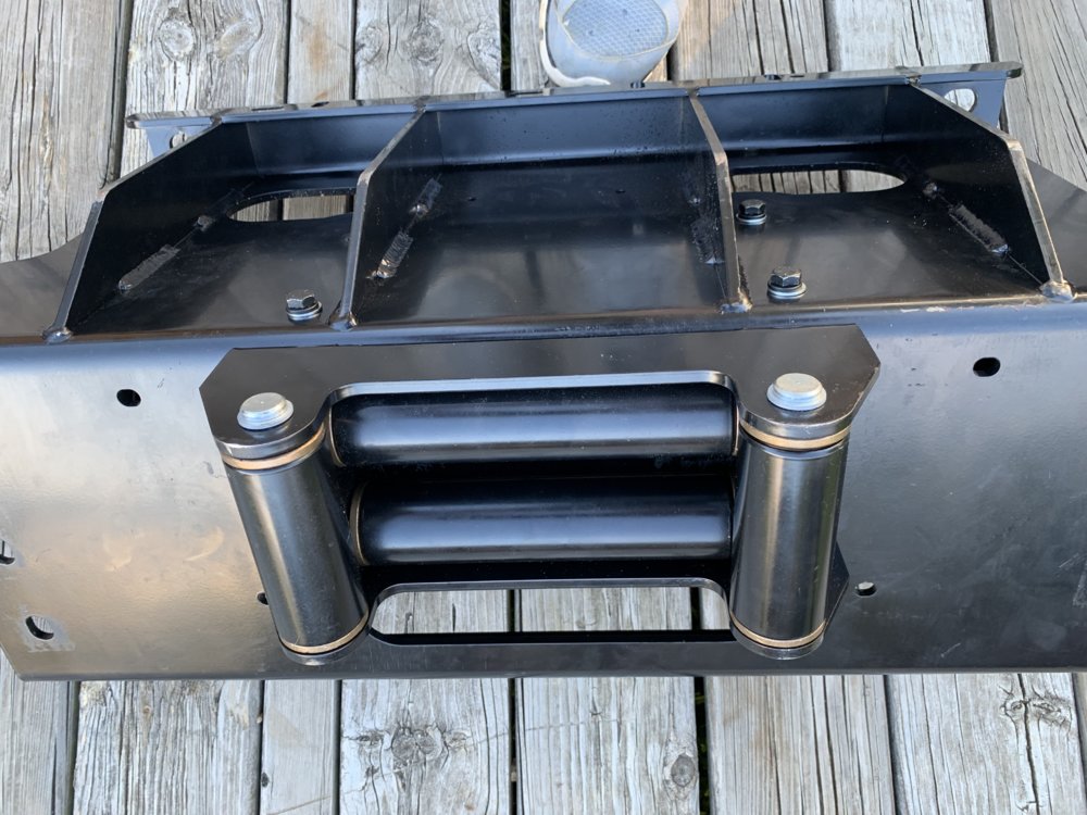

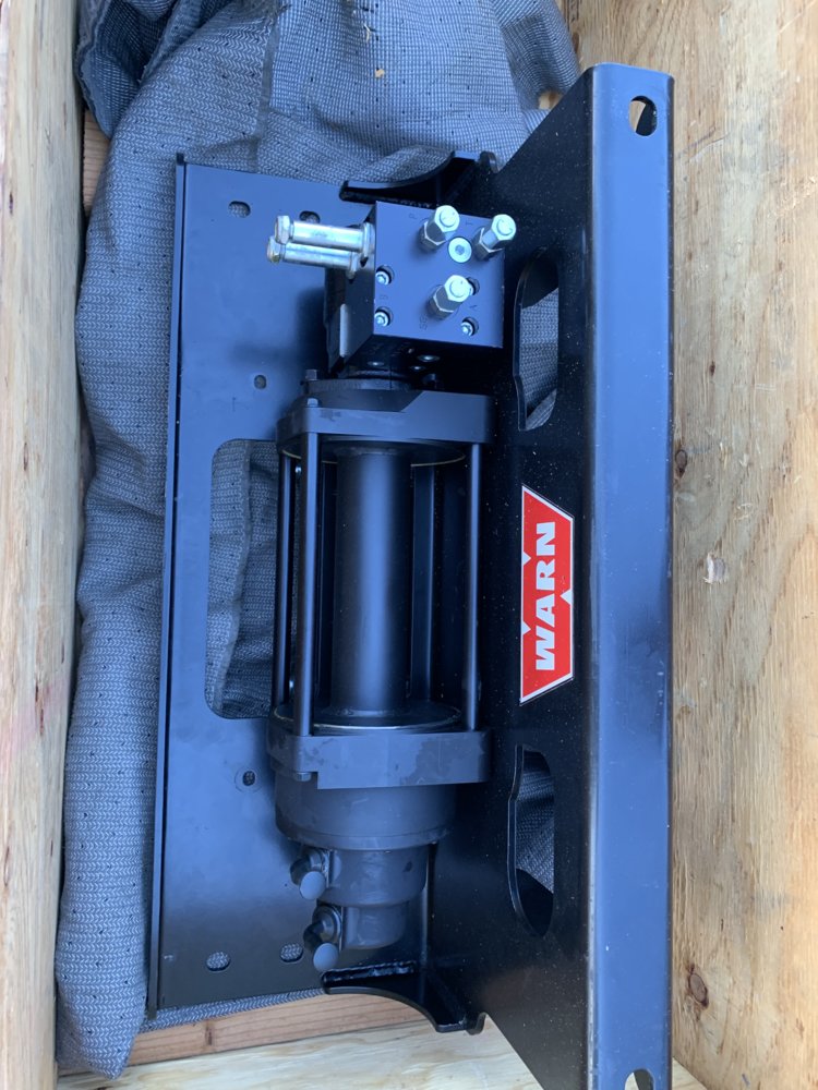

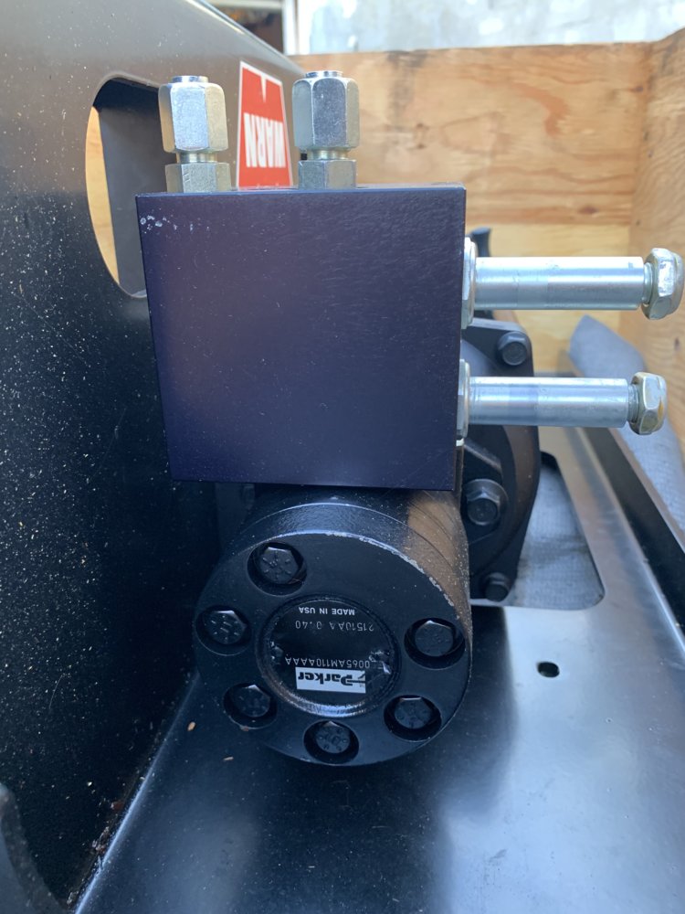

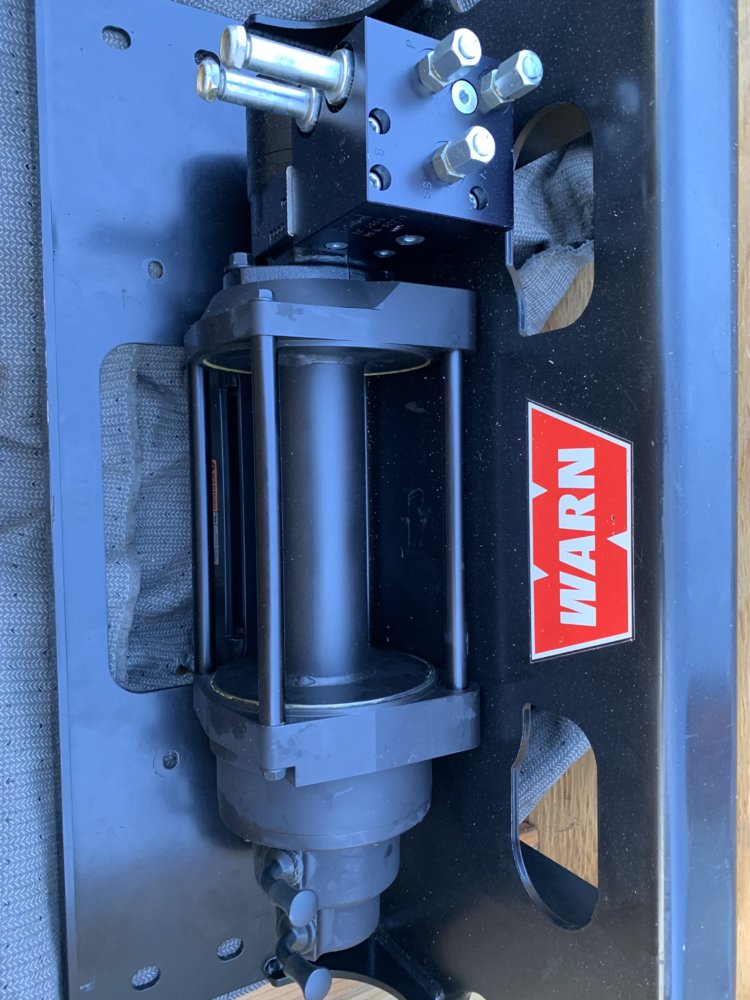

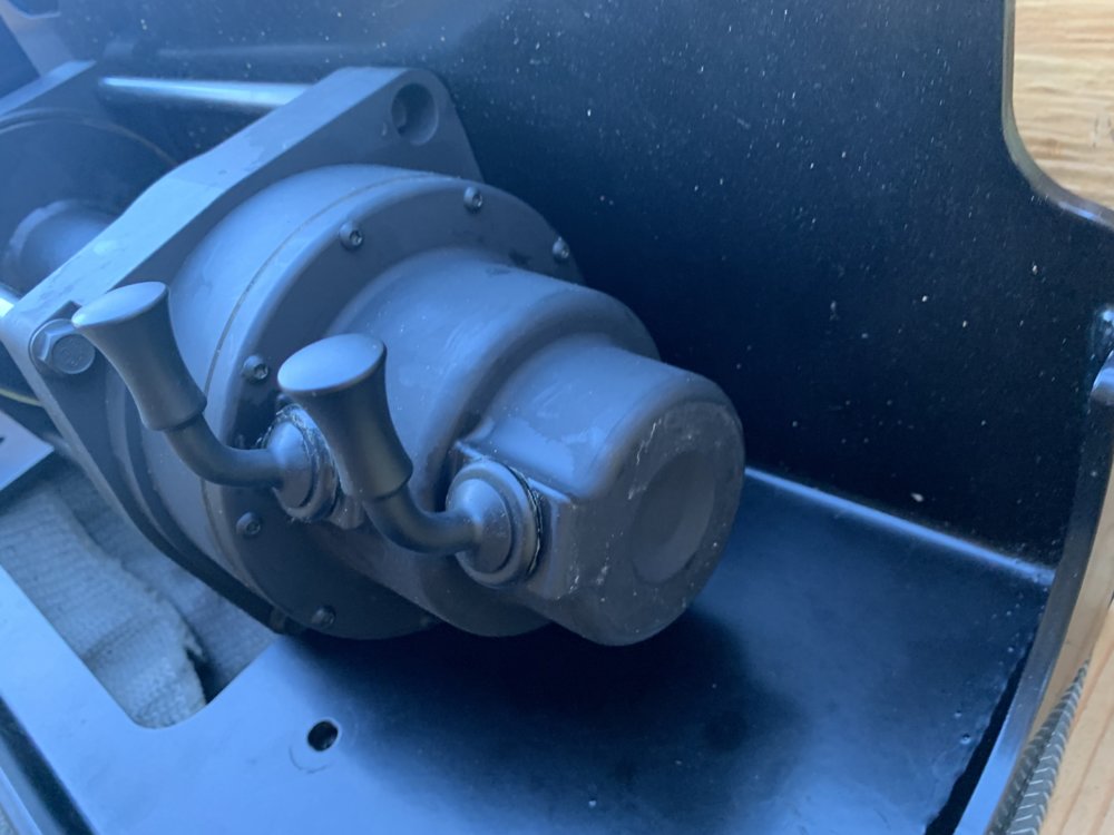

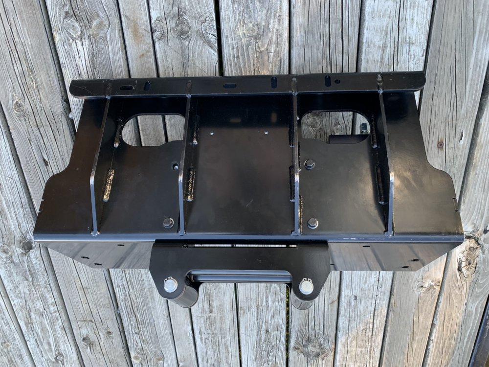

I have this winch and was wandering if anyone knew what model it is? Thanks
