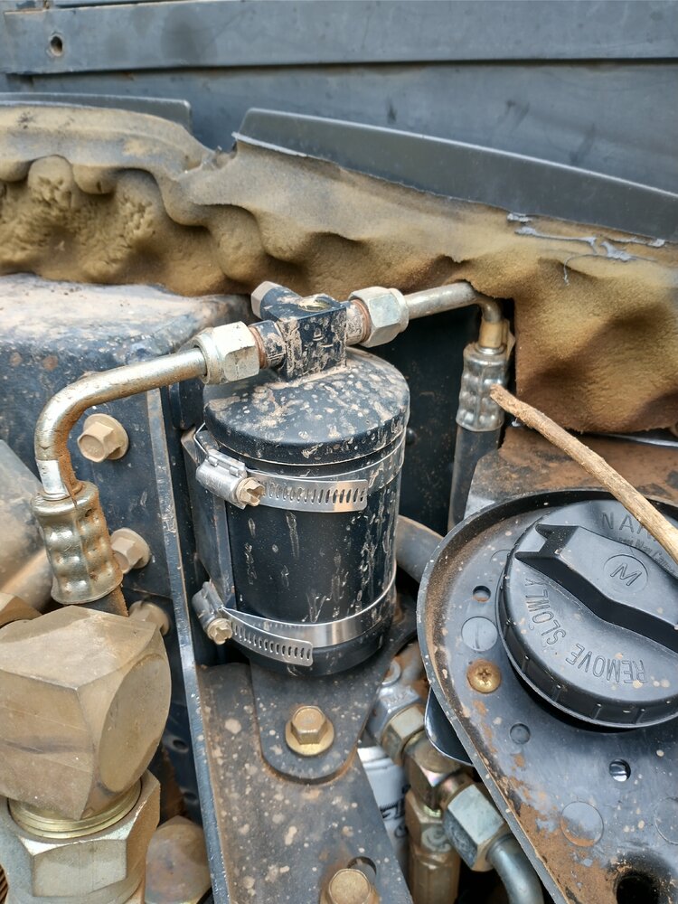

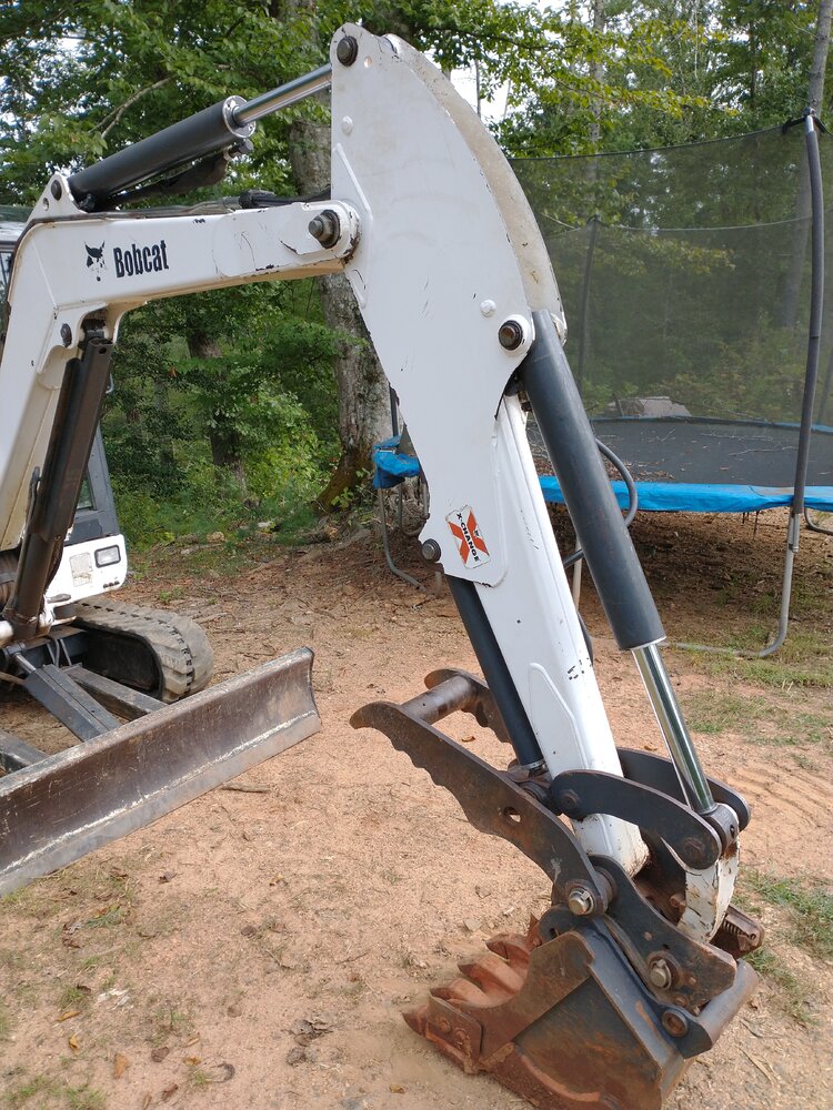

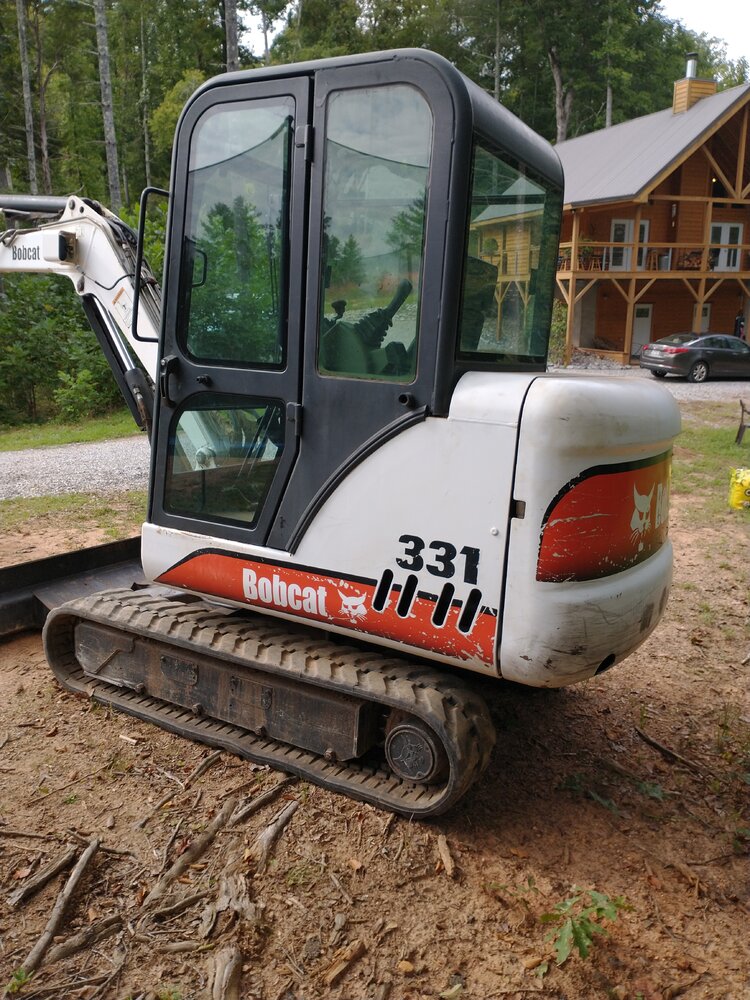

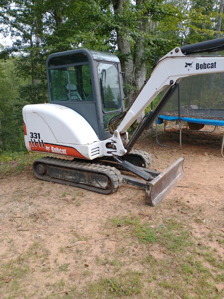

2004 BC 334G and have an AC issue.
When owner painted and added decals they didn't have the #4 so he just put the 1
It is a 334.
When previous owner added some refrigerant a hose blew while standing there. It still blows cold but need to fix the leak. Does system need to be evacuated before installing new hose? Does it depend on which hose....high pressure vs low?
Leak is on line with stick touching it.
Thanks for any

Ok, I figured out the AC.
