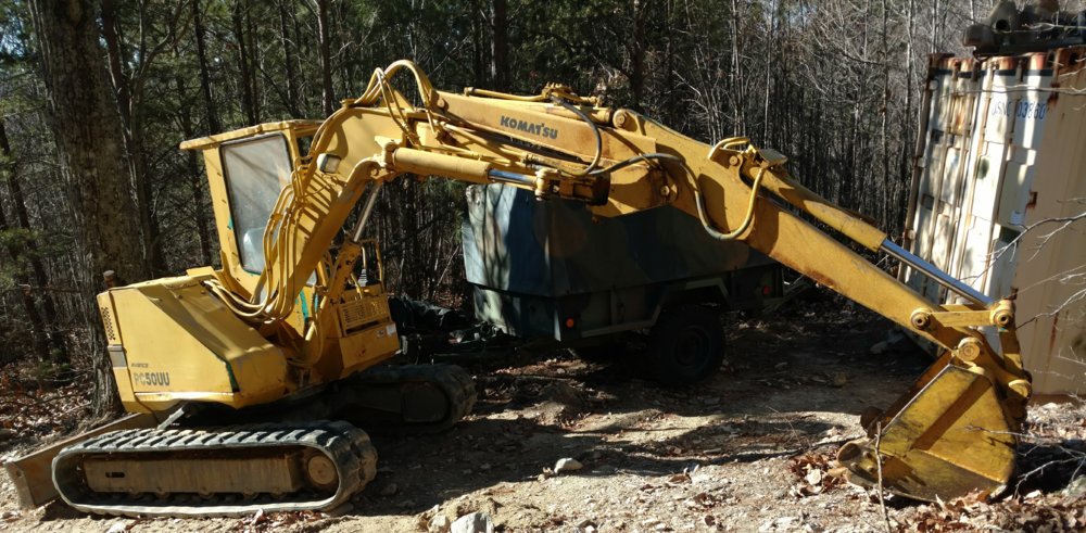

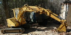

Don't rule out an old machine. I bought this one with about 4k hours, it runs great, has virtually zero electronics, and is strong. Sad thing is I wish I had gotten a bigger one. This one is about 11,500 lbs but doesn't like rocks, and my land has a lot of rocks haha.

I have zero rocks. :)
Let me know if you decide to sell.

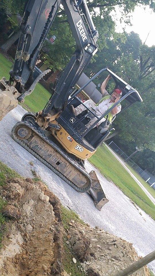

we run 2 John Deeres here at work. A 35 and a 60. The 35 we have had since 2010 and the 60 is 4 years old.The 35 is my go to machine for most service work and have had good service out of both.

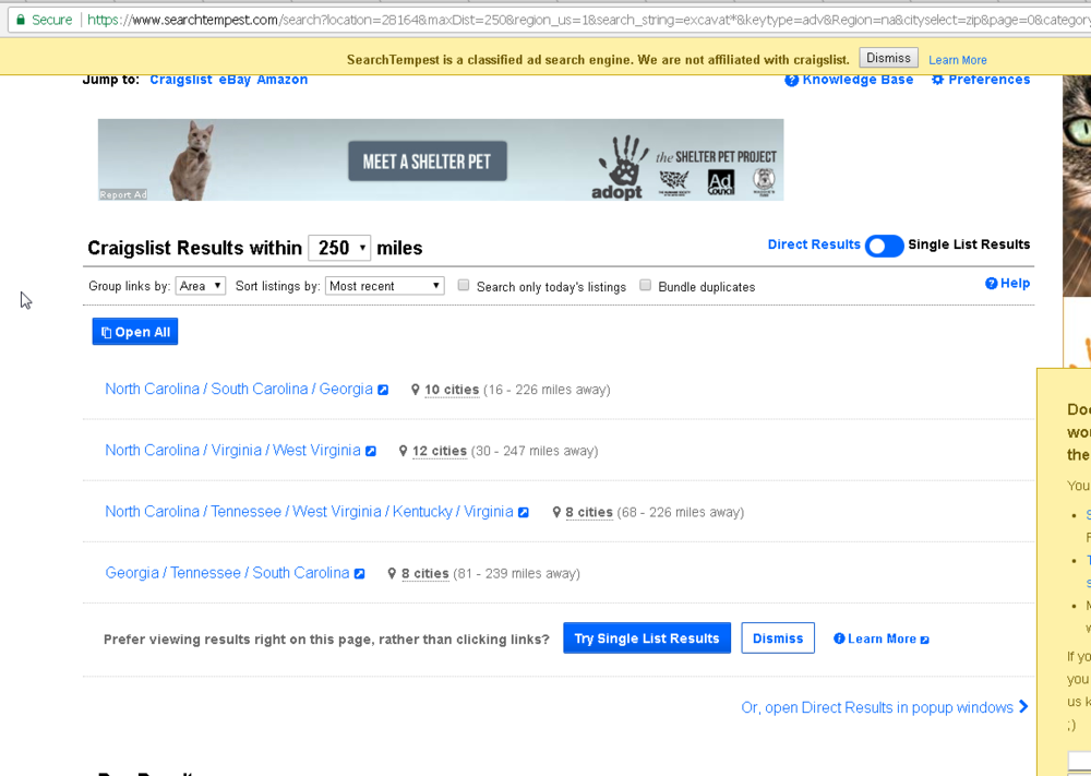

Craigslist is hard to beat. Theres a WNC paper called iwanna.com, and machinerytrader.com, but craigslist was the best source for me. I was searching within a 250 mile or so radius. www.searchtempest.com direct results is great for searching, but the CL alerts are crucial for timing on a deal when you're ready to act.
I've used search tempest a lot, but it always gives you a crap load of expired postings to weed out.
I'v used search tempest a lot, but it always gives you a crap load of expired postings to weed out.
Use direct results. I agree, "regular" searchtempest sucks and gives you expired results. But they made some changes in the past year, and now the direct results are grouped by region, so you can check within a couple hundred miles pretty quickly.
