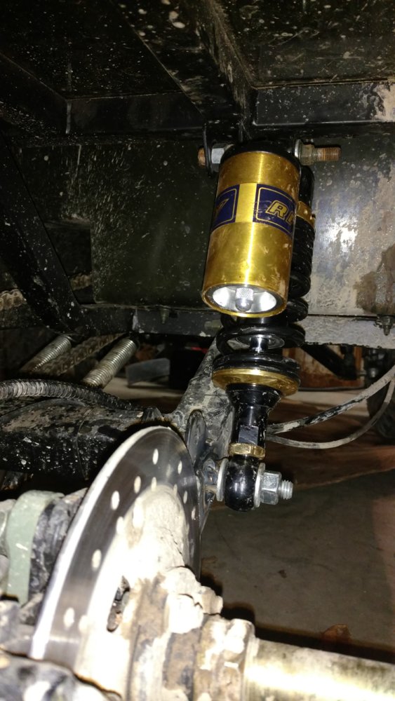

Shocks finally showed up. I thought the fronts would bolt on but they won't, the upper control arm would hit the reservoir. I will have to raise the upper and lower mounting points for the front shocks.

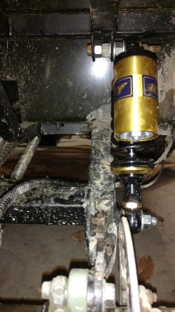

The pictures are of the rear shock installed. I ended up using the factory top point, and welded a bolt on the trailing arm for the bottom. Not sure if the single shear will be too much or not, if so I can drill/sleeve the trailing arm (might do this anyways, I was just trying to confirm it would function. I only have one shock installed on the back currently.
With the factory shocks I could not get the rear to compress more than MAYBE 1/2". Now from full extension to full compression it has 4"-5" of travel.
I have also learned the RFY shocks are not precharged with nitrogen, which is no big deal, but that their fill of oil is also too low, so they really just don't function as they should out of the box...
If anyone ever does this, the reservoir shocks were an easy add-on for the rear with slight modification. They likely added some travel over the factory 8" shocks (assuming the 8" shocks would have moved). The reservoir shocks are a PITA to make fit on the front, but since sending stuff back is a PITA on ebay I made them work. Would have been easier to just buy some 11" non-reservoir shocks. I had to raise the frame mount about 3", which is fine, but I also had to raise the mount on the control arm 3", which looks pretty horrible, but it works. It may get reworked at some point. I still have to do the RF, then fill all the shocks with oil/nitrogen.

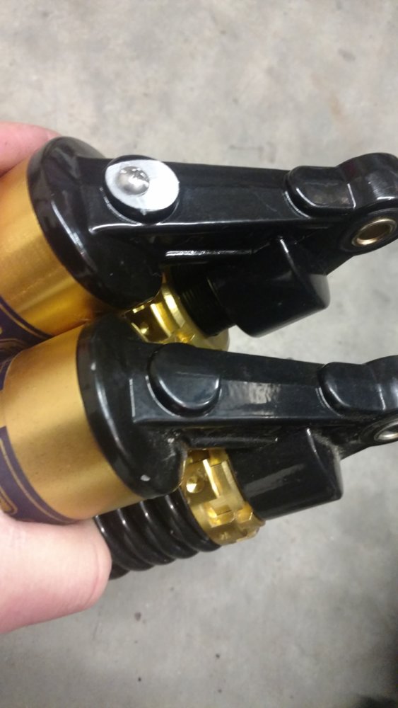

I had read online that the RFY shocks are pretty much always low on oil, so after removing the spring and confirming this I attempted to disassemble one. I could not get the shock shaft out, and was afraid I would mess up the seals if I tried harder, so I just drilled and tapped a hole in the reservoir. With the shock clamped in the vise I can fill it VERY slowly (syringe and a WD-40 spray tube 'gravity drip' system). The first shock I did was MUCH better, no more air in it, or at least if there is any it's not enough to feel. Not sure this will really make a difference, but I figured I might as well do it before they get covered in mud. Removing the bladder from the reservoir is pretty easy so it doesn't take long. Takes way longer to actually fill the shock with oil.
