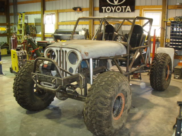

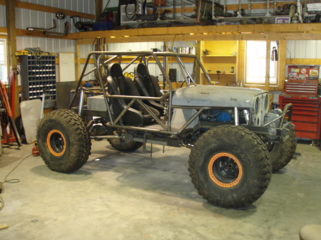

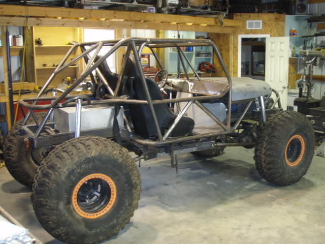

Well...a few people have asked about the progress. Here it is.
Spec.
2F w/ TBI conversion (blueprinted and balanced)
SM420
Dana300 w/4:1 and 32 spline outputs
FJ front axle...longs, APR studs, lock-right, etc...
FJ/mini-truck combo in the rear...welded
14" Rock Equipment Coil-over all the way around (dont have the coils on them yet)
4" SAW airbumps...yea there not on yet either
big fuel cell for the tractor motor
39.5x17 Irocks (not the ones in the pic)
you get the point...get close to done...has to be ready by the last week in OCt. should be fun.
6' at the top of the cage
20" of belly clearance
WB is 104"ish
and for everyone that said i couldn't build a slick buggy with a tractor motor:flipoff2:
And yes...i know the Cruiser Gods are going to strike me down for the Jeep hood...it just fit so nice:shaking:

One thought you got enough /\ on the Air Shocks... The look almost straight up and down...
Just wondering? Maybe just your photos.
Thanks for all the comments...
Target weight...heavy for a buggy...a may weight it when its done
Started with...a lot of scrap tube, motor, tranny, t-case, and thats where it ended up.
Airshocks are fine...when its fully flexed, the go vertical and are going to sneek by the airbump cans...(if all goes as planned of course)

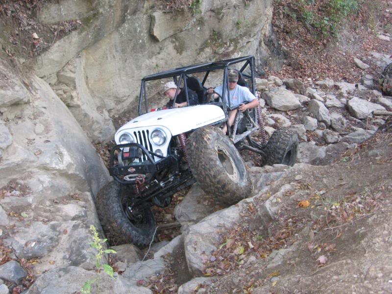

stole these pics from webwheeling.com hope they show up....
buggy did great...had a few small issues with cooling and normal shakedown problems... but not to bad for going from a bare chassie to a wheeling buggy in two weeks flat.

Tony running the trails with cigar smoking the entire time.:smokin:
Buggy looked good guys. Really impressive.:beer:
