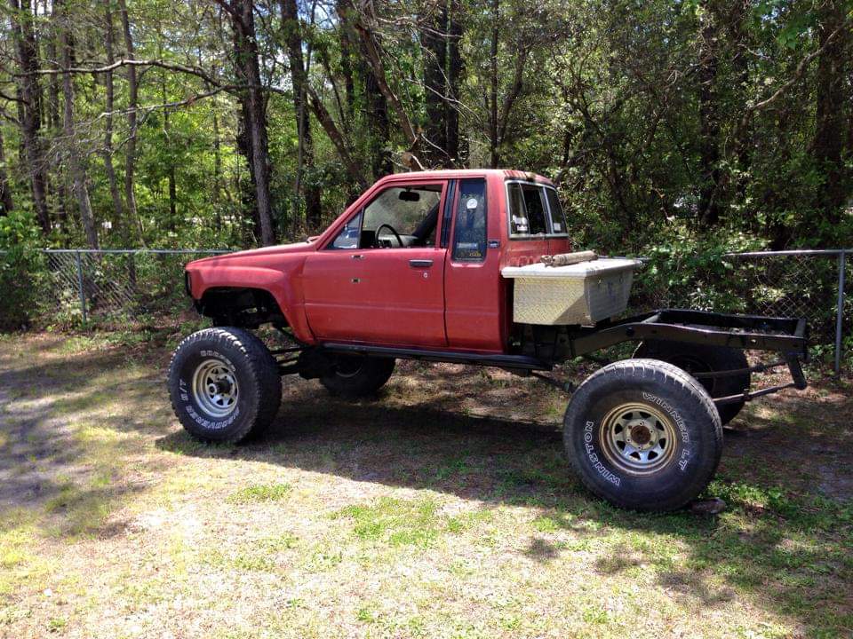

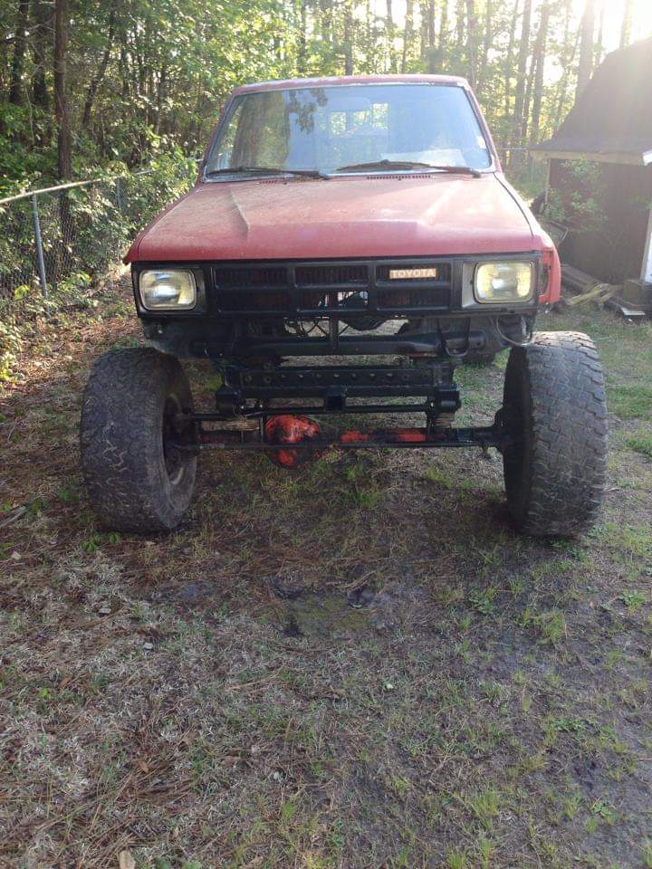

Well to start things off. People will flame this I'm sure. But here goes nothing I have a 1986 toyota xtra cab with sas done and fullwidth chevy axles it has no motor and trans

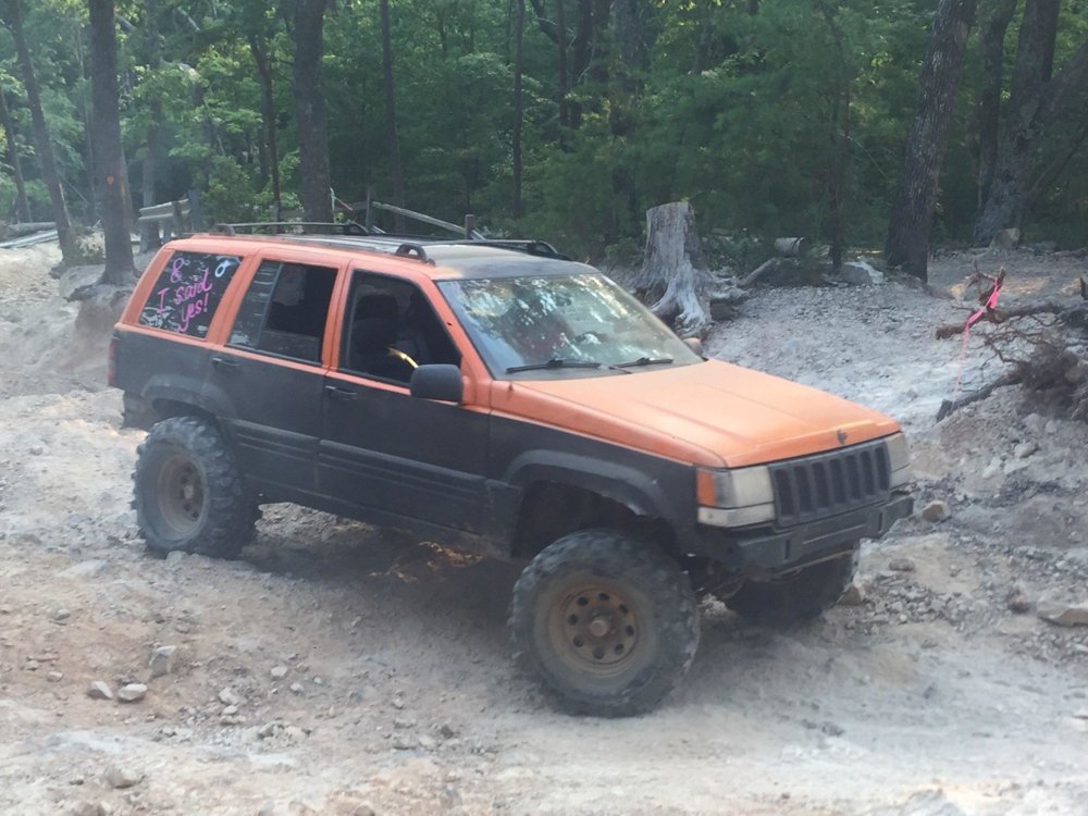

Now that that's done. I also have a good running jeep grand cherokee with no title that runs great.

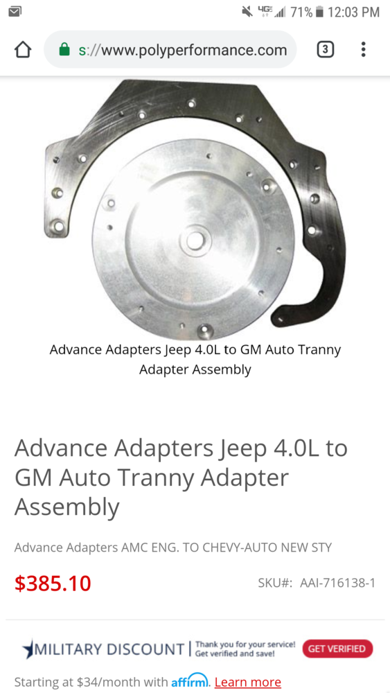

So everyone knows what I'm thinking. Put the 4.0 in the yota with the auto and adapter to run dual yota cases. Has anyone ever measured to see how much has to be cut or moved to fit a 4.0 in a toyota.

The 4.0 is long, so will likely need to run rear rad or stretch the front/ cut out the firewall.

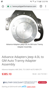

Yeah I figured that the radiator would end up getting moved. What does anyone know about adapting the 42re to a yota case or maybe np241. Yeah i was also thinking the same thing about the 4.0 being a little to much for dual cases. Maybe just a single case would be fine truck will be on 38-39s and probably atleast 488 gears
