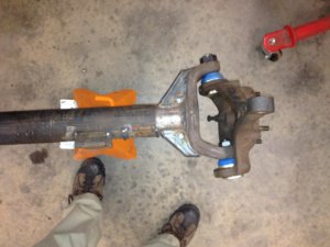

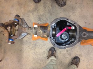

So Friday night, about halfway through the gear change on my front axle, we found out that the new ring gear was drilled for 7/16 bolts and that my carrier and install kit were for 3/8. A call to ECGS monday morning, and new bolts were on the way. I stopped by the shop on my way home from work to drill the carrier holes out, and snapped a couple of photos. Hopefully it will be finished and I can get it installed soon. Is there an app to remove your feet from photos? someone could make a killing with that technology...

Def an interesting build. Have you thought about using a sf 14 Bolt rear instead of the 12 bolt?
It would be too big. I seriously doubt if I ever go over a 36" tire, so I decided I didnt want anything bigger than a dana 44 to get hung on. The isuzu 12-bolt is a 3rd member type axle, not much bigger than a toyota mini-truck axle. The 2 reasons I went with it instead of a mini-truck housing is the factory 4.56 gears and factory disc brakes.

Not much progress here, but I was able to get in the shop and help set-up my ring and pinion. The only experience I have inside one of these is lock-rite installs, and setting the backlash after changing a carrier (installing a tru-trac). Getting the pinion depth was something I had never even thought about doing, and turned out to be just as hard as I imagined it would be. Thank God for set-up bearings. I didnt actually do most of the work, just helped, but I think I learned enough to do it myself the next time. Hopefully within the next couple of weeks I can have all fout tires on the ground for the first time in over 2.5 years. I also have that propane system to install (and a few other secret parts/ideas that I have to keep hidden from my buddies) and then it will be on to the brakes and shocks.
So I got the axle thrown under the jeep yesterday, finger-tight of course, and it came out a lot lower than I had expected (compare it to the stock 'yota parked behind it). But I like it. I am going to re-stack the rear springs to try and level it out some, I also have new spring pads to install that will push the axle back 2 more inches. Up front I am going to have to relocate my shock hoop and find a shorter pitman arm. The tie-rod loads from the top side of the steering arms on this axle and apparently the arms themselves are a little longer than the dana 30 steering. Now my pitman arm is almost against the tie rod, there is definitely not enough room to install a draglink. I will be looking for a blank pitman arm that I can cut to length and drill out myself. Any good leads?
