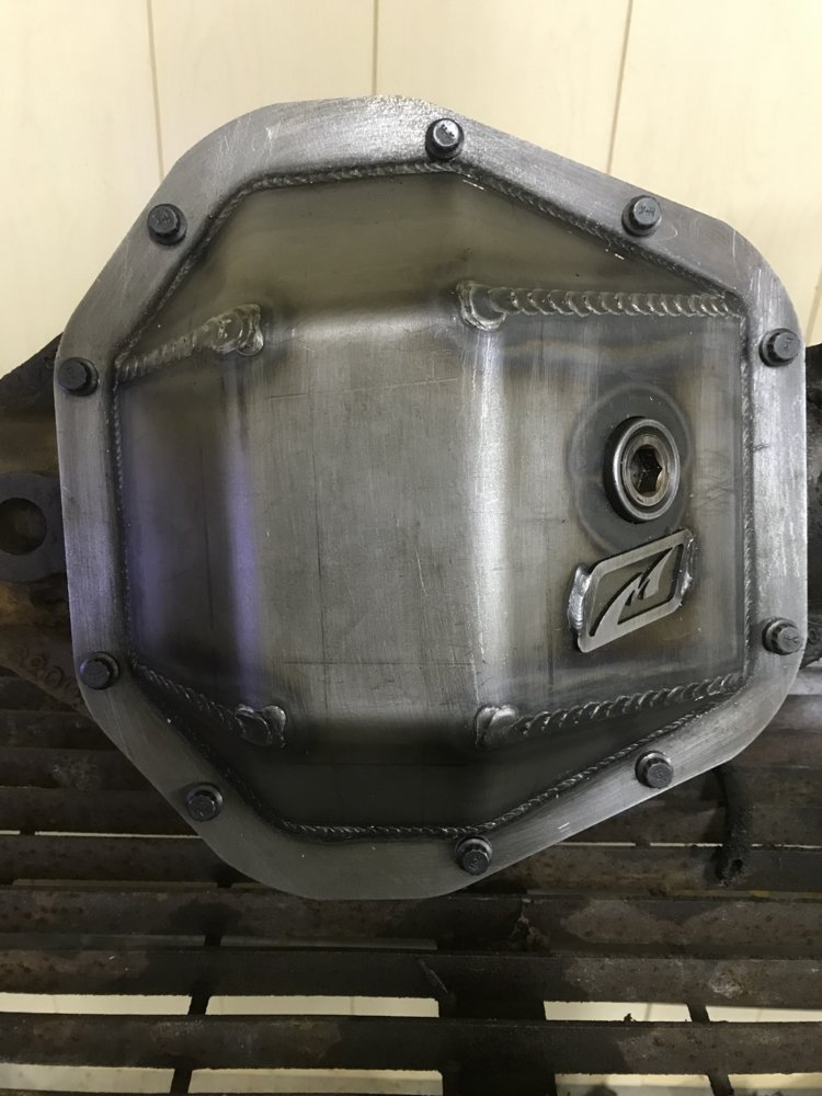

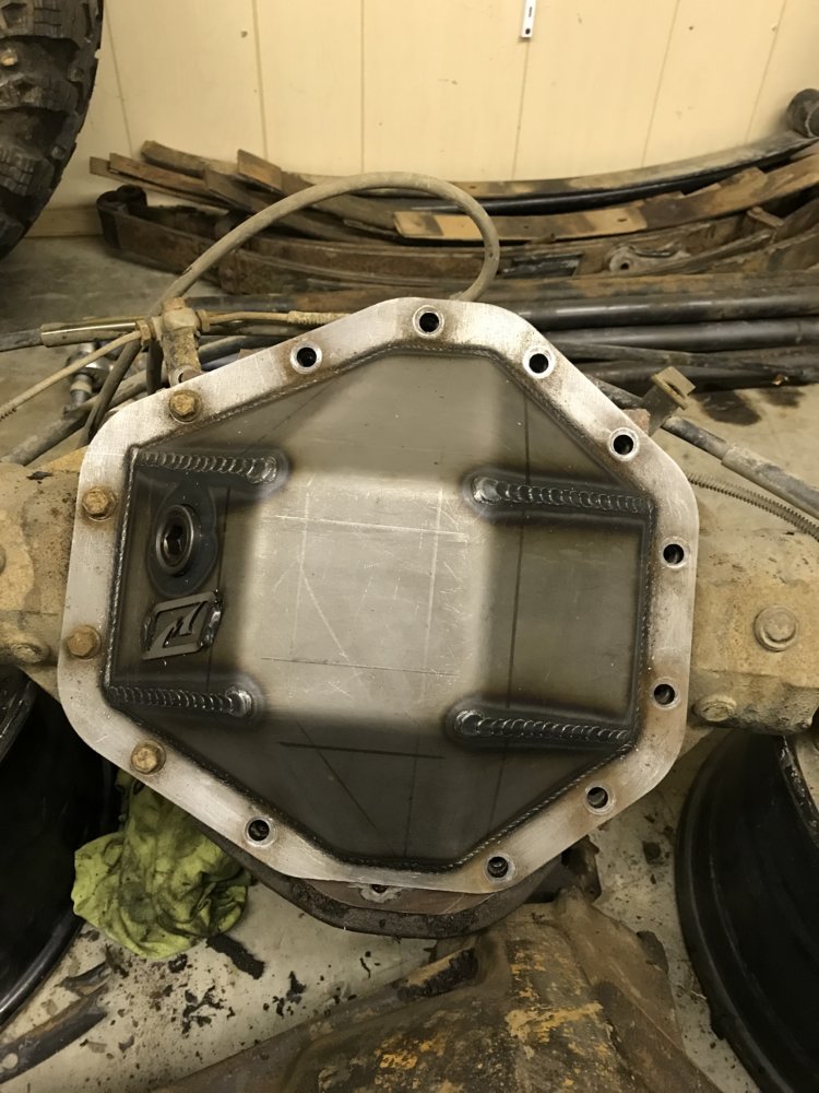

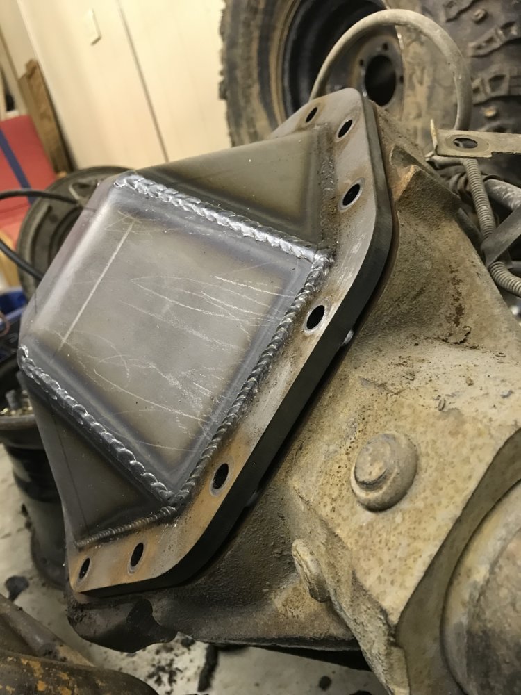

So I got the covers in early this week but I’ve been out of town.
They are both beefy but have a pretty big issue.
They do not machine the surface that mounts to the axle face, so they are pretty warped from the welding.
If I tighten one side of the diff cover down there is about a 1/8th inch gap on the other side... this is on both covers.
The mounting surface is simply not flat.
I’m sure they will work with me on this. I will call them tomorrow.

If they eff you over on this I suggest going to an engine machine shop. They should have a giant belt sander. I took one of mine there after I bought a DIY diff cover from BTF. I welded mine with way too much heat and warped it like yours. Good luck!

I recently purchased your 13 Bolt shave cover and your Dana 60 cover.
They are pretty beefy, but I have an issue with both of them.
They are not flat and are warped due to the heat from welding.
If I put a couple bolts in the right side, the left side raises up about 1/8 inch.
Most companies machine the covers flat, but I didn’t notice any machining on these.
Is this something that can be fixed?
Have you had anyone else with this issue?
What do you think I should do?
Thanks,
David
“Pull the bolts down evenly on both sides and not just one side. Using silicone as a gasket it will seal no problem what so ever”
-motobilt
“Also, just as a reference, I’ve never had one that leaked when you do it this way.”
-motobilt
I tried that and I had to tighten it pretty hard to get it to pull down. They are pretty stout and don’t want to bend much. I am worried that it will strip out the housing.
I don’t think that the diff cover mounting surface should be warped. I’ve never seen a cover like that except for the ones people throw together themselves.

Dude your going to hate your life RTVing that shut. An engine shop can have that flat in half an hour.
It does pull in when you tighten it down all the way around, but you really have to wrench on it to get it down. I’ll probably get it machined if I can get it done cheap. If not, I’ll try to return it and go with Barnes...
Me personally took his response as he didn’t care about the quality of Motobilt’s products. I’d pack that shit back up and demand a full refund.
That’s how I felt too. We’ll see what happens this week.
Just a thought. If you do have these covers machined, might want other side spot faced at holes to keep both sides parallel.
