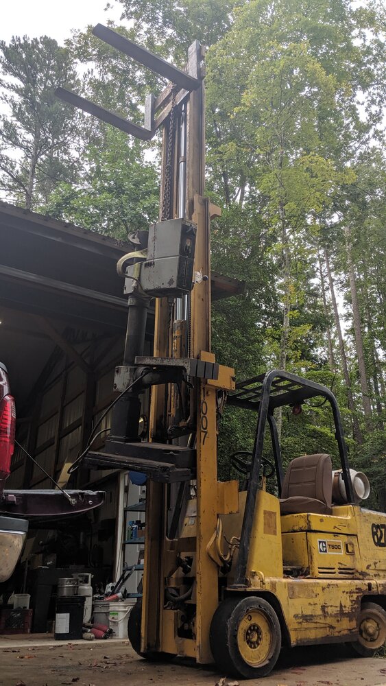

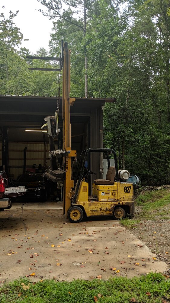

Here’s some pics of a “fun” one that was top heavy, had a narrow base, everything pivoted, and it had to go from laying to standing.
