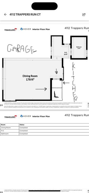

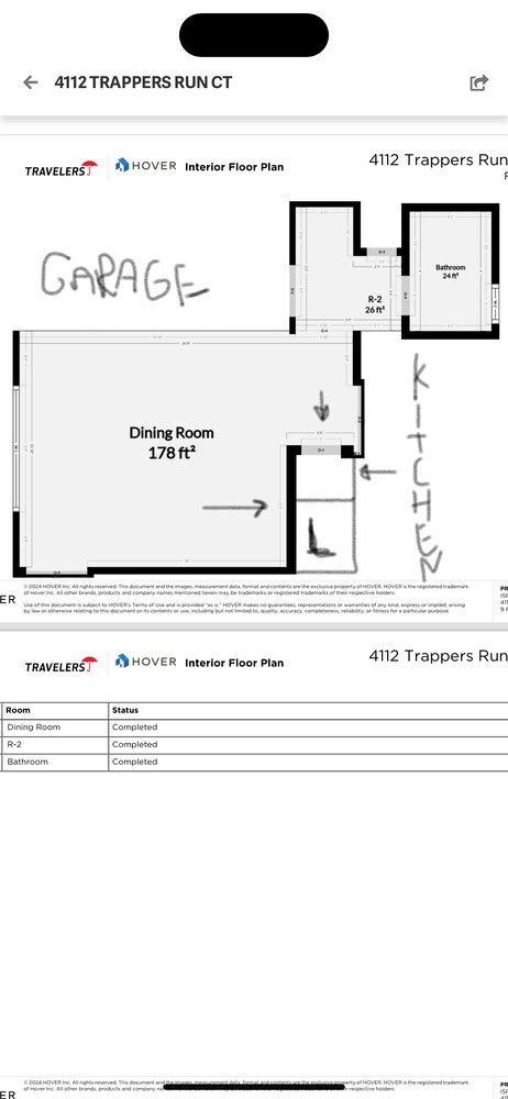

We would like to move our HVAC to a different location than where it is. how hard would it to be moved and where could we move it to? We want to use that current space and do a peninsula so we can have extra seating and allow more light into the dining room.
Attached is our floor plan for that area. The 3 arrows are pointing to where the HVAC currently is. Laundry would still stay, just knock down the walls that currently house the HVAC.
Any idea on the extent of this and how much someone could typically charge to do this?

when you say "move the HVAC" - do you mean relocate the vents that are in the walls so they are in a different wall?
Do you know wheret he main trunks are that supply them? Do they run overhead or underneath? Where is the air handler?
This could range from "just extend a line and drop down into a different spot" to "huge PITA expensive to do properly"
Also you're adding sq footage. Need to ensure your system can handle the load, and the new locations are logical for proper flow etc.
EDIT - Or are you saying the air handler is in that space (white above the "L" )and you want to move the whole handler to somewhere else
Moving the air handler to a different location. then taking that utility room that it current sits in and knock that out to build off the wall that hold the washer/dryer and build a peninsula.
Budget $15k, and hope scope creep doesn't set in
