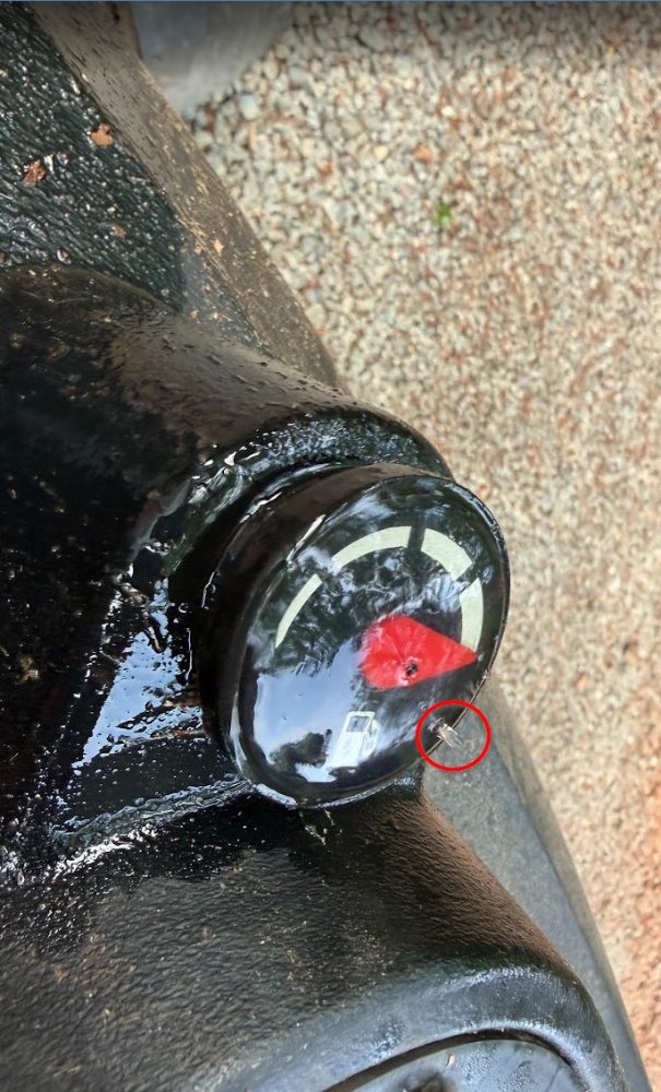

I just left a review on Amazon for the fuel gauges I bought a couple months ago, titled it "Squirty weephole" because if the tank is full, fuel squirts out the weepholes and covers the tanks.
Which should eliminate any venting issues from the gas caps. But maybe when there is vacuum, it gets sucked down and doesn't vent. Also, it has 2 tanks and does it on either tank, so I don't think that's the issue, but I'll definitely check that out.
