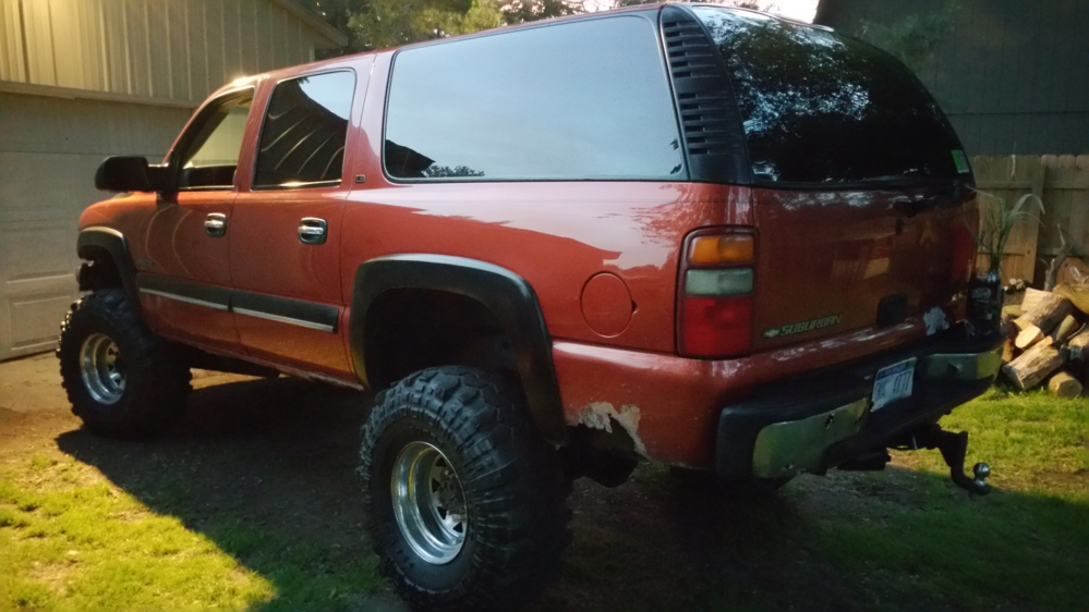

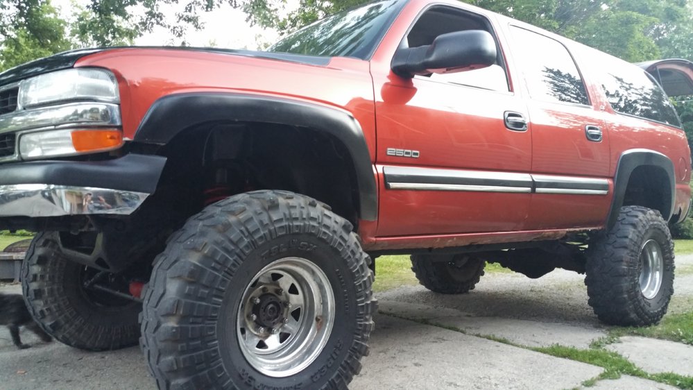

It has 14 inch lift coilovers front on dana44. Rear is 4 link coil springs. And 38.5 boggers. More pics if any likes!

Very nice, you dont' see many SAS newer burbs :rockon:
I just did my 99 Silverado. I love this body style and they look amazing on a solid axle! I used a 79 Ford Dana 60 and an AAM 11.5 from a 2500HD.
Thanks! I have owned this suburban for over 4 years, i put a 3" lift on it few years back. It still looked like a moms ride and had to change that. Plans was for 10"lift but ended up 14. Im taking it out this weekend to see how it does and will post more pics
I used a leaf spring setup and kept it low enough to stay on 35s. If I wanted, I think 37s would clear no problem, however I'm running 4.10s and the 4.8 doesn't want much more. The 5the speed helps though! I just wanted decent capability, good solid parts and reliability...well, more than I could get from the IFS anyway. Technically, I've got 8" on the front, but I'm not entirely sure. I'd love to see how flexible it is with a coil spring setup.

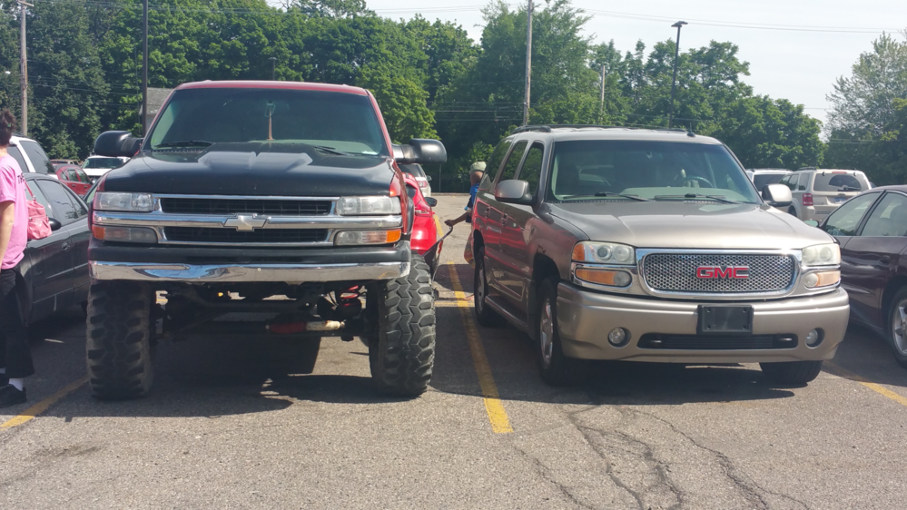

This is my 2000 Ls 1500 I did a sas and coil sprung it's at about 10" but going a little higher. Yours looks good.. and yes I broke my lockout off lol!

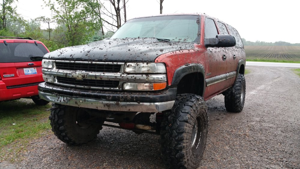

I have a Dana 44 HD front 410 gears and a 14 bold out of a 2005 2500hd in the rear running 38.5 super swampers
