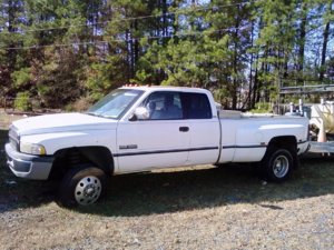

Picked this up a while back, have been steady at it getting it ready to do some work.
Figured I'd start my own thread instead of hijacking the "See Your Dodge thread"
It was pretty neglected and sitting on two flat tires, but I got it VERY cheap.
So neglected the tires were std load car tires. They felt like they were made of Jello
Specs:
1997 Dodge Ram 3500 4wheel drive extended cab long bed dually
12v Cummins NV4500H.D. 5spd NP2(?) tcase Dana 60 4.10s open Dana 80 4.10's Power-Loc(works good)
202k
All power/leather etc.
Installed nice AM/FM/CD/MP3 Pioneer deck...speakers soon..busted out Beastie Boys Pauls Boutique the other day and realized quickly it needS speakers.
Dash cover from Ebay to cover cracked dash
New carpet will be here today--putting extra sound deadening matl under it.
Probably get Tim (Firetoy) to recover the cracked leatHer seats at some point.
Trans needs 3rd gear syncro..hence cheap purchase price..I have learned to double clutch/float it so its not at the top of the list right now.
Has a supposed HD clutch that holds well, but will not hold all I can throw at it right now, to be replaced with a 13" South Bend when I get to the trans rebuild.
The 12v Cummins runs fantastic..especailly with some diesel additive..never had a truck that made as much difference on additives.
The KDP looks to have a criminal record...the timing case has been JB welded togther on the top, but looks to be holding up fine...I may repair/replace case cover at some point.
Installed BHAF--Big honkin Air Filter...NAPA PN 2790. Works awesome
Removed silencer ring from turbo
Exhaust straight piped--needs completed
Fuel Plate/boost adjuster.
Replaced fuel filter WIF sensor
Lots more....
Gages in the mail to be here tomorrow, etc.

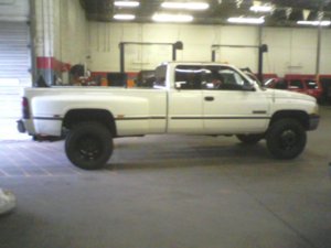

Picked up some 19.5s from Sam, and had brand new 245/70/19.5 Bridestones waiting to go on them.
Did some tradin with him for the wheels and traded an old ARB bumper for the tires. :)
Got them installed Sat. Thanks 4wp!
Really helped the hwy speed. With the stock tires and 4.10's it would top out at like 78 MPH.
Yesterday, WIll(Brokeass4runner) and Another friend came over, we installed New brakes. All of it.... Pads, calipers, rotors, shoes, wheel cylinders, hardware, adjusters, parking brake parts, drums, etc.
Brake pedal firm as they get, but still need to install the drums before I can test drive, they were eaten up from rear hardware falling into them, picking them up at lunch today.
Truck already had a B&W style turnover ball hitch in the bed. 12v winch power plugs wired to the bed with a on/off switch. had 7 pin in the bed for the gooseneck too.
More later....
