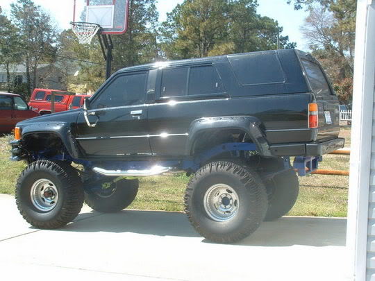

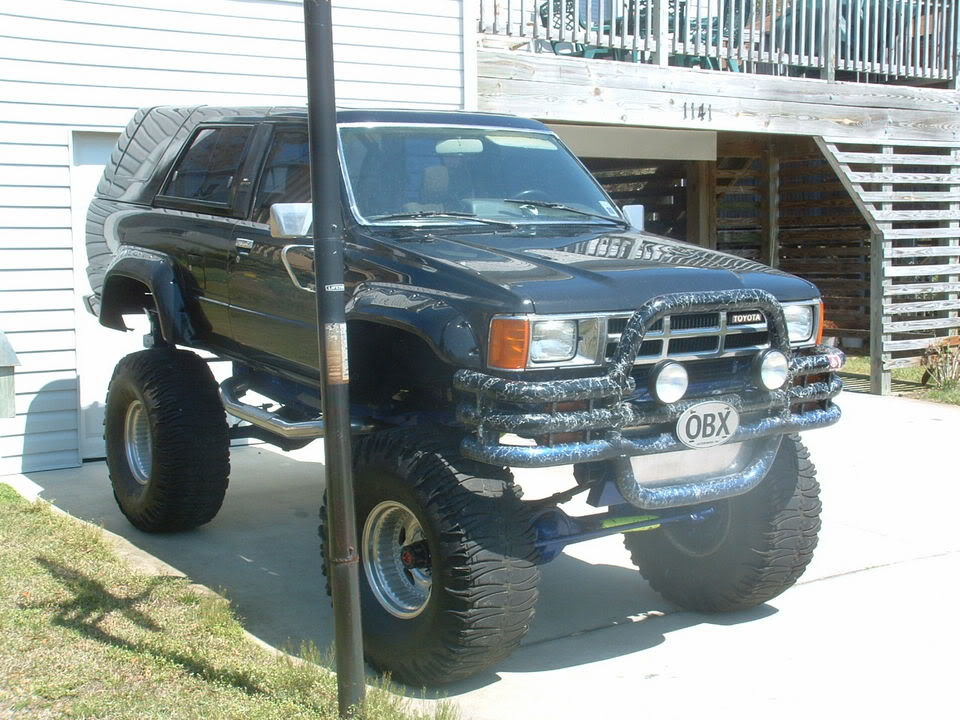

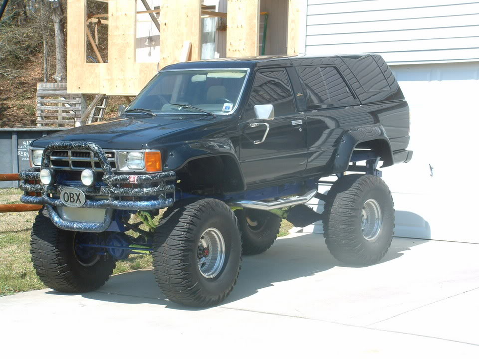

Custom suspension lift (leafs, blocks, and Rancho shocks), 3" body lift, custom paint, custom front bumper/paint, 14 speaker stereo system (Blaupunkt), alarm, factory sunroof, custom coated underbody and frame, 39.5/15R16 Interco STS tires, Weld rims, rebuilt, bored out engine, custom (I can't remember the name off hand, I'll find out) transmission, 5.29 gears front and back, centerforce clutch, Downey headers, rear disc brakes, etc. I'll add more when I think of it.
Just keep in mind, this will be completely different once I get started on it. Gone will be both bumpers, the rear blocks, the chrome nerf bars, the flourescent yellow/blue accents, and maybe the BL...

Looks like you have a lot of work to do Shaun. But not as much as the 89. It definately has a LOT of potential. Paint (as in the frame) and bumpers can be changed easily, and since it was a show truck you know it hasn't been beaten on. What are youre eventual plans for it?
I'm really not sure what I'm going to do with it in regards to the suspension and such. The reason being where I live....I have no rocks close, all sand and some mud...and everyone out here builds their rigs up like this....aside from the ugly paint on the bumpers and underneath. I know I want onboard air and a winch for the beach... I know I want rid of the ugly chrome nerf bars...I'm NOT a chrome guy. I'll get rid of the chrome rims and go all black...plus I want some more backspacing so they sit out some and give me a wider stance since it sits so high. I'm not sure about the blocks and the BL lift yet though...that honestly is yet to be determined for sure...

one thing i noticed is that it looks to still have the stock push/pull type steering, might want to invest in an IFS steering box and a crossover steering setup. The stock steering setup is scary at best when lifted
Yeah, I've gotten that suggestion from numerous people. It is somewhat weird driving it like that. I'm looking in to a MarlinCrawler set up in the near future.
