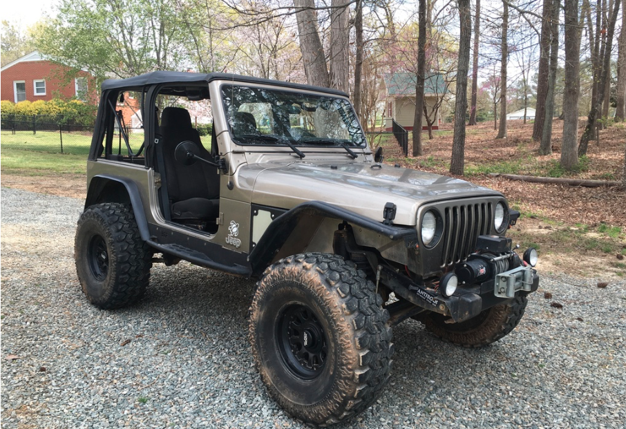

Are those rear fenders stockers that you trimmed?
Yep stock rear fenders that I cut with a jigsaw. Turned out pretty good. I built a piece of wood to hold the skill saw the same distance from the body of the jeep (for most of the cuts)

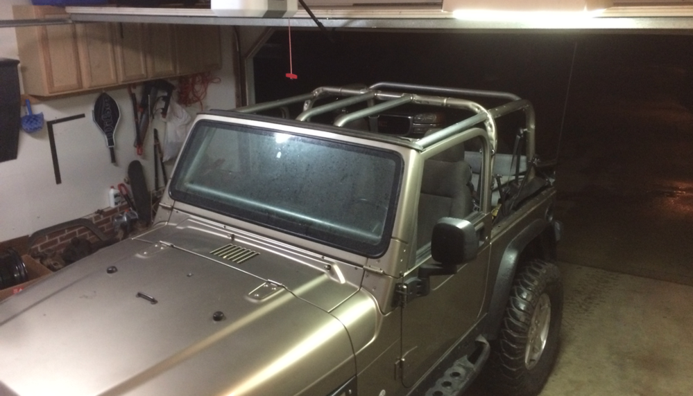

Thank you for validating that I'm not the only one that removes my wiper arms for pictures. They're so long and black... I ain't gay like that.
Haha, that pic was actually right after I got it back from rockmafia for the cage. Had to take them off for him to do the cage and fold down the windshield.
