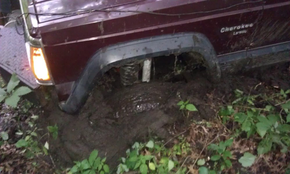

A couple years ago i picked up an 88 XJ. I always wanted to build one but never thought I would take it this far... I bought it with a 4.5" lift ant an aussie locker in the front. The first mod I made was a Warn8274 a poor mans bumper and some heavy ass 34" ltbs.View attachment 64213
This picture was taken the day before I decided that I wasnt goin wheelin EVER again until i built it right.
I not going to bore you with the long story about how when I hit the first mud hole, there was so much water it crushed the air filter and hydro locked the motor... got it goin again and broke an inner and outer axle and a lower ball joint. WITH A RENIX 4.0 WTF? I made a decision and stuck with it.
