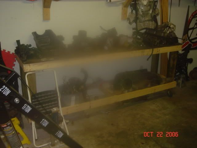

The bench i built for my parts. I put it on castors to move around if need be.
http://i7.photobucket.com/albums/y271/DugnCrissMercer/junk015.jpg

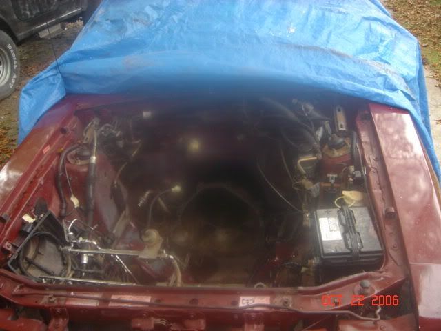

The old home for the 302.
http://i7.photobucket.com/albums/y271/DugnCrissMercer/junk010.jpg
How it looks now

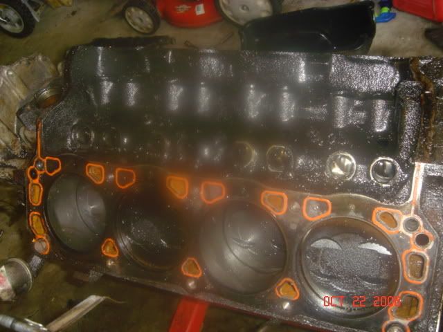

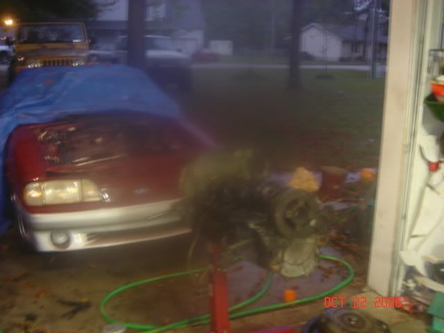

http://i7.photobucket.com/albums/y271/DugnCrissMercer/junk012.jpg
http://i7.photobucket.com/albums/y271/DugnCrissMercer/junk014.jpg
http://i7.photobucket.com/albums/y271/DugnCrissMercer/junk009.jpg
Hopefully I can get this back together somewhat quickly. I have no idea what I am doing but I am learning as I go. I guess the real test is when it is done and running. If anyone has some 302 parts laying around I could use them, as long as they are still pretty good. This thing was missing a freeze plug and the motor mounts were shot. Doesn't appear to be to badly damaged from what I can see. I thought real hard about putting in the Xj but changed my mid. If this goes well I am going to attempt to stroke the 4.0 in the XJ. Any tips let me know

Well the plan at this point is to check the crank for tolences. I want to just replace the parts with stock spec components. I only see one cylinder that has a very small scratch that should hoan out. At least that is what I am hoping for. I will replace the bearings, rings, valve stem seals, and hydraulic roller lifters, with new stock spec ones. Unless I have to take the block out to get it bored out and if that is the case it will gate bored out to .30 and the crank will get polished or turned which ever it needs.
All this is new to me so If you have some tips please share. I have never pulled a motor before much less tear one apart. I have learned a lot already. First being to pressure wash it before you take it apart. I got overly excited to tear it apart.

Those pics weren't as good as I had hoped for. I couldn't get the wifes camera to stop glaring. I finally built a bench to work on. My wife told me it was about time, go figure.
