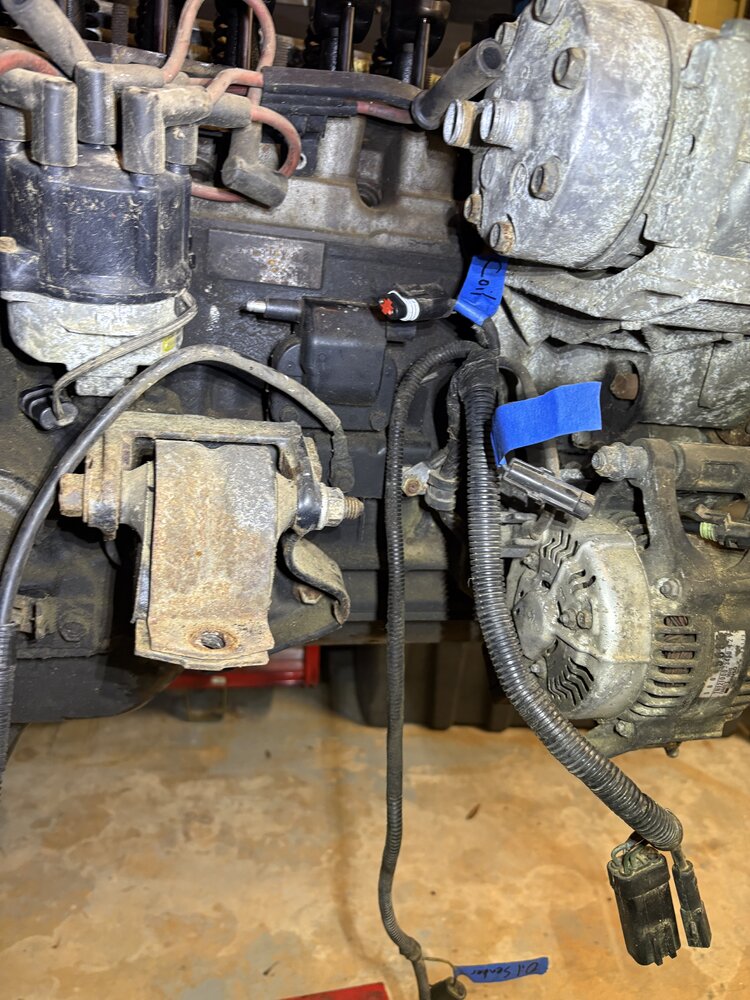

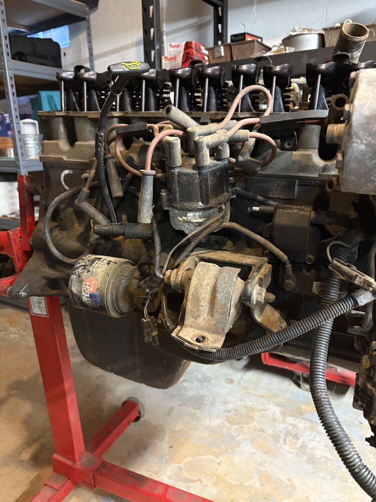

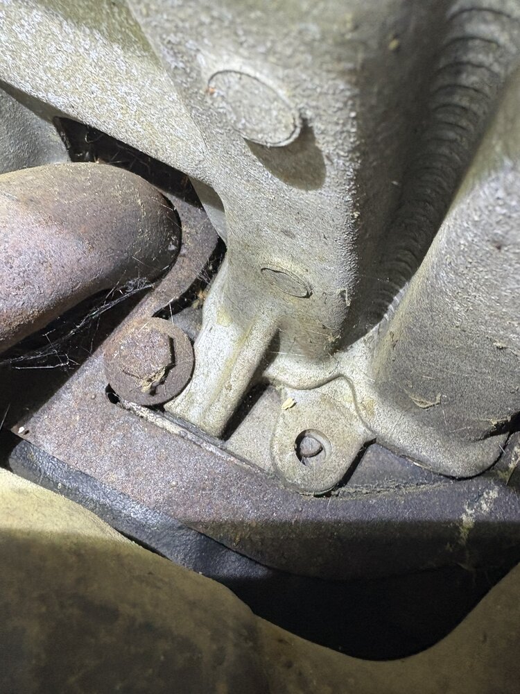

1. Found an oil drip on the bottom of the bellhousing. Seemed to be coming from inside the bellhousing. Pulled the inspection plate and couldn’t determine source. Rear main? Oil pan? I feel fairly comfortable I was quite diligent about installing those. Or I am suspect that my starter that I reused from my leaky old 258 may have consumed an amount of oil. Fingers crossed I pull the starter and find it full of oil.
The other concern is a tapping/knocking from an undetermined location. Could be the cobbled together exhaust. Toes crossed for that. But it sounds like it could be coming from passenger side near the dizzy or #2 cylinder/valve train. Hard to tell. Need to grab a length of hose/stethoscope.
