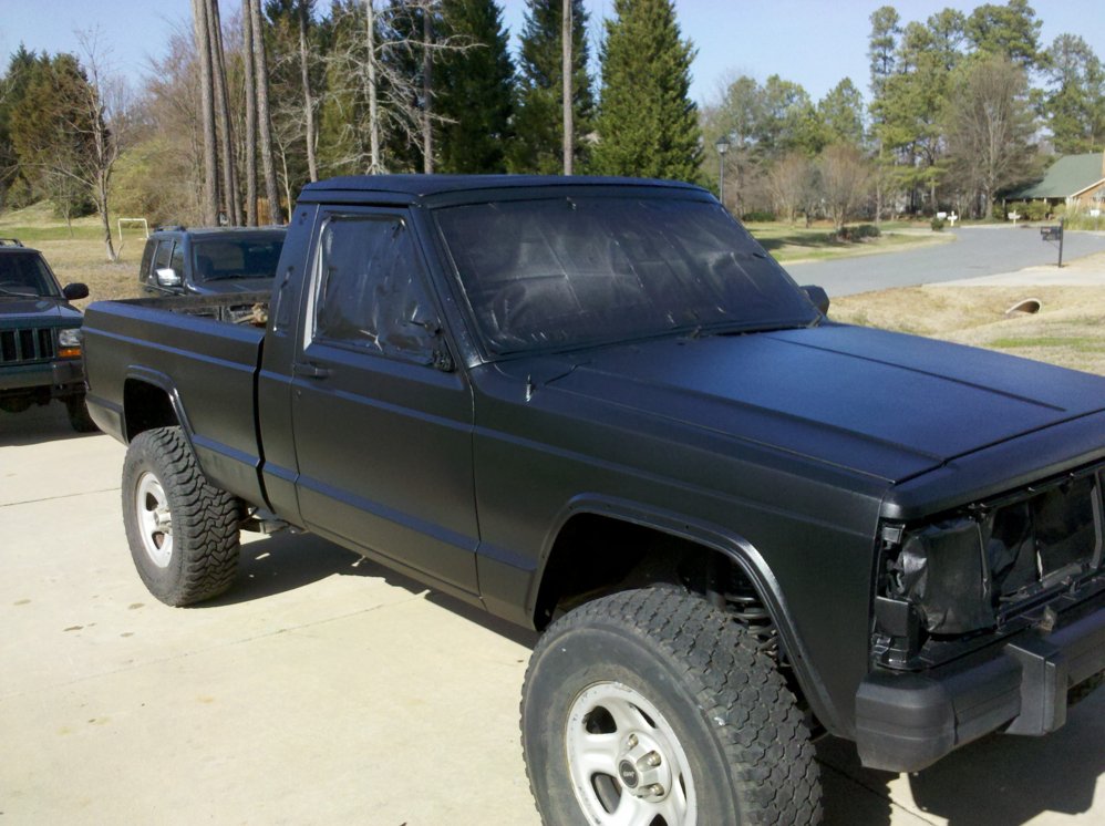

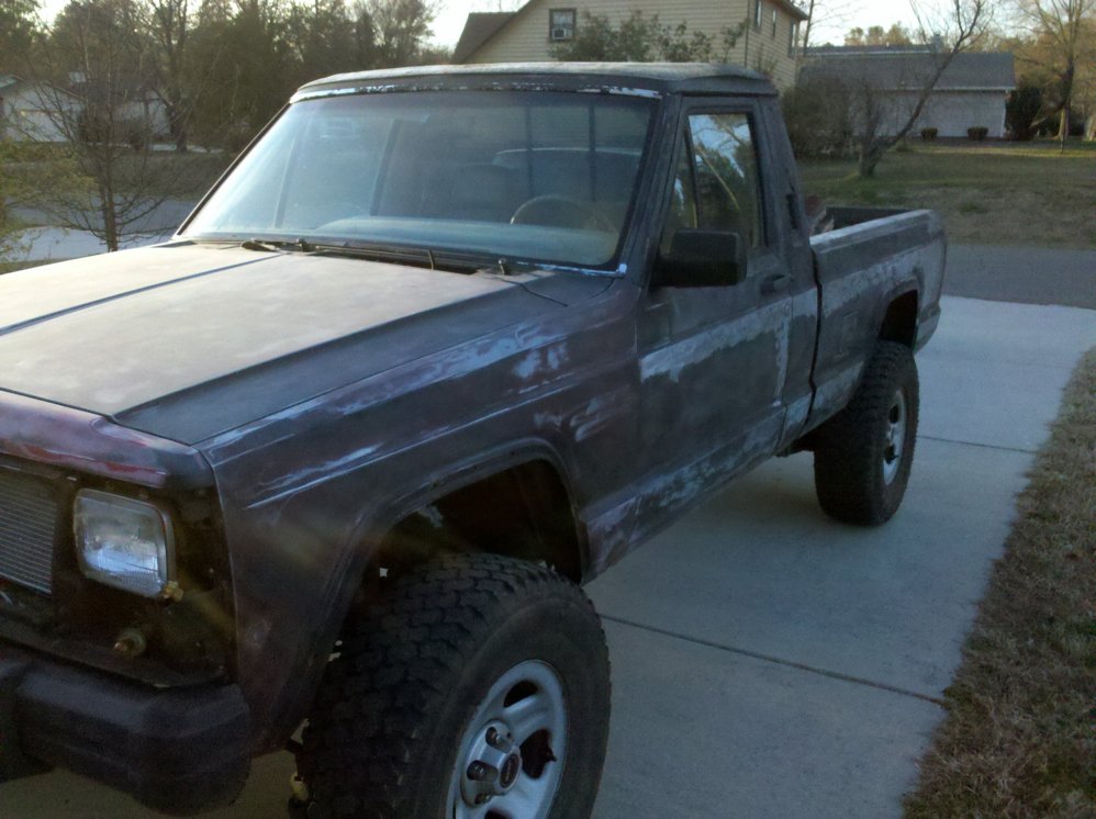

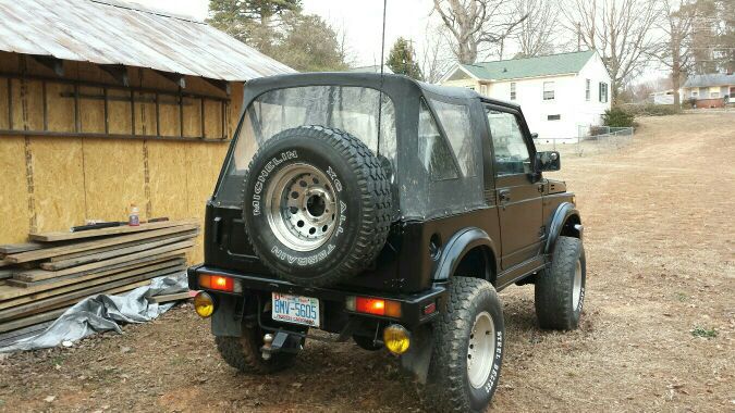

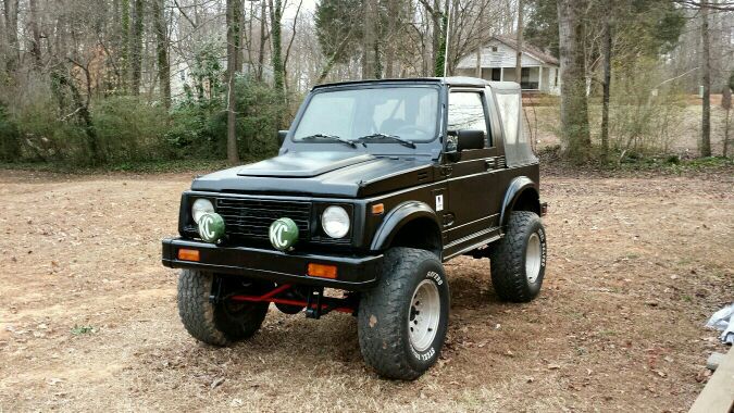

Hey guys i was tired of the same ole same ole, so i took advantage of the 70 degree weather we had yesterday and after 3.5 hours and $18.95 (2 cans of primer and 2 spray cans of gloss black) from ACE hardware, the Sammy completed....
FROM THIS!!!!
ascontent_a_iad.xx.fbcdn.net_hphotos_ash2_t1_1012347_10201269340157586_1295999743_n.jpg
TO THIS!!!!!!!
ascontent_a_iad.xx.fbcdn.net_hphotos_frc1_t1_1966720_10203025039408970_1746839661_n.jpg

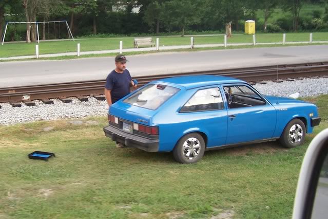

I've actually seen some well done roller jobs on cars and trucks. Trick to it is to use a VERY short nap roller. It's hard to get consistent quality out of spray bombs, especially if windy at all.
IMO the trick is using Rustoleum Hammered or similar w/ texture in it... not only does it look cooler but it hides imperfections really well.
i've also seen some great rolled-on jobs. Mix it thin. Actually I roll-on painted a 4Runner top once (using the Hammered), it came out pretty decent, although frankly that stuff is really challenging to get even texture using a roller b/c it changes every time you go over a spot.

Might want to hit it with some clear to keep it from washing off. My K30 is starting to fade after about 3 years or so.

lol Thank you for the advise, but i know she is not a show "Sammy", She is going to get nasty, dirty and all scratched up.... lol So for 3.99 a can of spray paint ill leave it plain. But again thank you for the Advise.
For a beater truck, actually better not doing this - b/c at any point you can just re-spray a section to cover scratches etc and it'll match.
good looking job, I painted my K10 this way and after a few years i decided to do it with body work and auto paint and primer and whatnot, imagine my disappointment when it turned out looking worse than it did before i started....... i loved the rattle can b/c i just washed it and touched up the scratches and scuffs with a fresh coat

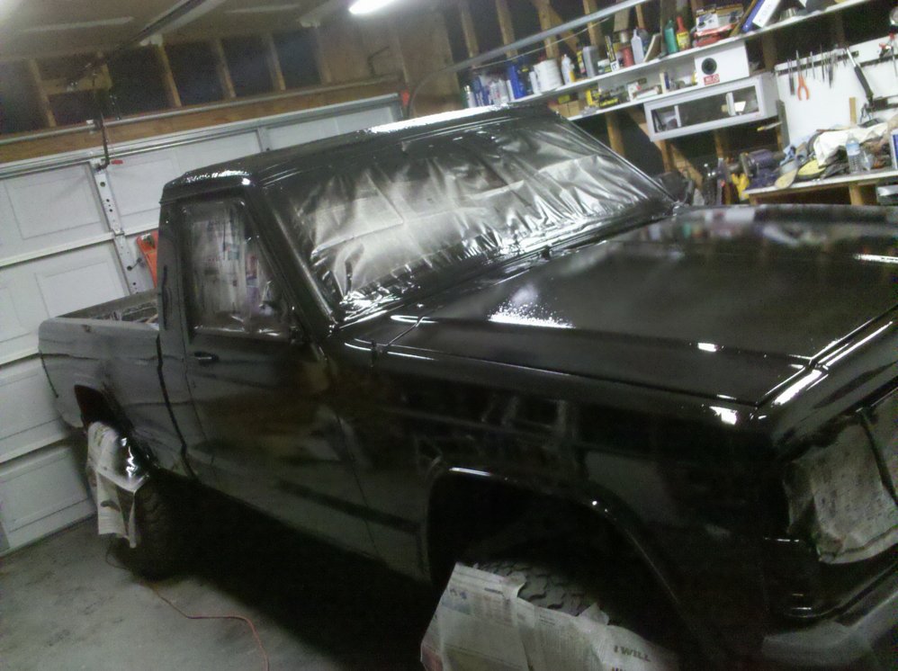

I used a Harbor Freight electric sprayer and a qt of rustoleum flat black on my old Comanche. It left a texture almost like a spray on bedliner.
Before....
during....
