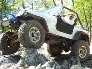

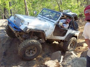

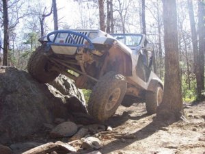

Hey, Yo!!!!
I just joined up, but I know a few of you from here. Thought I'd let everyone know I'm here and let those of you who don't know me see my ride. Be sure to wave when you see me on the road.

Here are some that you don't have to clicky to see
Nice looking rig, always good to get the poser shots too! :)
(I have many a poser shot of mine too)
Rig looks vaguely familiar did you buy it as is or build it?
Sam H
looks clean, what are the specs ?
Built by me.
87 YJ
258, bored .040, high torque cam
Weber carb
custom 2.5" exhaust w/40 series flowmaster
3.5" superlift springs / SOA
HP Dana 44 FW largetube front Locked
FW/FF Dana 60 rear Limited slip
4.10's for now
Still have some things to do:
fuel cell
extent wheelbase
full cage (next on list)
new tranny
gears (5.18's sometime soon)
I like the hummer rims. I've read that some guys had problems with them offorad but I still like them.
With the Dana 60 the hubs stick out far enough that you can bust them on rocks. The 44's hubs don't stick out as far as the 60's, so I'm not as worried about it, but it still is a concern. I'm going to tube fender the front and rear after I get the other stuff done, and I'll get some beadlocks when I do that.
What size tires are you running on that much lift?
37x12.50x17. It isn't as much lift as it sounds, and I can full stuf the tires in the fenders. Looking to get some tubes front and rear for more stuff... and extend the wheelbase.
