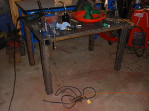

Its 4' wide x 3' deep..
Been working on this for a few weeks in my spare time.. Nothing special, top is 1/4" (thanks fishhunt!!) sides/legs are 3"x3" box and 3"x3" angle. The feet had 5/8" nuts welded to the bottom i need to thread the bolts on for my levelers.
Not yet installed is the 1-3/4 box tubing ill be using to make mini-reciever type plug-ins for some of my other tools. Then ill make a storge spots underneth. Ill use 1-1/2" for the inserts..
I have a small garage so i can either spend 5min, digging somthing out of the corner or 5 min, pluging it into a socket on the bench.. Things like bench grinder, tube notcher, axle/t-case jigs i normally clamp in the vise.
Table weighs a good bit i needed my engine crane just to help flip it over..
