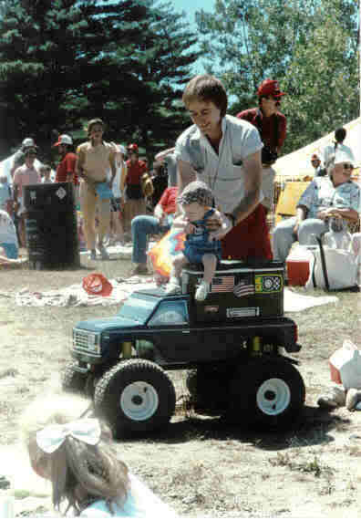

Thought yall would get a kick outa this
It had a 12 deep cycle marine battery, that powered 4 electric motors (1 on each corner), through a variable speed controller with a max speed of just 3 mph. (cant remember the crawl ratio)
Electric rotary worm gear steering, Full function remote control.
Tires - 6.00 x 15 - 6" Carlisle turf safers
Length- 42"
height - 29"
weight - 40 pounds (unloaded) , MGVW, 65 (that load would be a cooler loaded with a case of & ice)
Basically 1/5 scale Bigfoot. If the pitch were right, it would actually climb stairs unloaded.
Dismantled it a couple years ago and parted it out, I think I ended up recycling the modified power-wheels body.
It was called "Budfoot"
Steve
