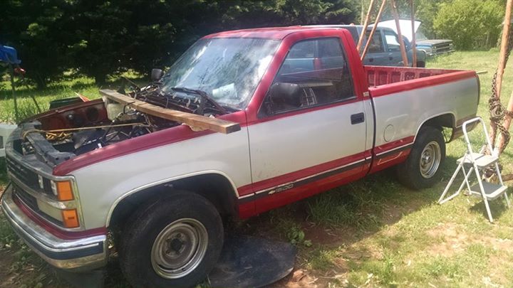

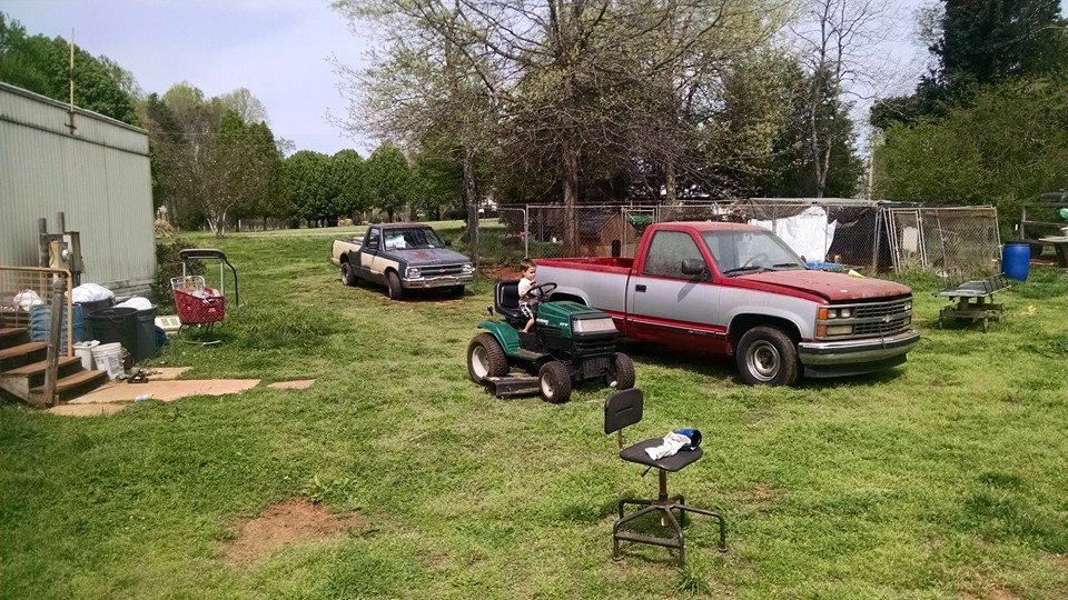

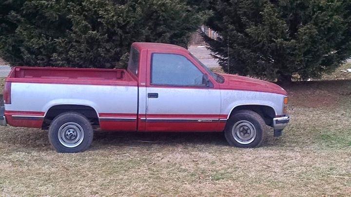

I had a woman call me to come clear some scrap metal out of her yard. Under a tree was an 88 Chevy short bed with about 3 feet of pine needles covering it. I gave her $500 and left with it. It had to work on the way home. We loaded 4 work benches on it. I towed it behind my 94 Chevy Suburban that died shortly thereafter. The little S10 is my wife's 500K mile S10 still doing work.
It sat in the yard for a few weeks with no real hurry to get it on the road. We started it up and it smoked like a house on fire. It also had no brakes. That was a fun test drive.

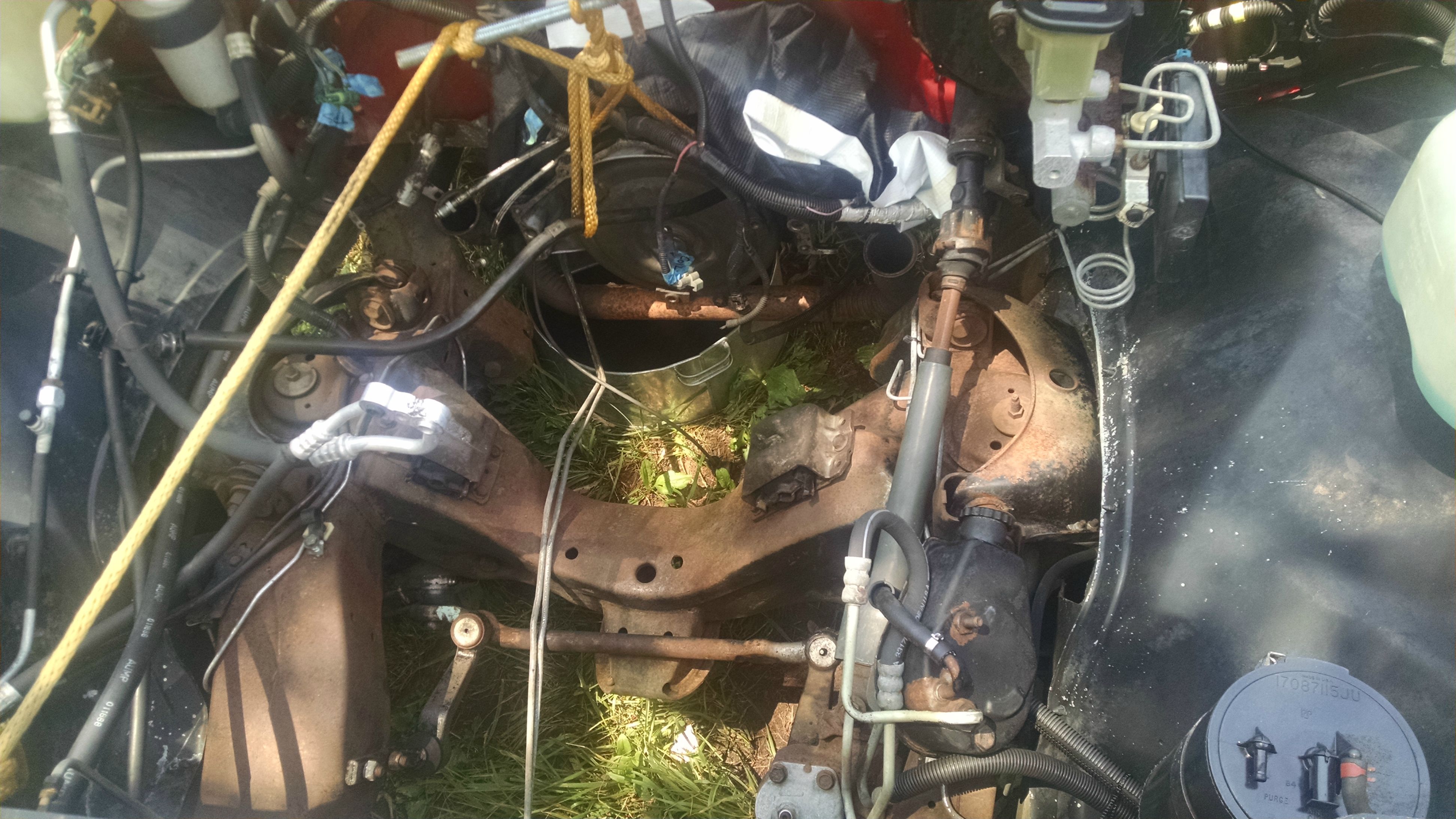

Pulled the engine.
It was covered in grease and oil and grunge from a massive oil leak. Some Purple Power and a pressure washer and it looks pretty good. Still have some cleaning to do.

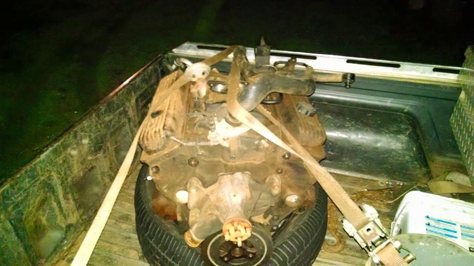

I bought an engine.
Guy said it was perfect. Got it home. One cylinder was full of water and it had 60psi compression on 2 cylinders. If I wanted to rebuild one I would rebuild mine (which will happen eventually). Took it back and got my money. I was called every name in the book. I was bigger than he was so I got my money and left.

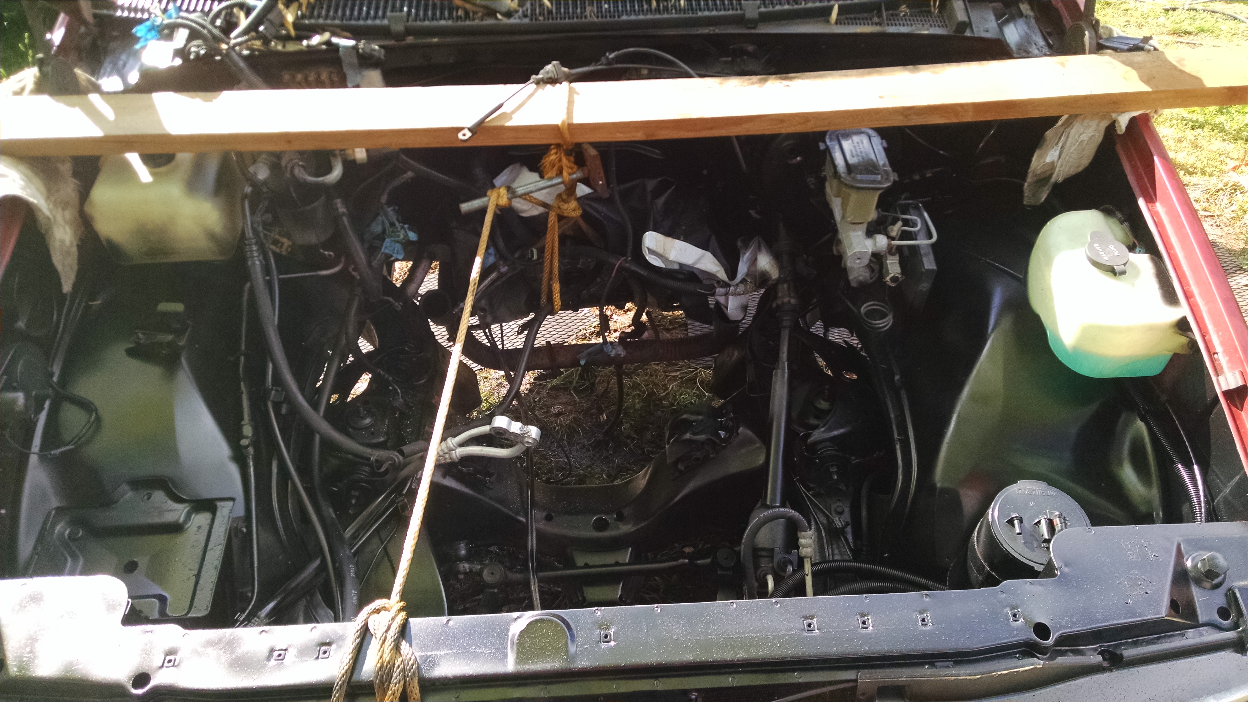

Final wash of the engine bay

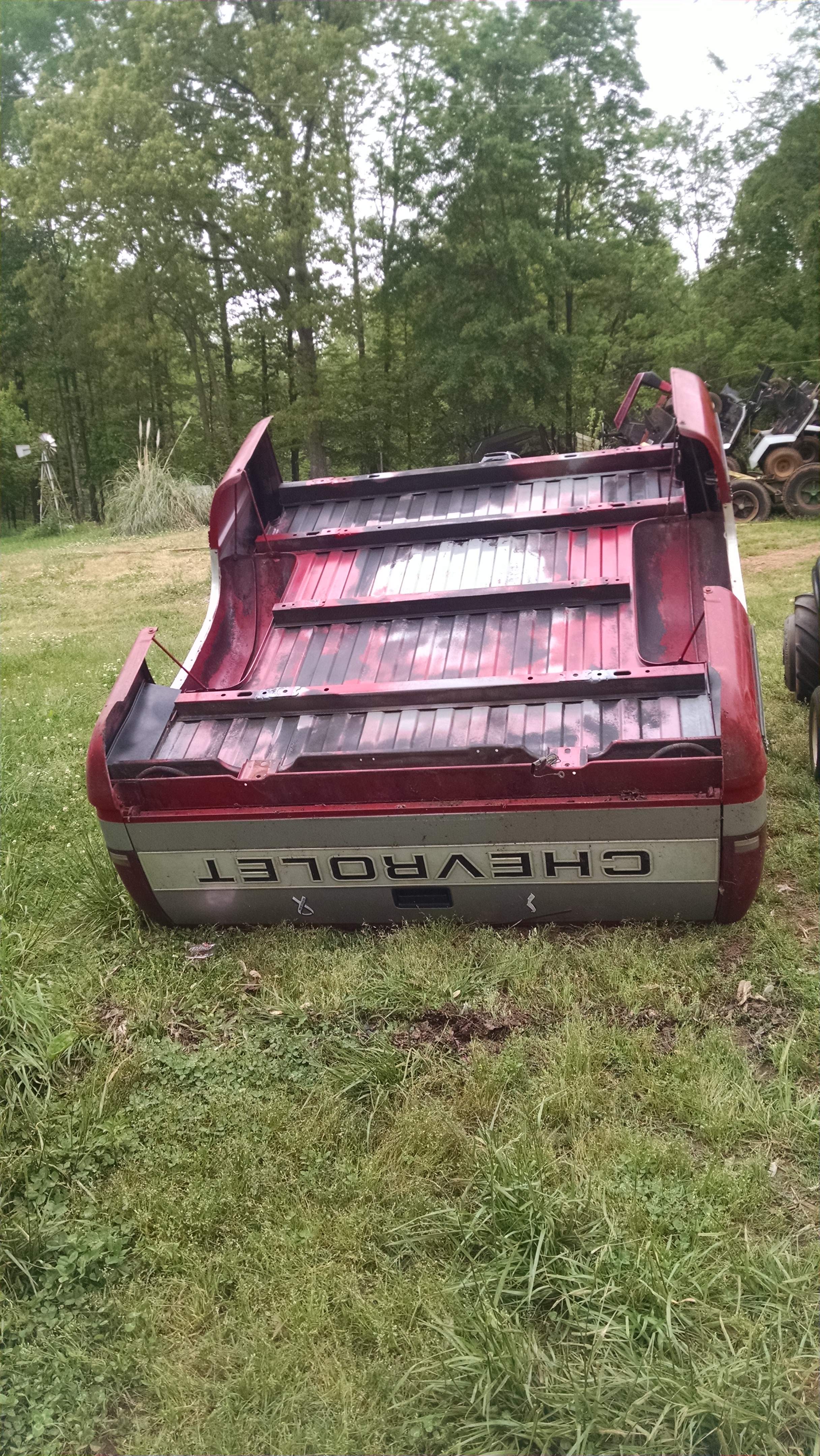

Back cleaned up nice too

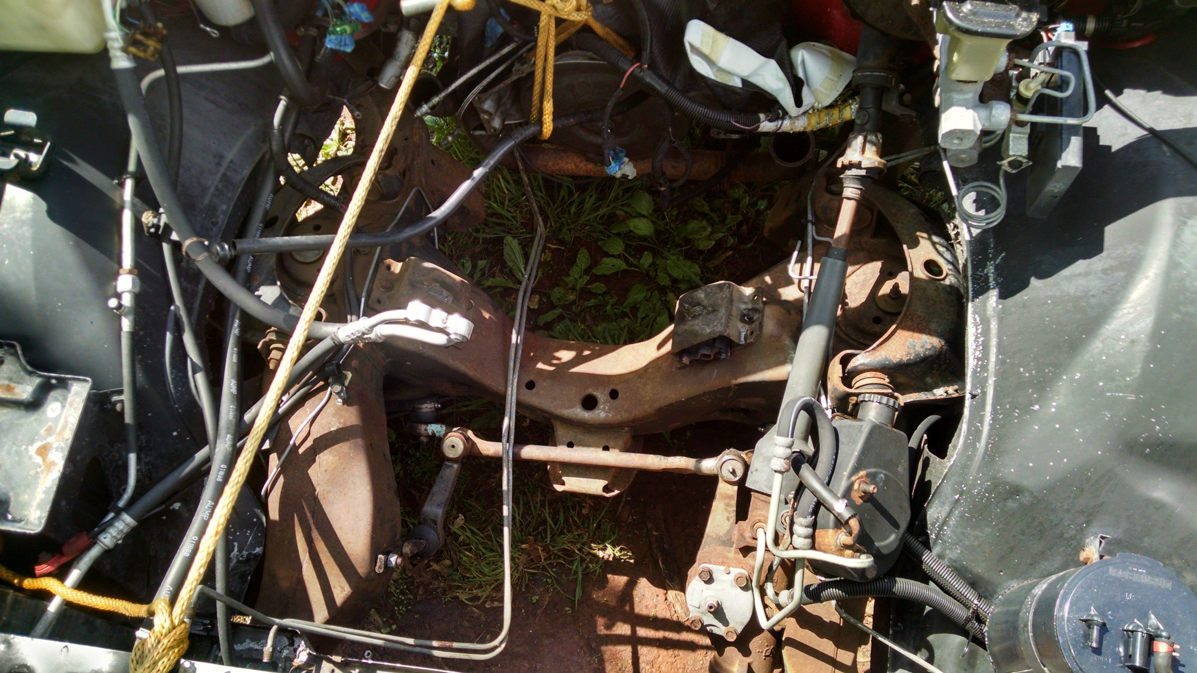

I am going to lift it up with the crane tomorrow and get under the cab.

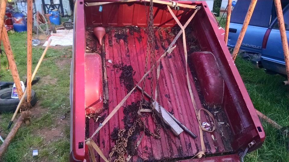

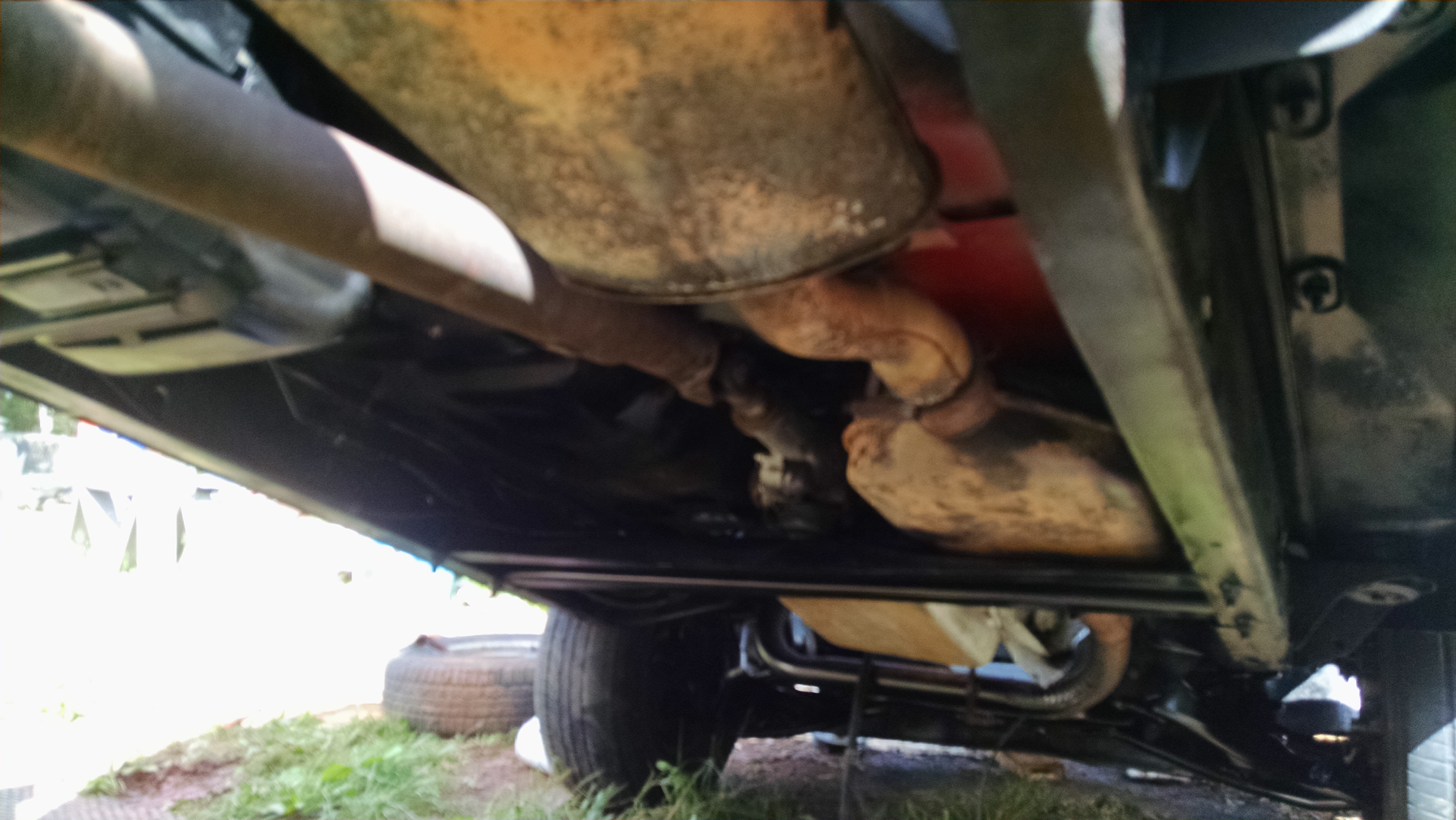

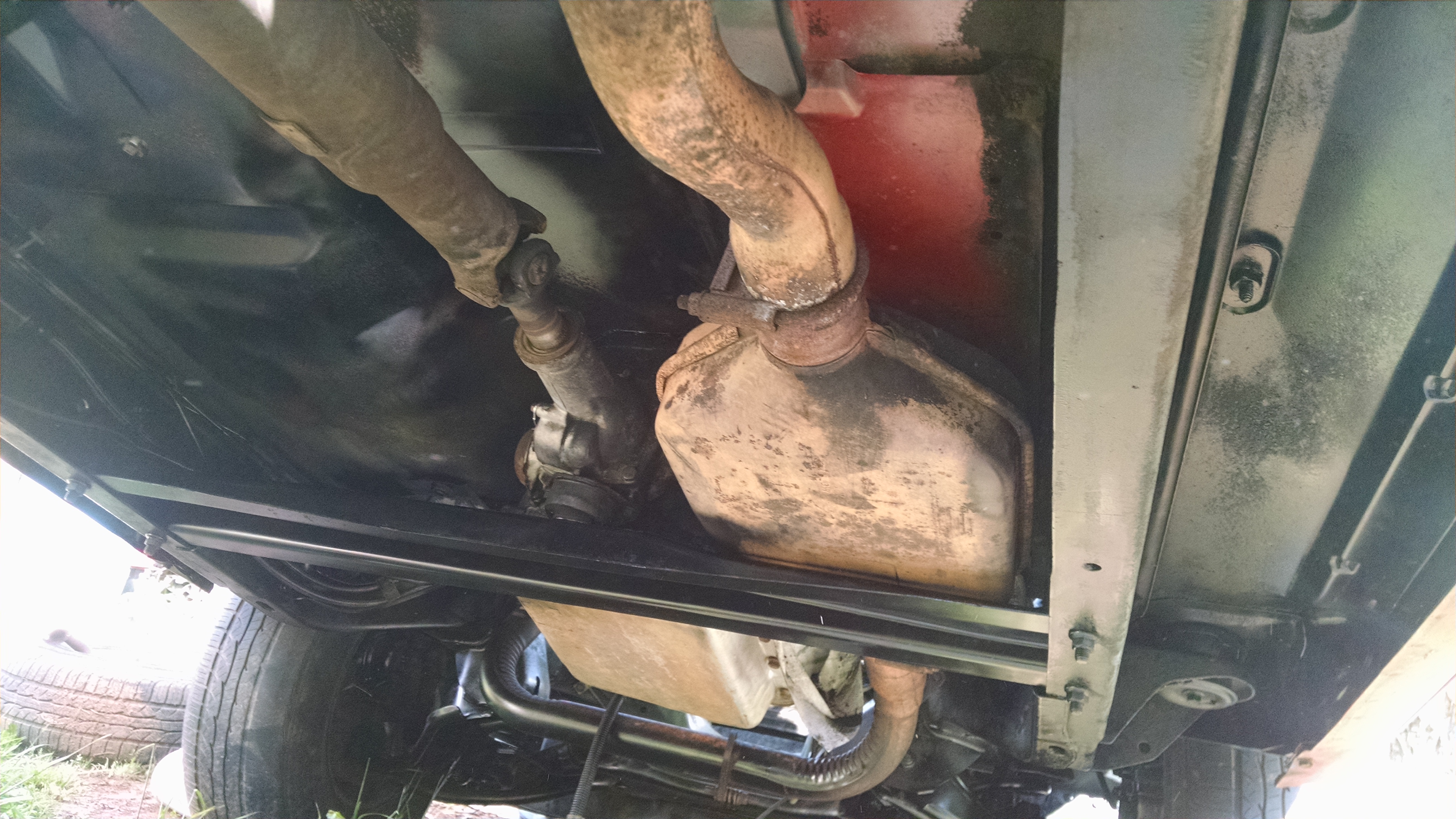

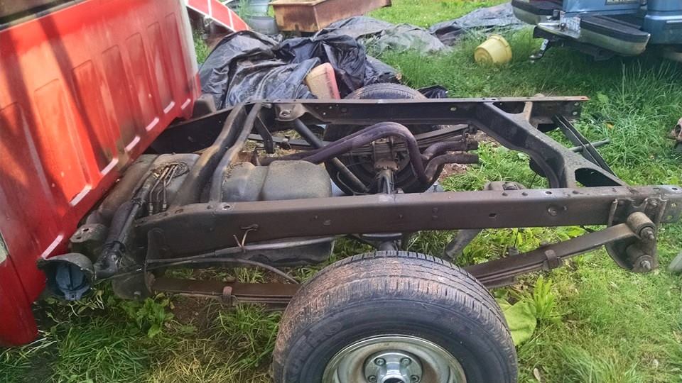

Under the bed
Still gunky but getting there. My shoulder gave out so I had to stop.

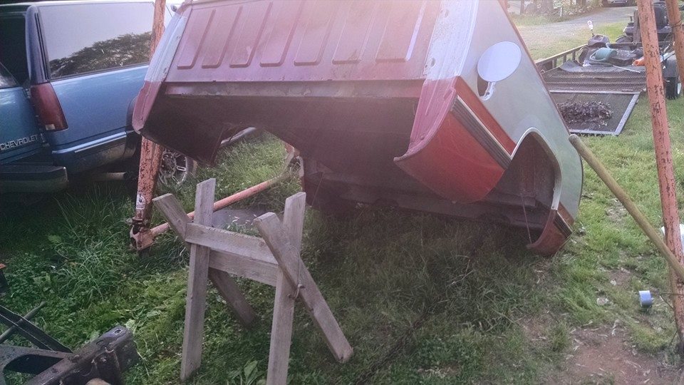

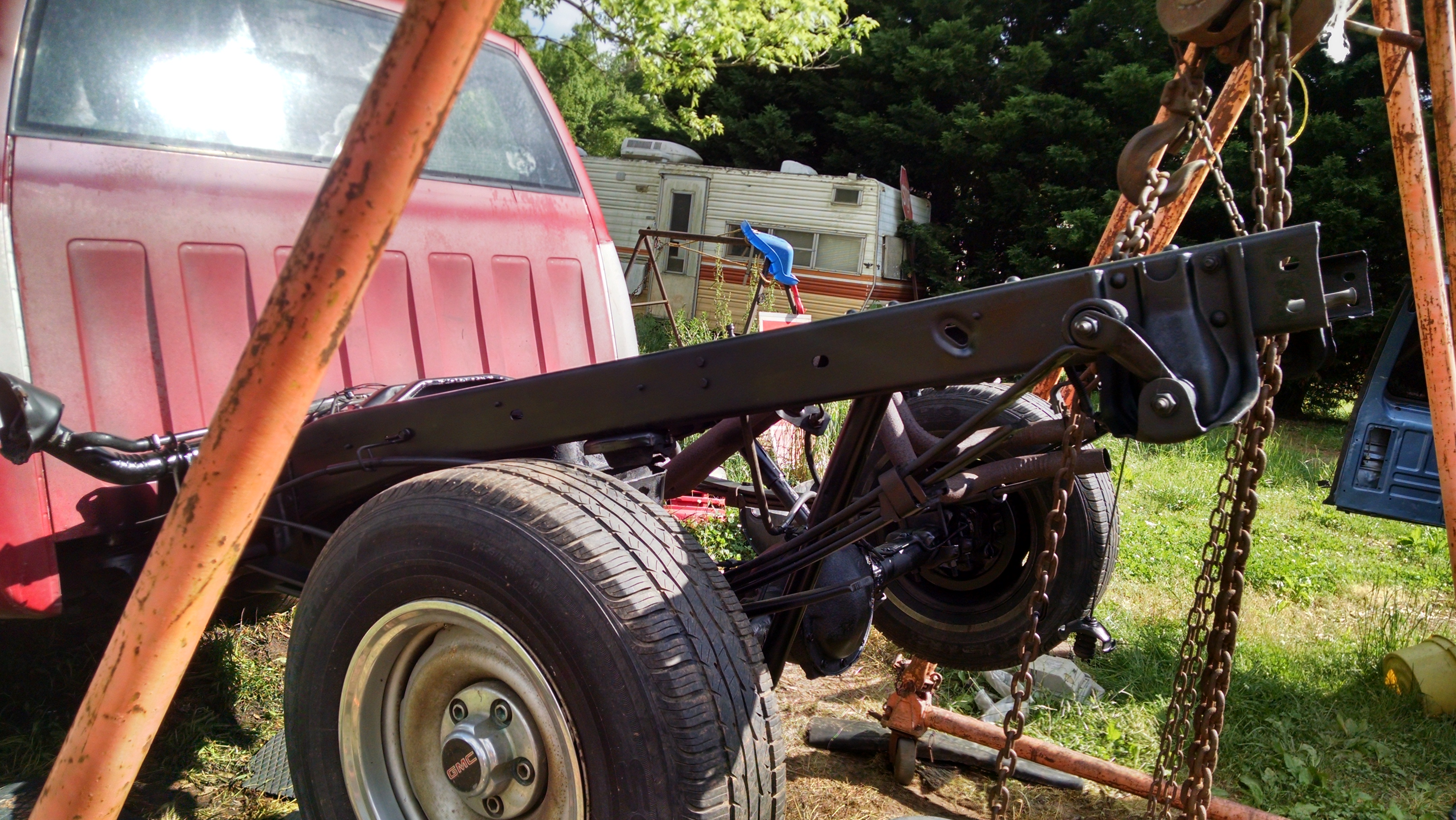

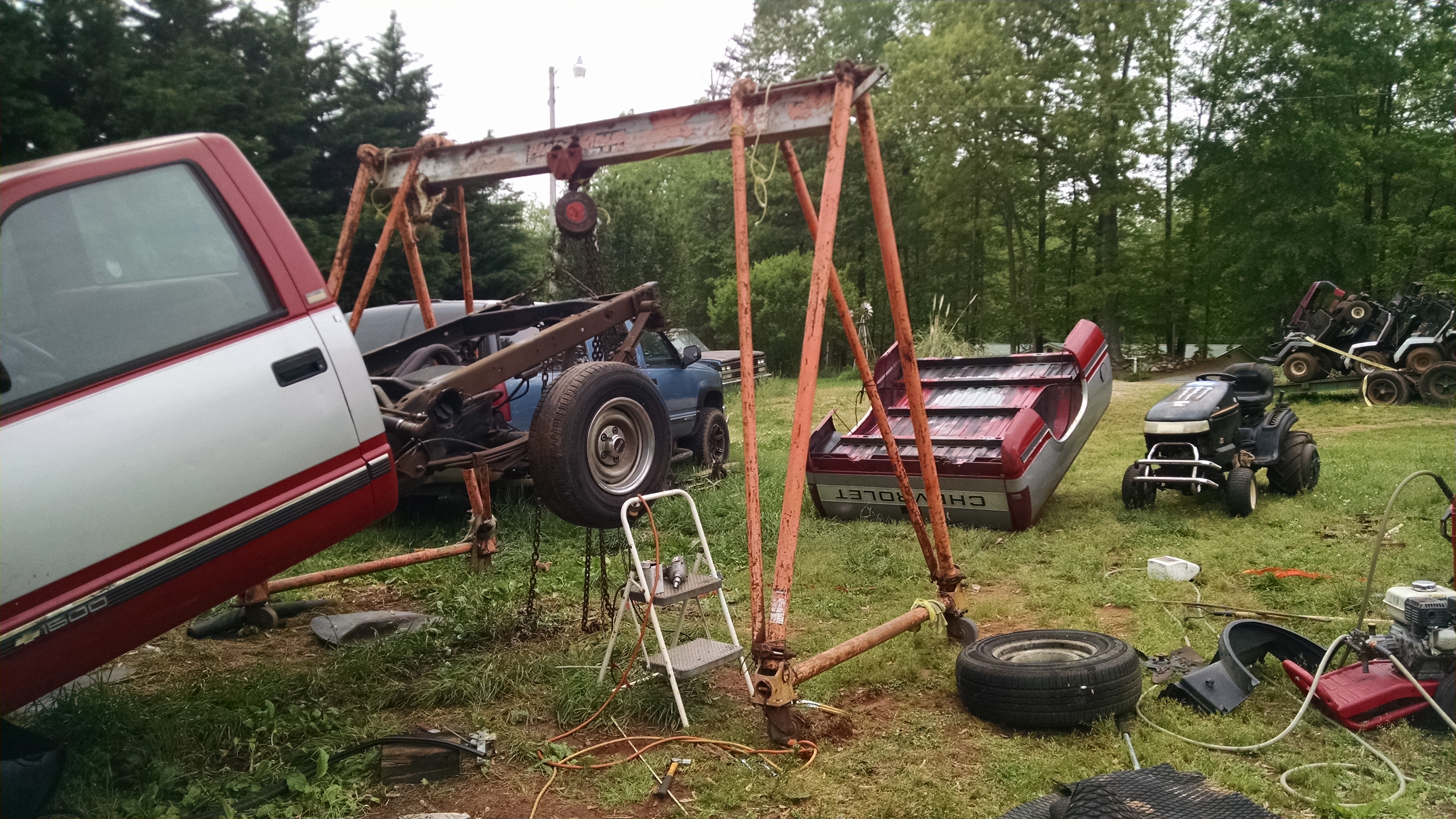

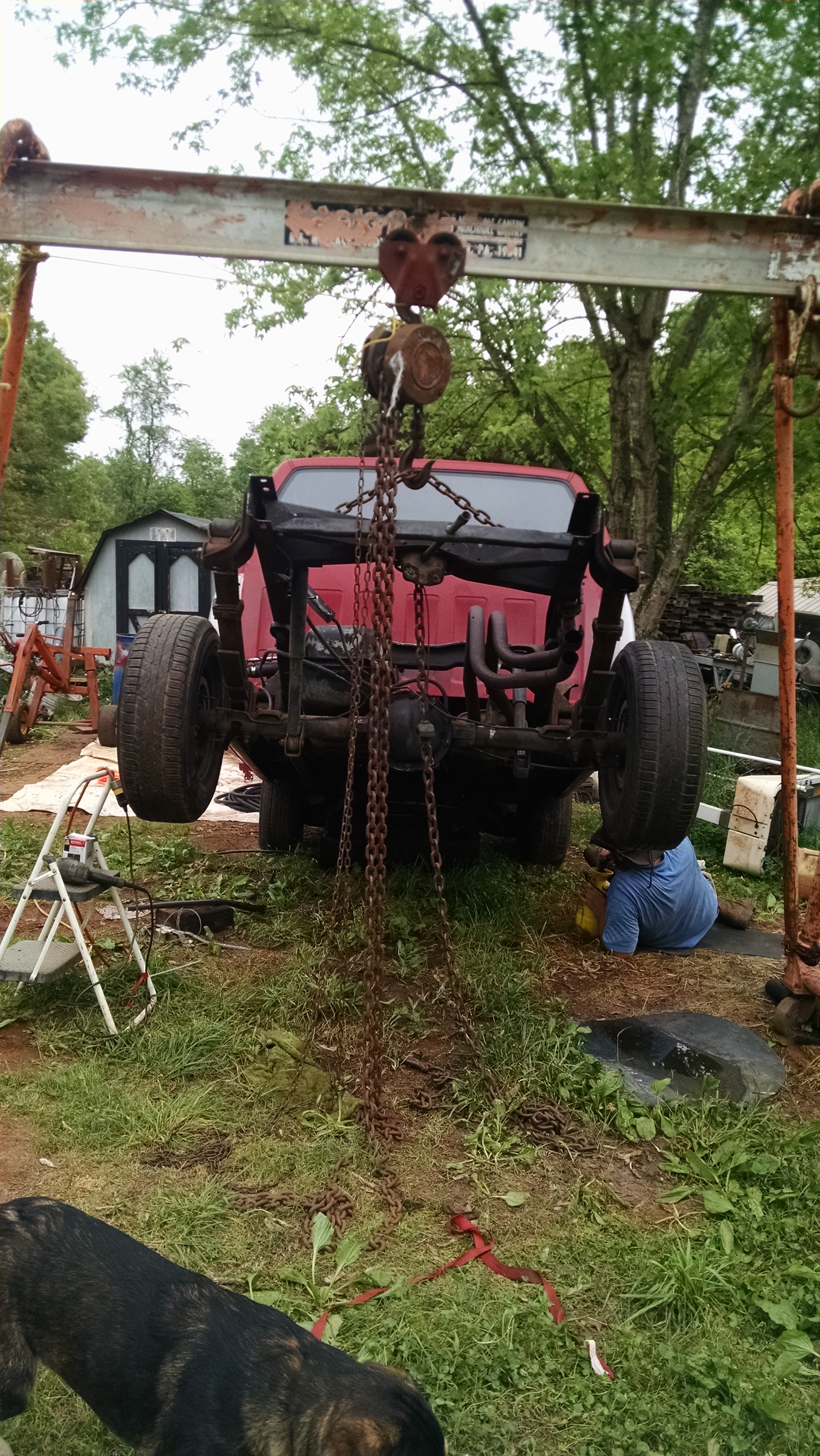

Needed to clean the underside so the gantry crane lended a hand

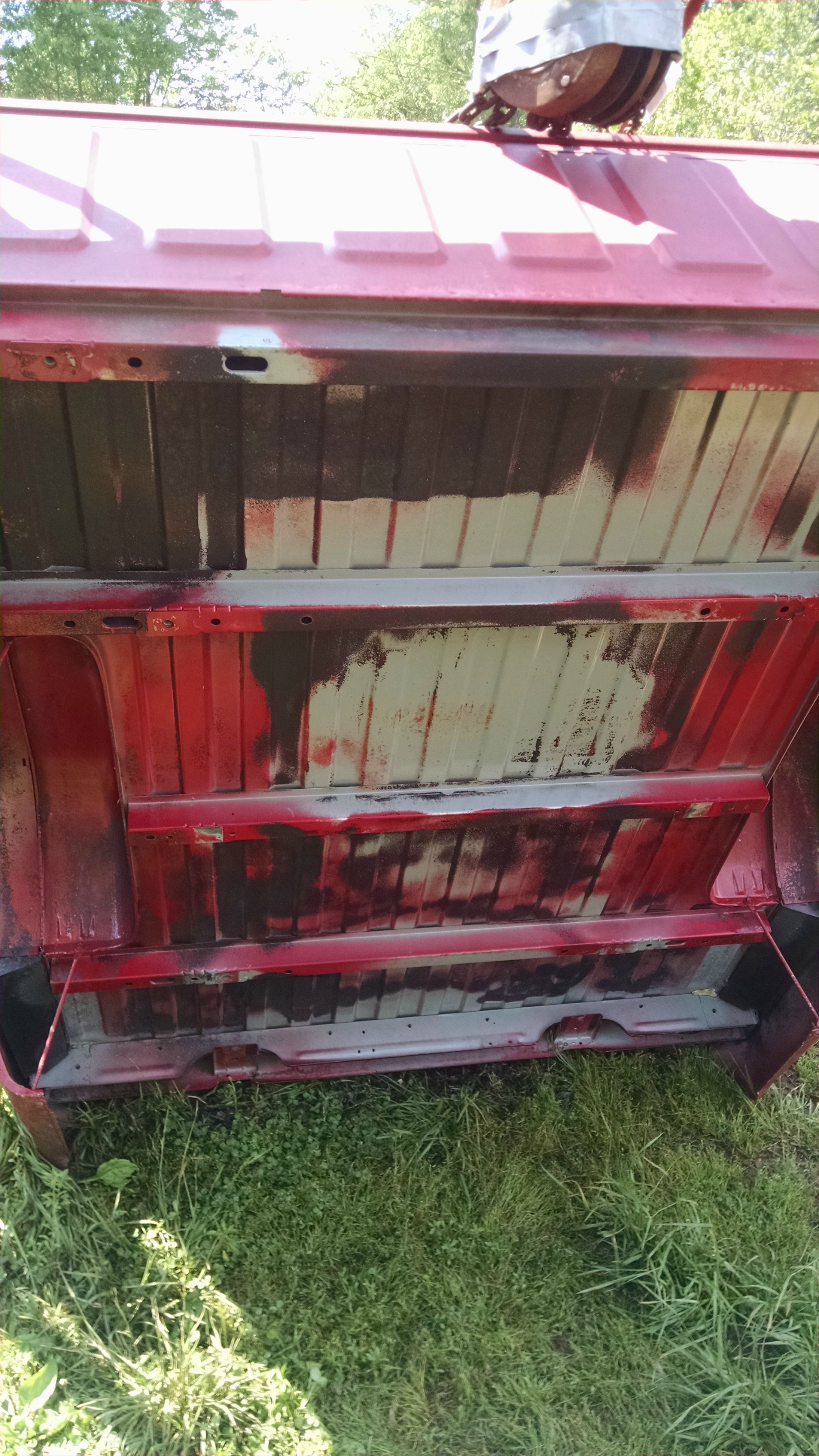

Flipped the bed. Still have some gunk to clean off it
Better shot of the underside hosed down with degreaser, Bottom on the cab is nasty!

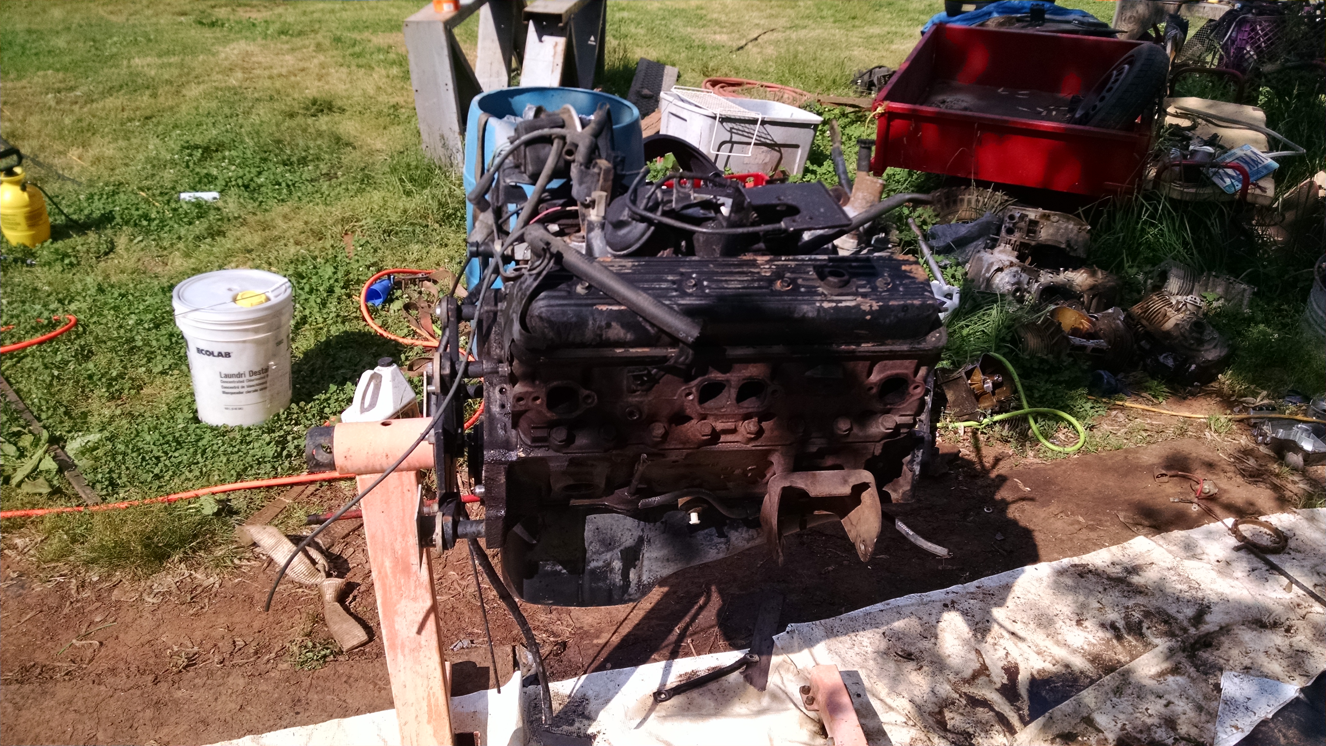

Hosed down the engine with degreaser.
It was super nasty

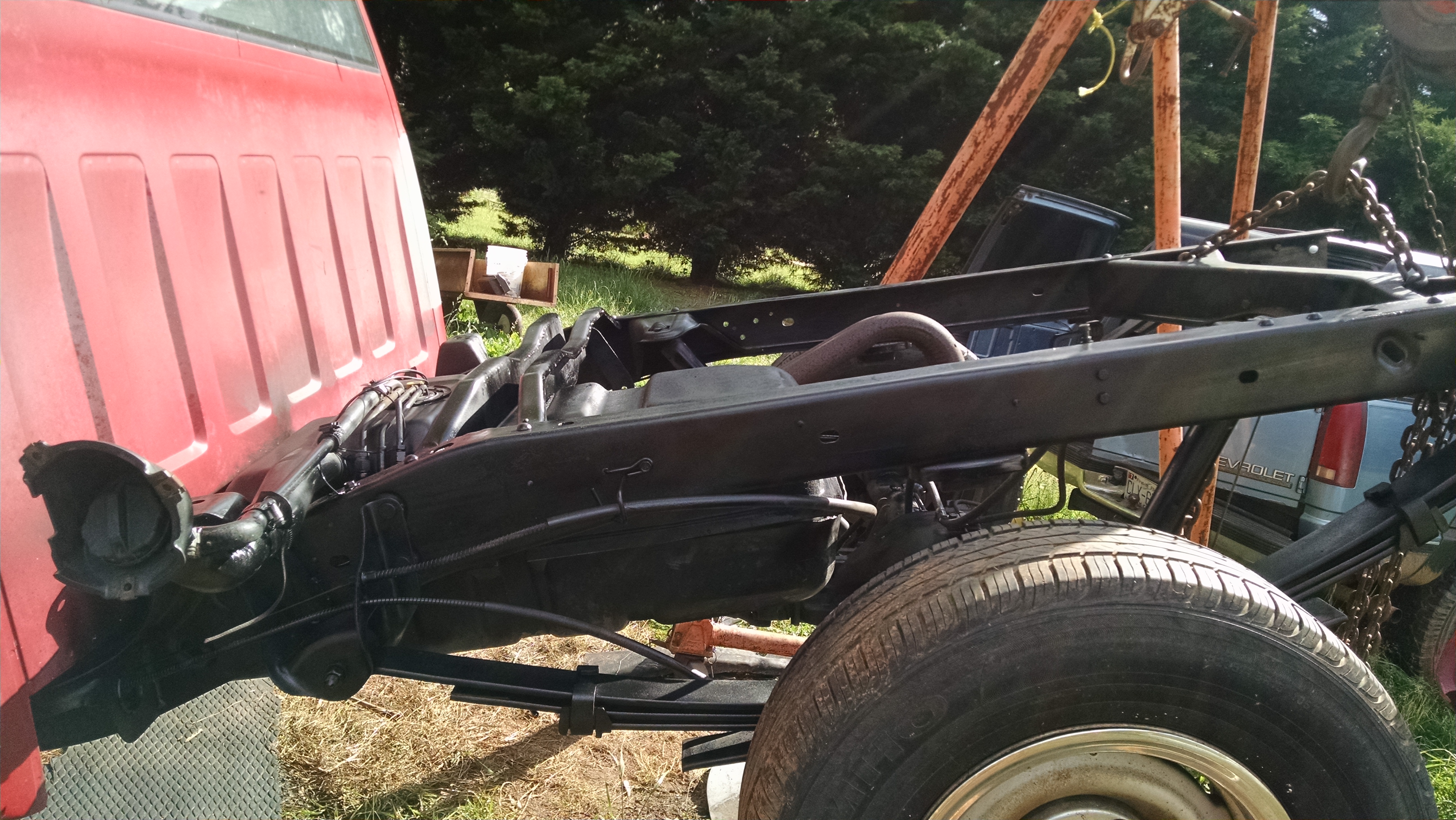

My son, Jared and I attacked the frame and engine compartment with Rustoleum rattle cans. Looks a world better.

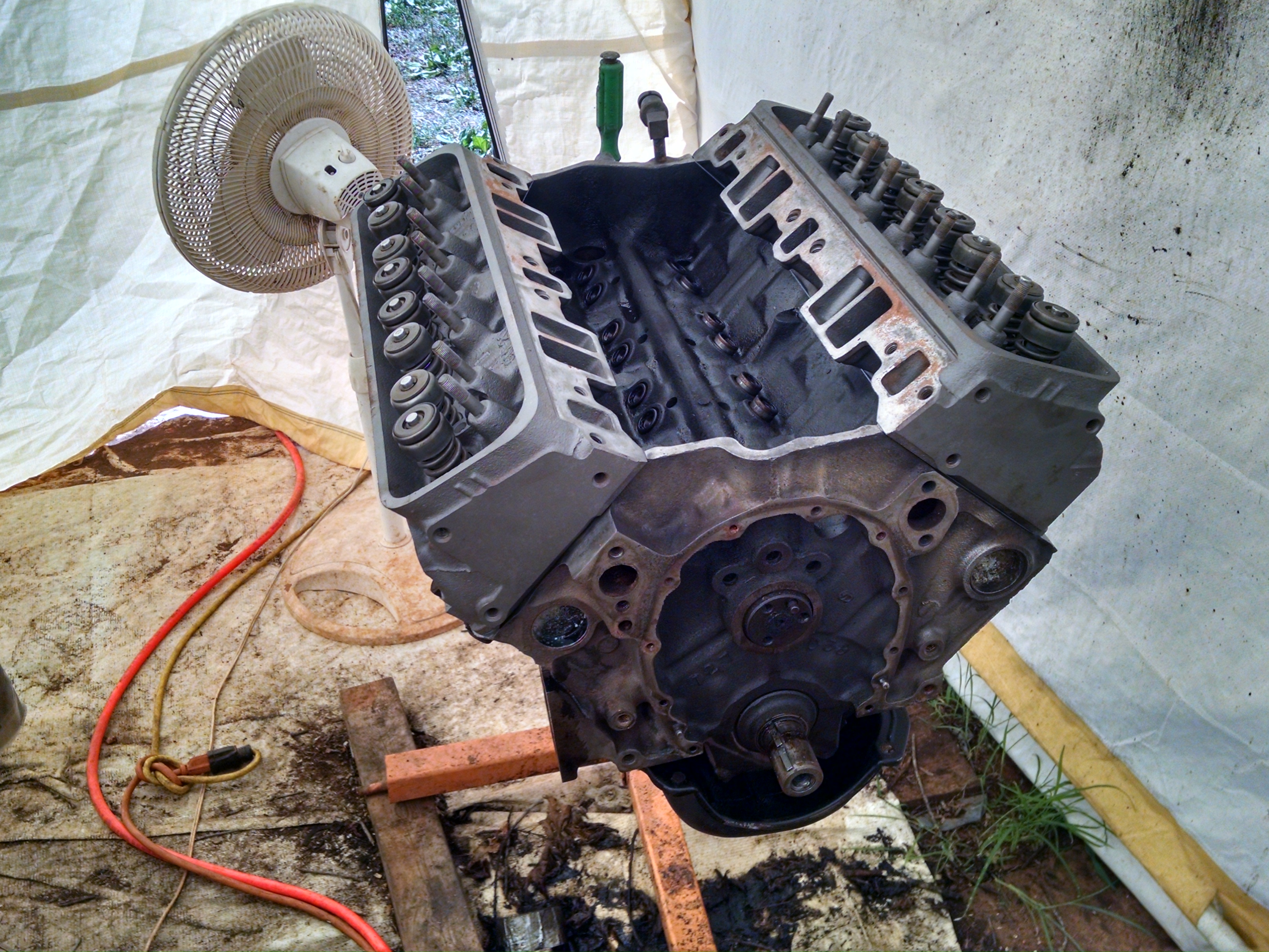

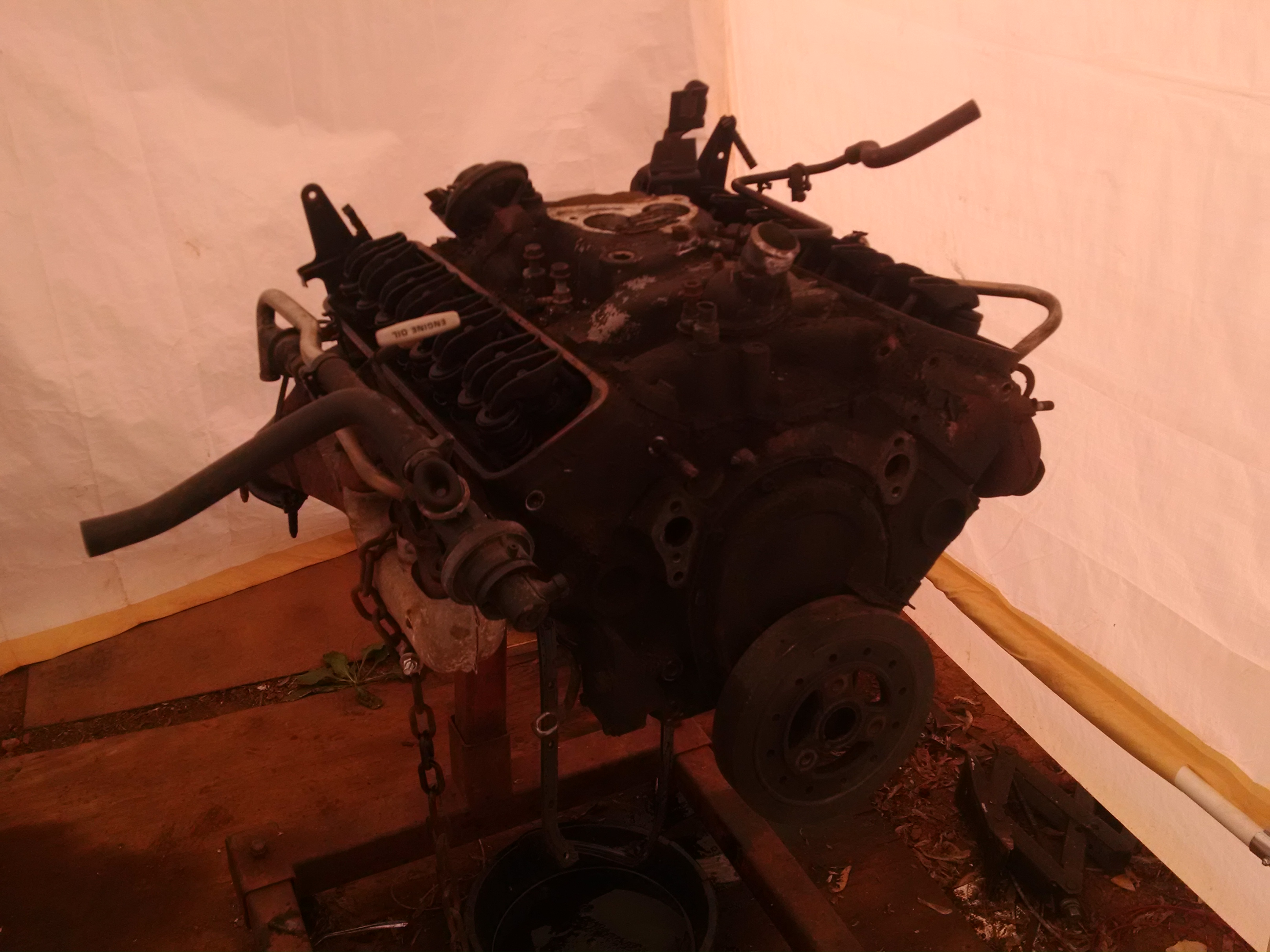

The other engine.
Did a compression and leak down test. Showed blow-by from cyl 3 to 5. I figured it was a blown head gasket - worst case scenario is a cracked head and I have 2 more sets. SO we (my son Jared and I) pulled it down. Here he was using a box for the pushrods

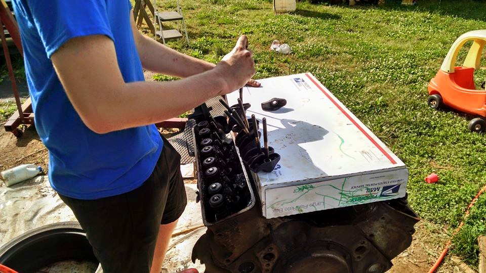

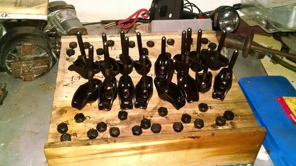

Decided to make something reusable
Took an old drawer and drilled holes in it. Covered the other side in a old metal sign. Everything is numbered. Super easy.

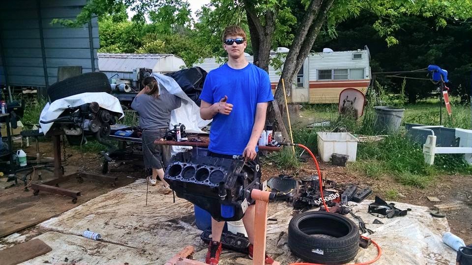

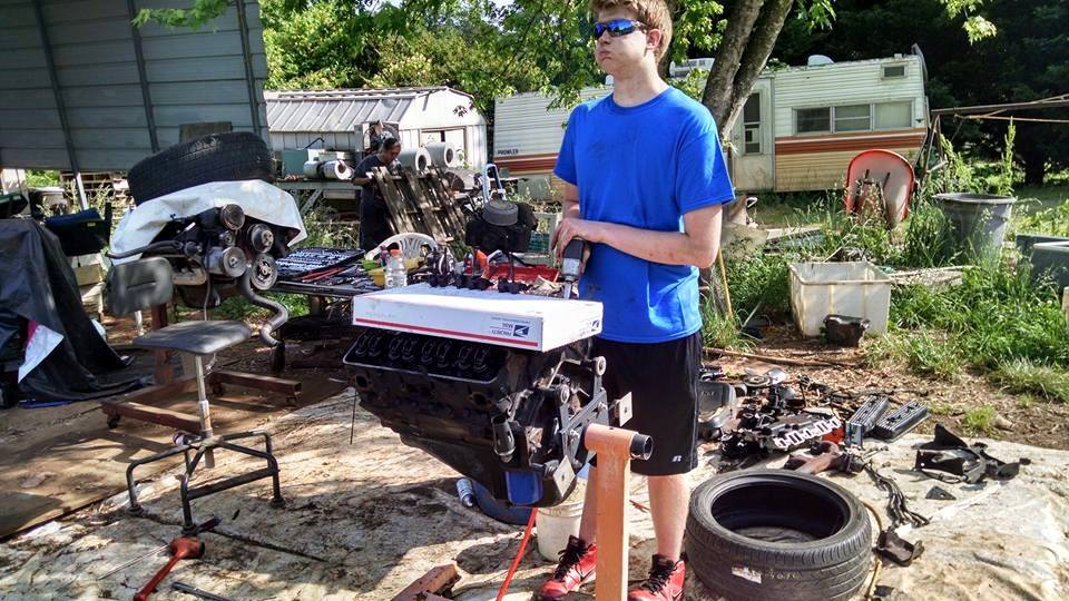

He was pretty proud.
This is the first engine he has ever had apart.

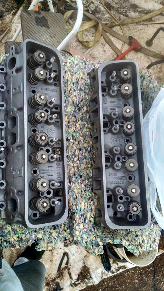

Thursday the machine shop called and said the heads were cracked. NO problem I had another set in the shop. Had to dig them out and send them off.

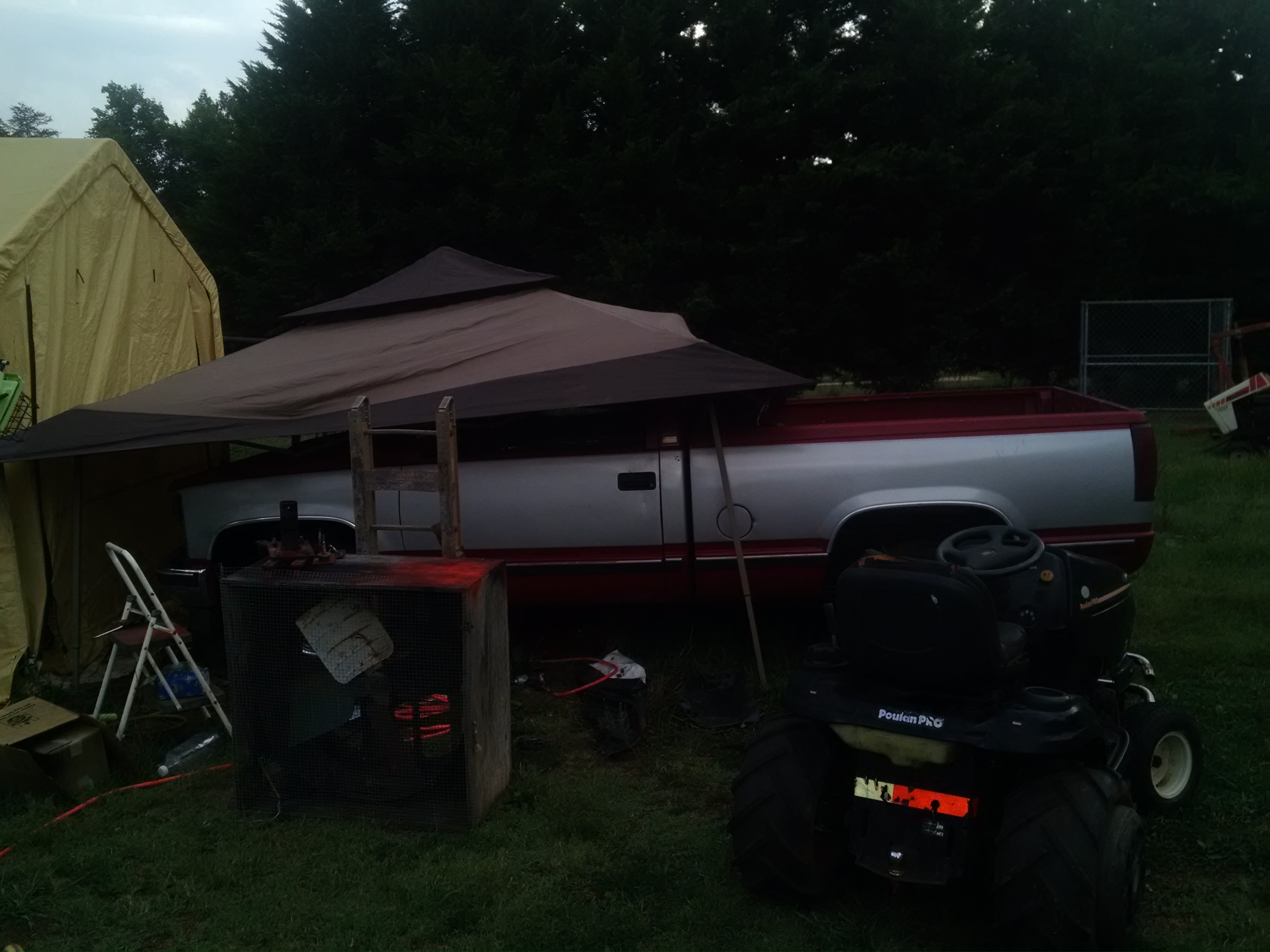

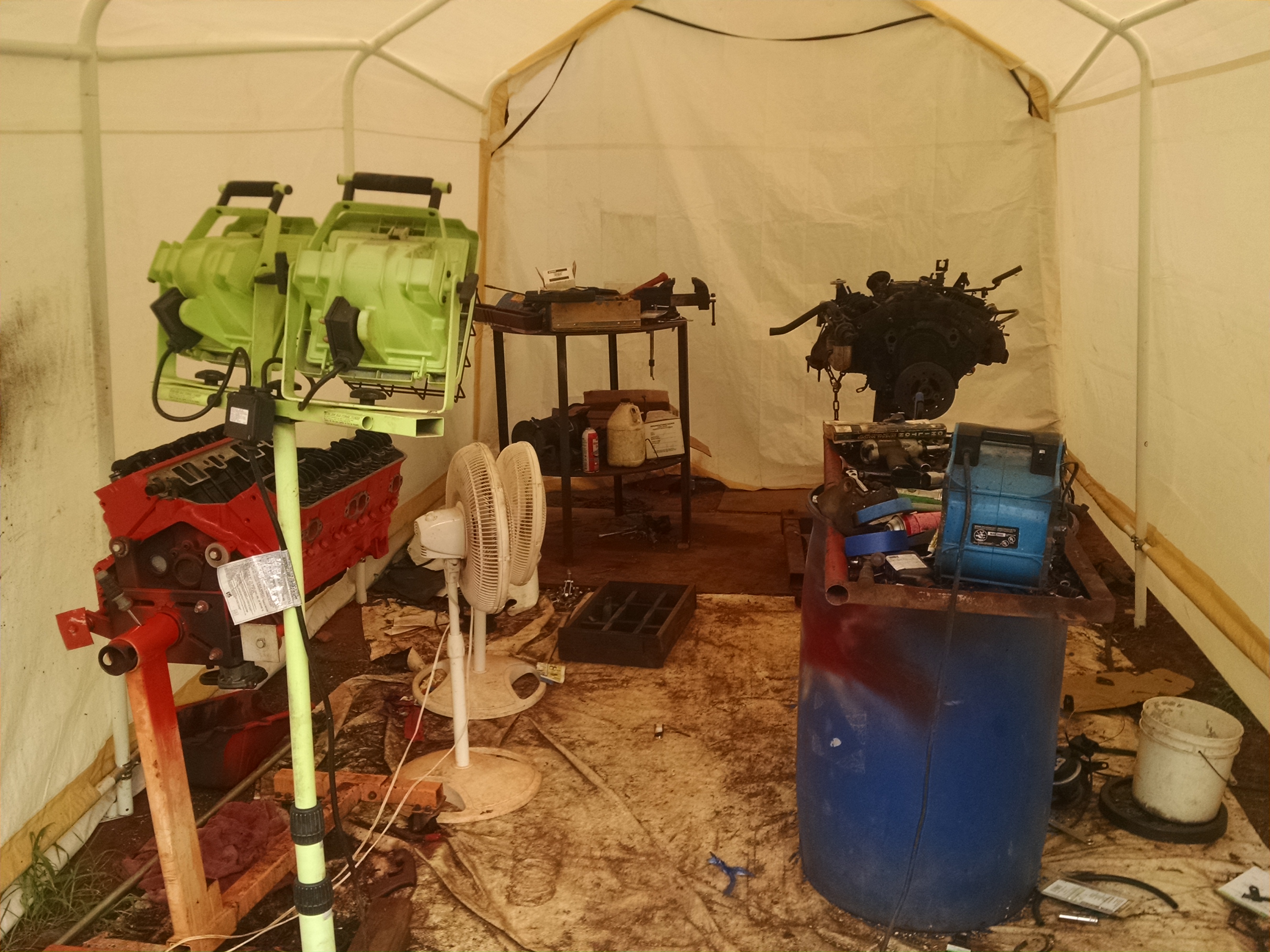

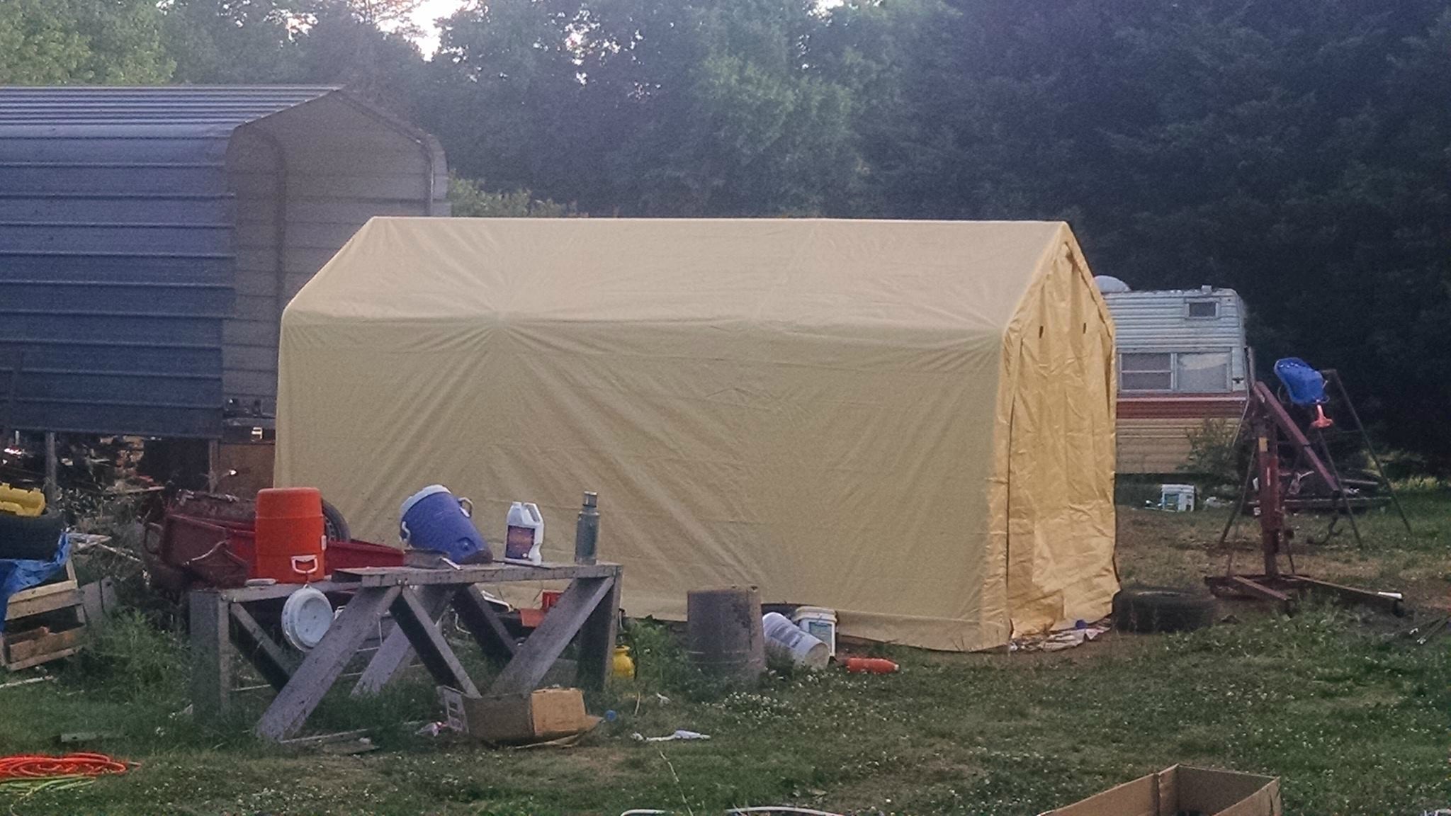

Forecast is calling for monsoon weather so I figured I needed a dry place to work. The carport is full of tractor stuff so no working there.
Saw an ad on CL for a portable building. Got it up just in time on Sunday. It has rained ever since.

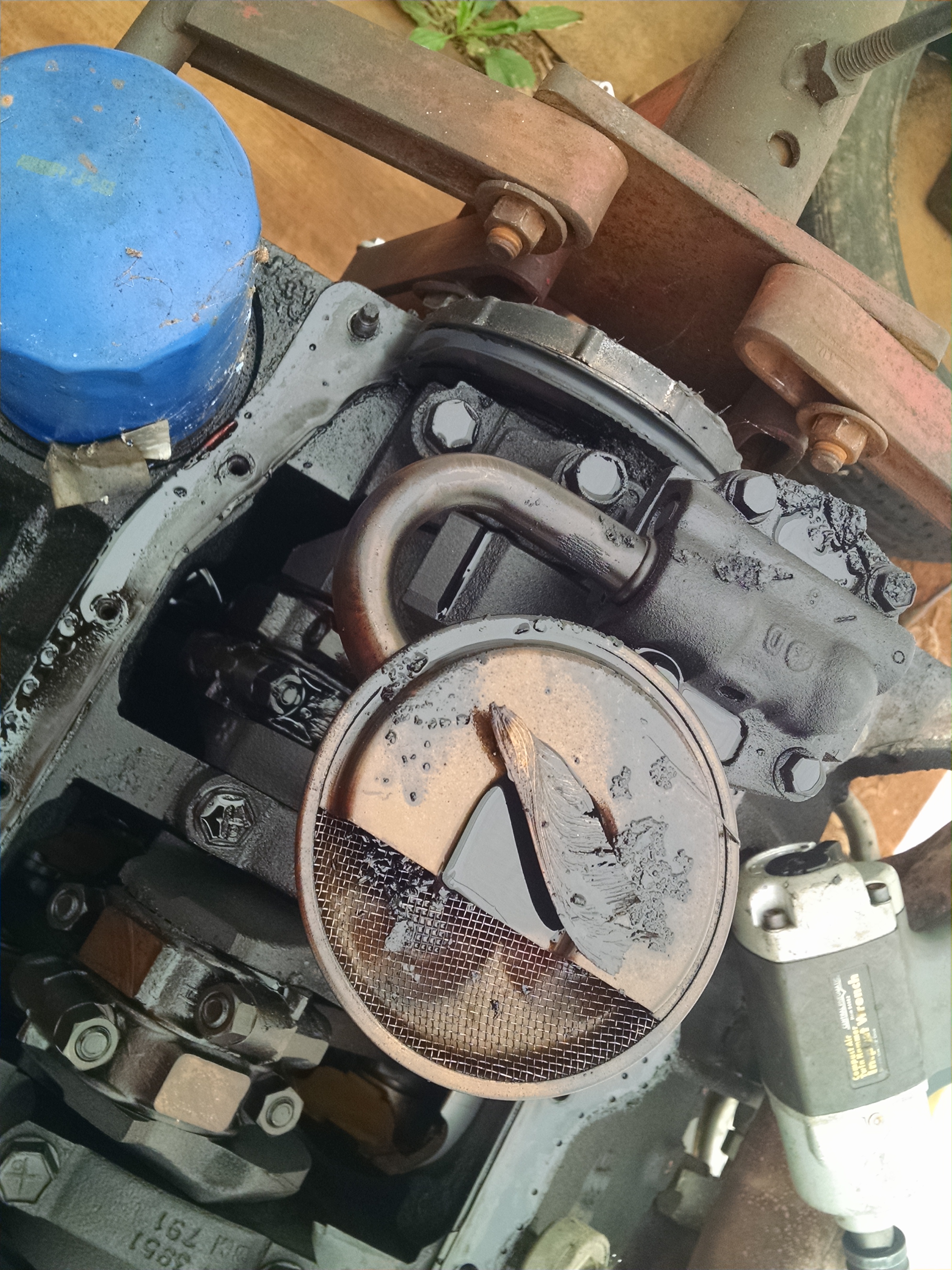

This is just one of the many maple tree helicopters that fell out of the bottom end when I pulled the oil pan off. The pan off the junk yard engine got dented. I also found oil bottle cap and foils in the valve covers. Small wonder it smoked. It had been starved for oil. I would imagine the genius that "fixed" the rear main seal with RTV did this to it.

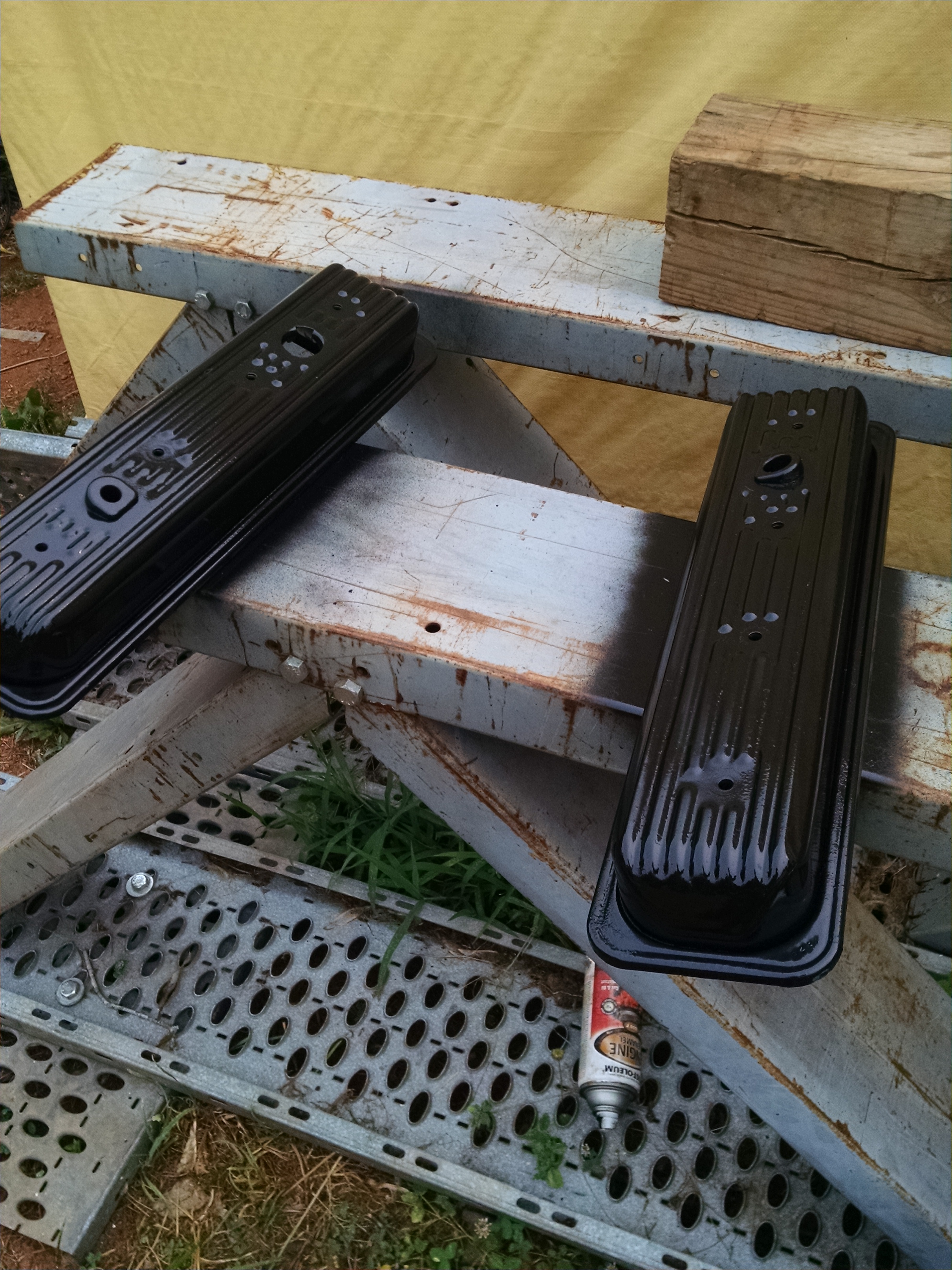

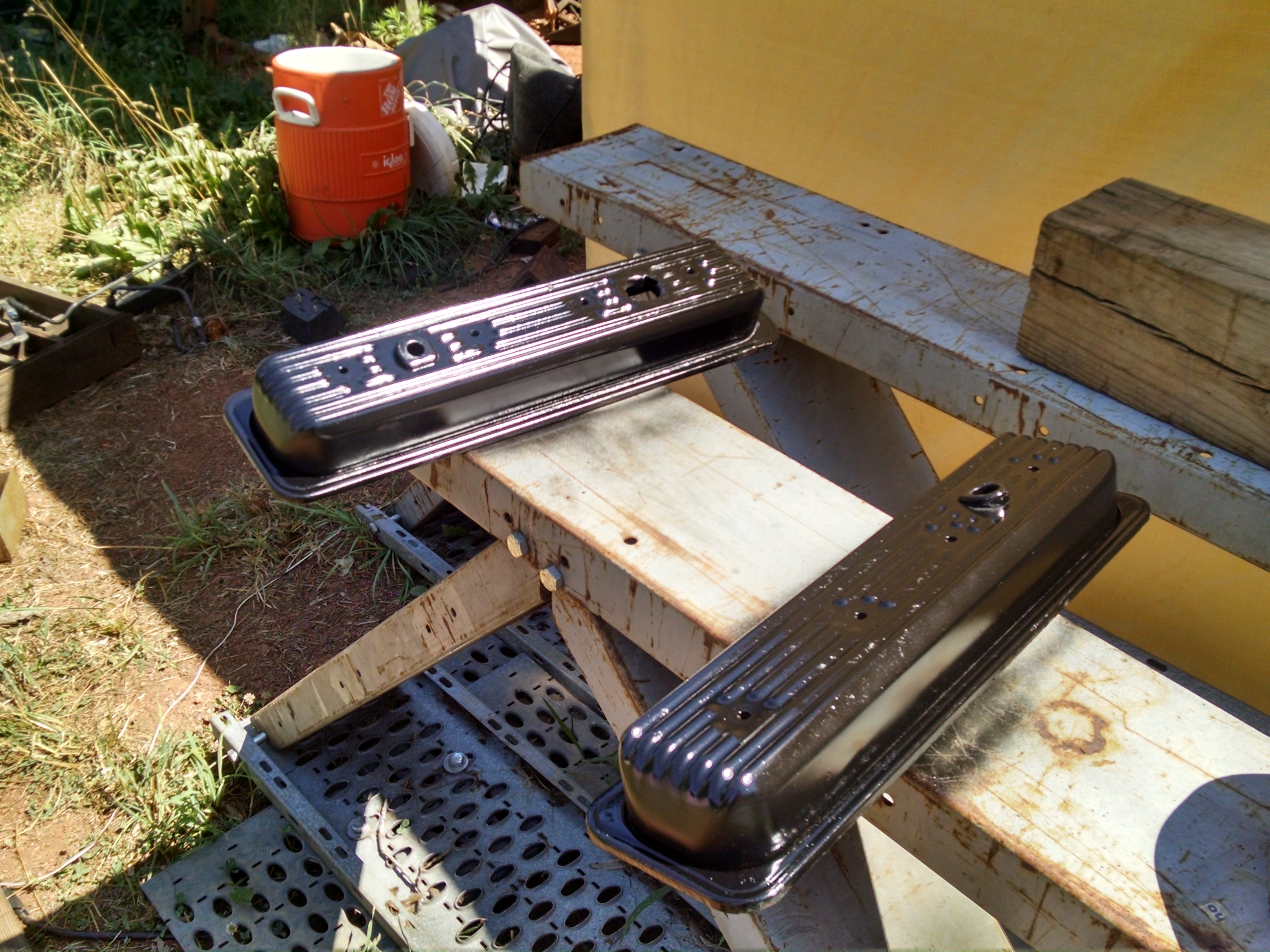

Painted the valve covers

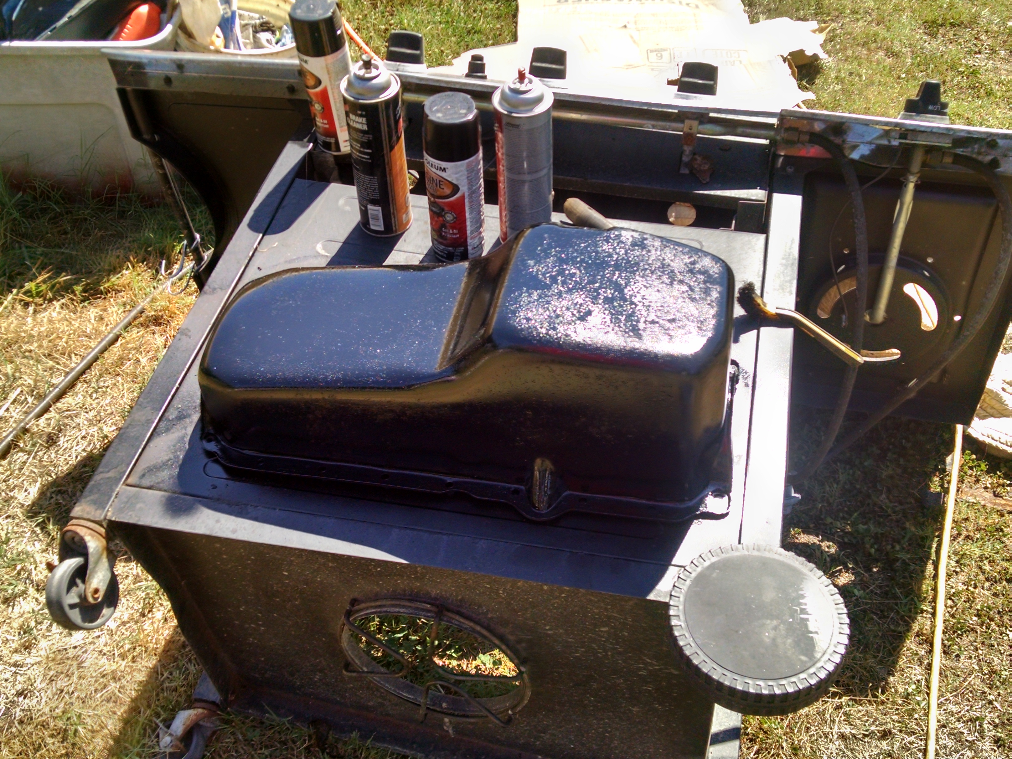

Shot the oil pan
I am not overly happy with how this came out. I may strip it down and do it again.

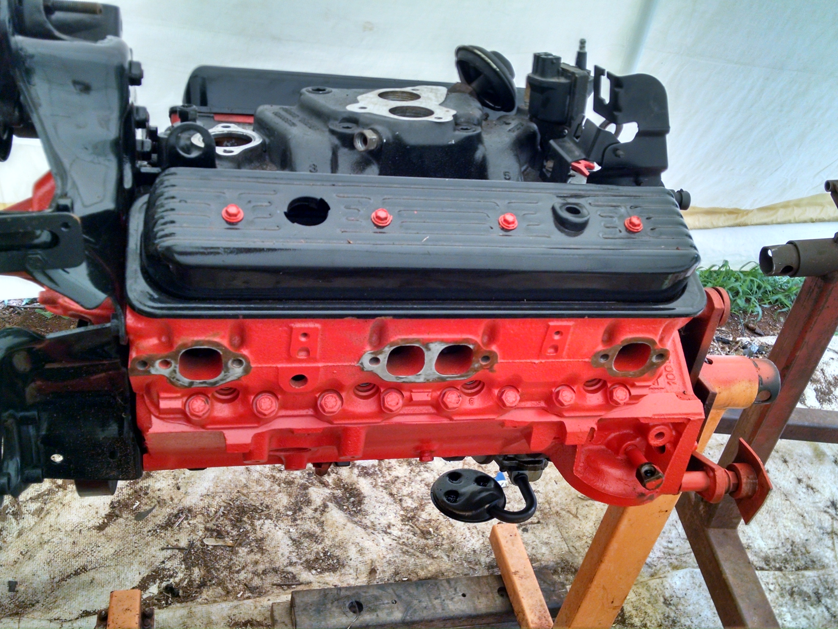

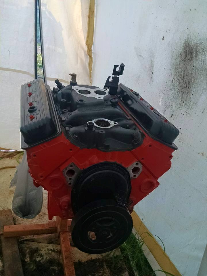

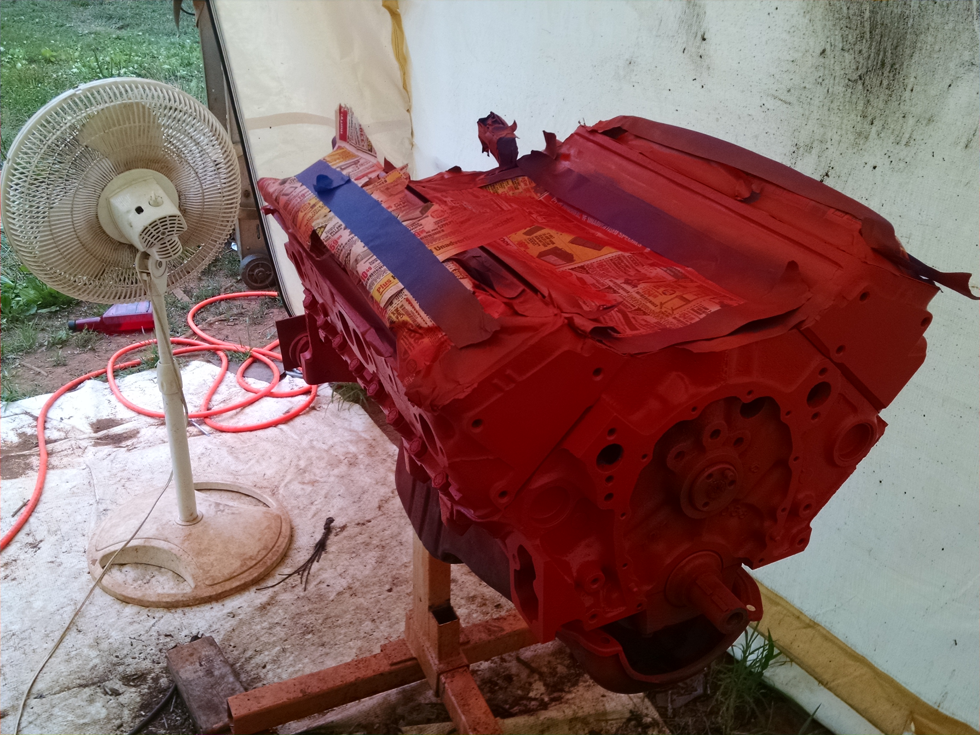

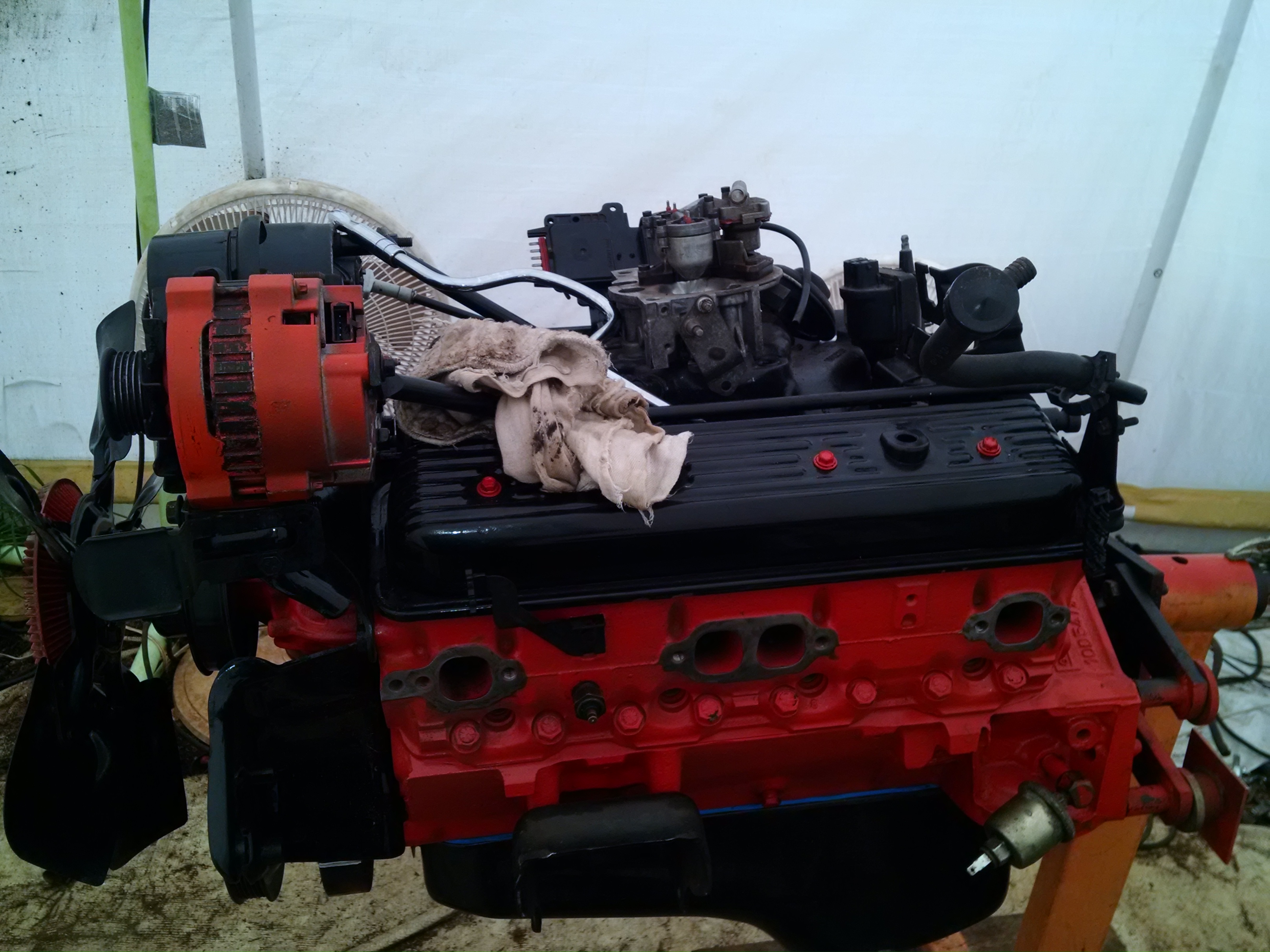

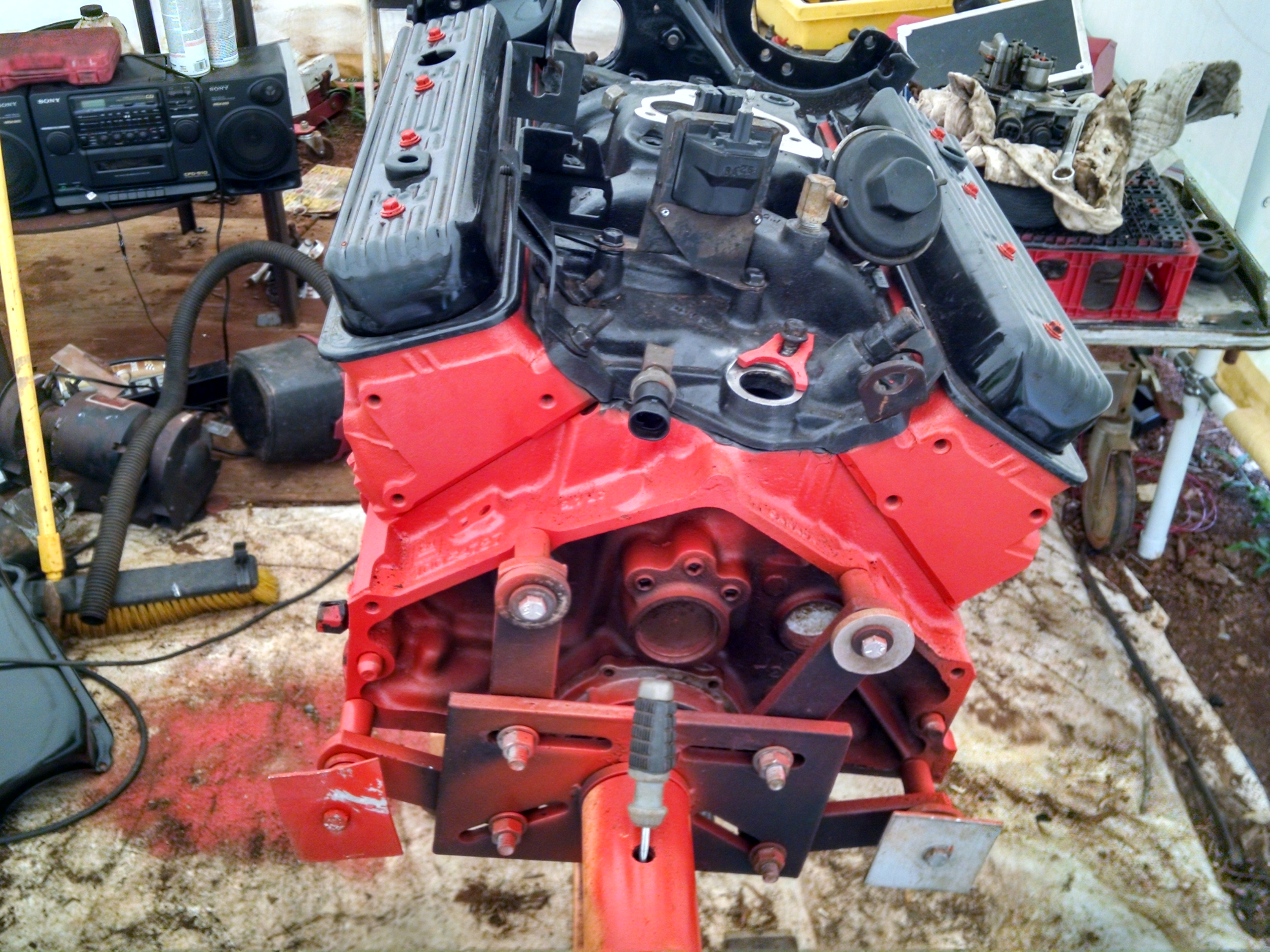

In between working on the wifes truck I managed to shoot a couple of coats of paint on the engine.
Even more Black paint
Orange paint!
Yes I panted over the gasket surfaces. I will be quicker to buzz it off with the scotch brite wheel than worry with the tape.

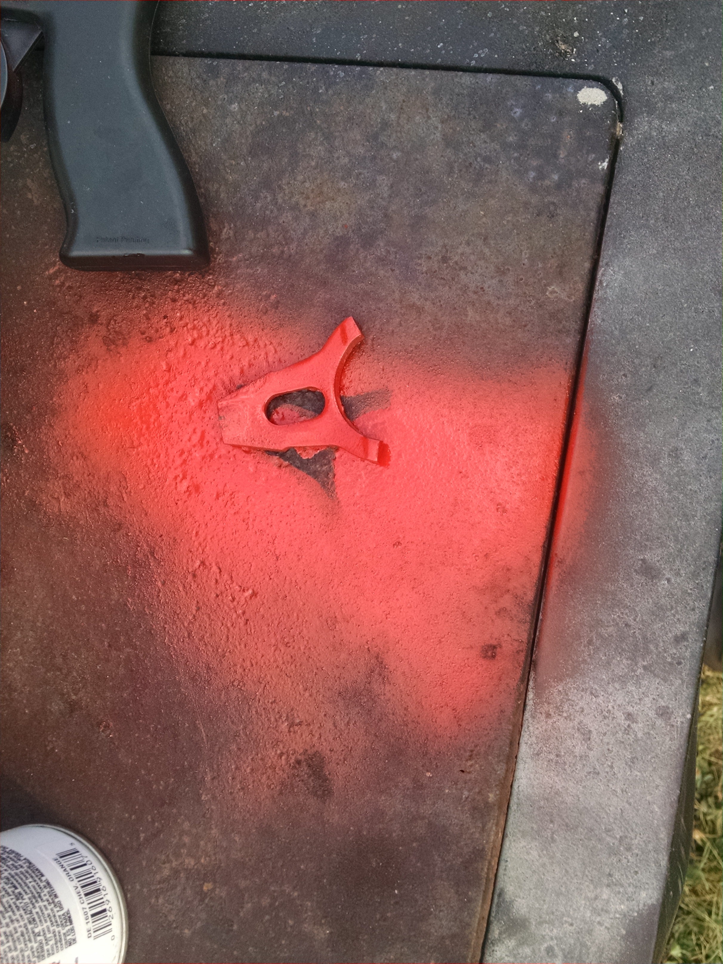

Even shot the magnet
Stupid thing keeps getting lost no matter where we put it. Should be a bit easier to find.

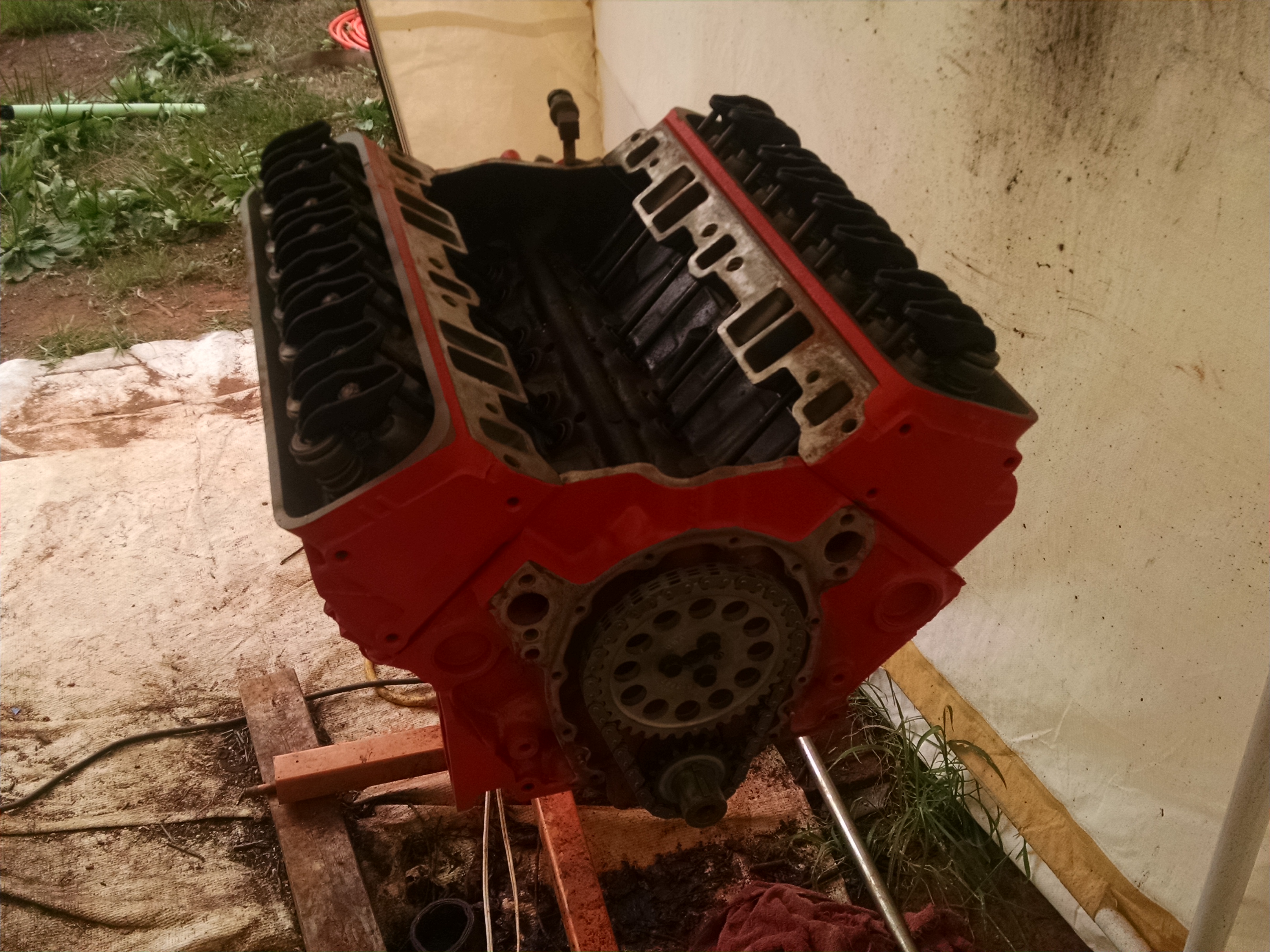

I flipped it over and installed the oil pump

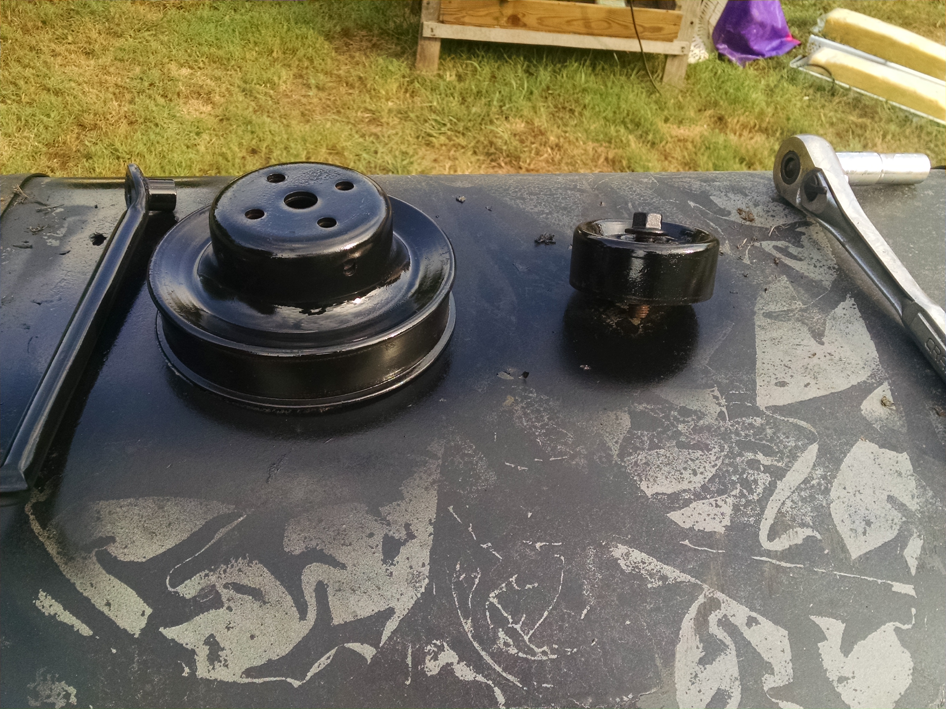

Then I needed the accessory drive off the old engine.

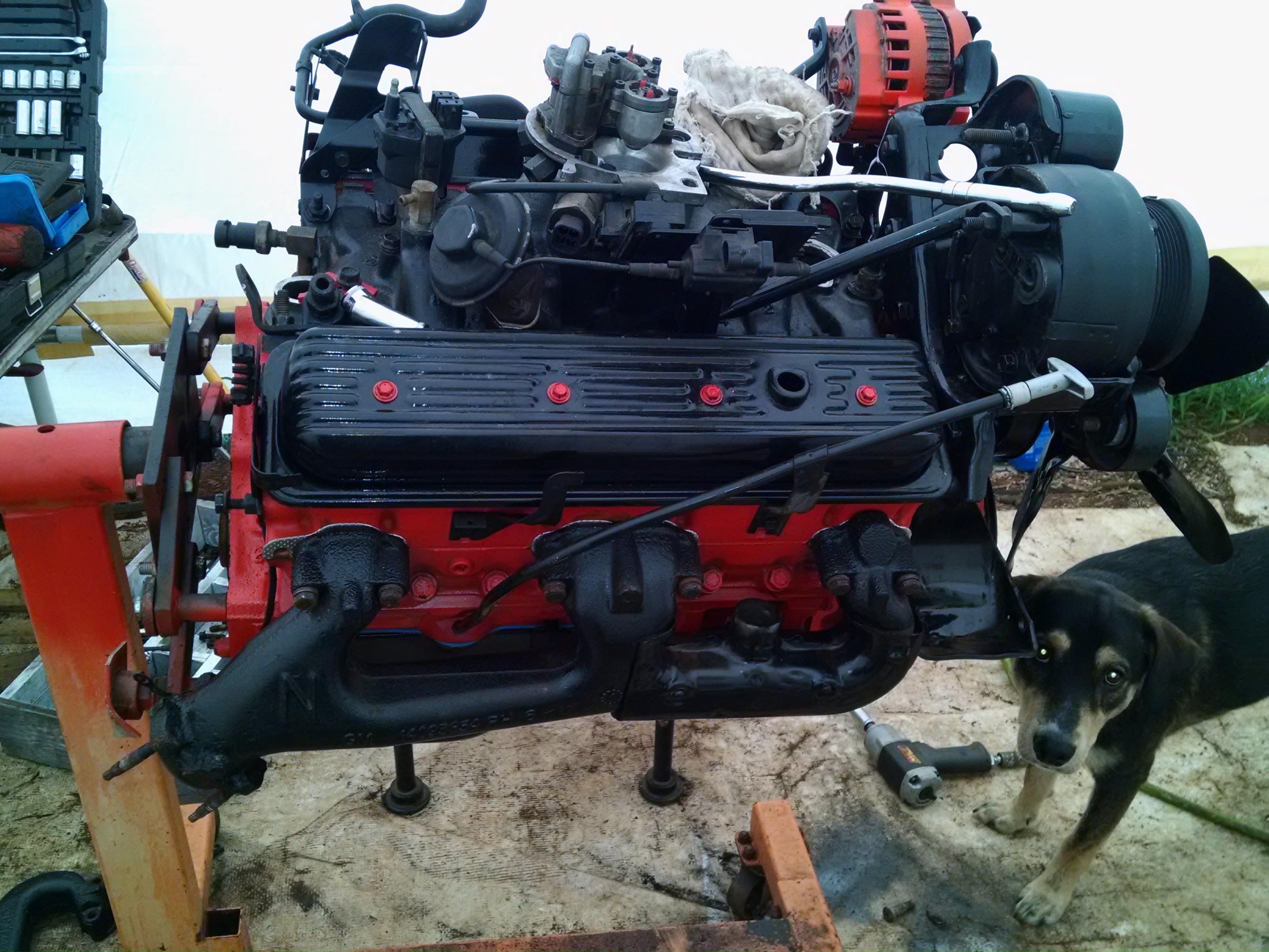

Black is beautiful

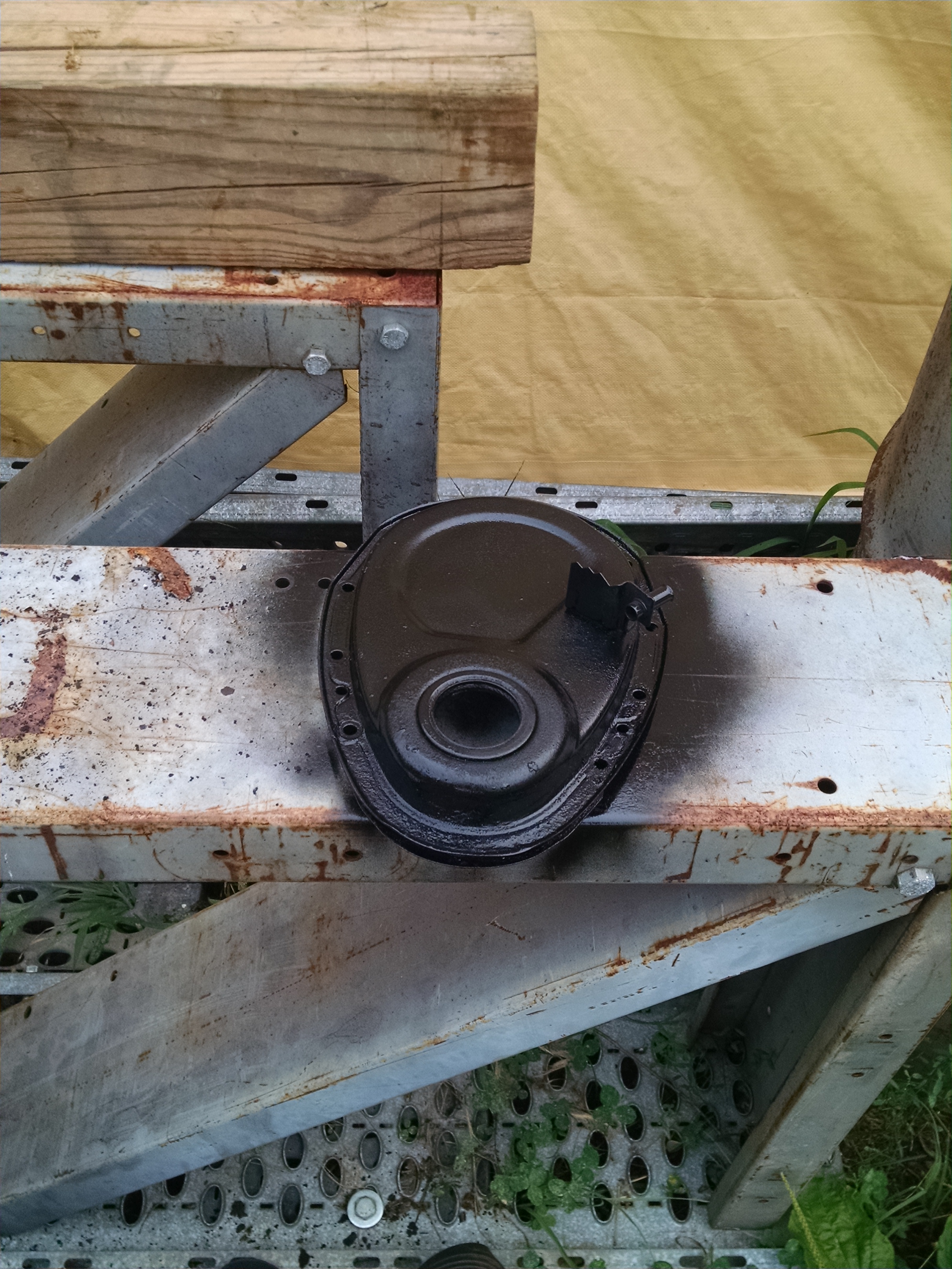

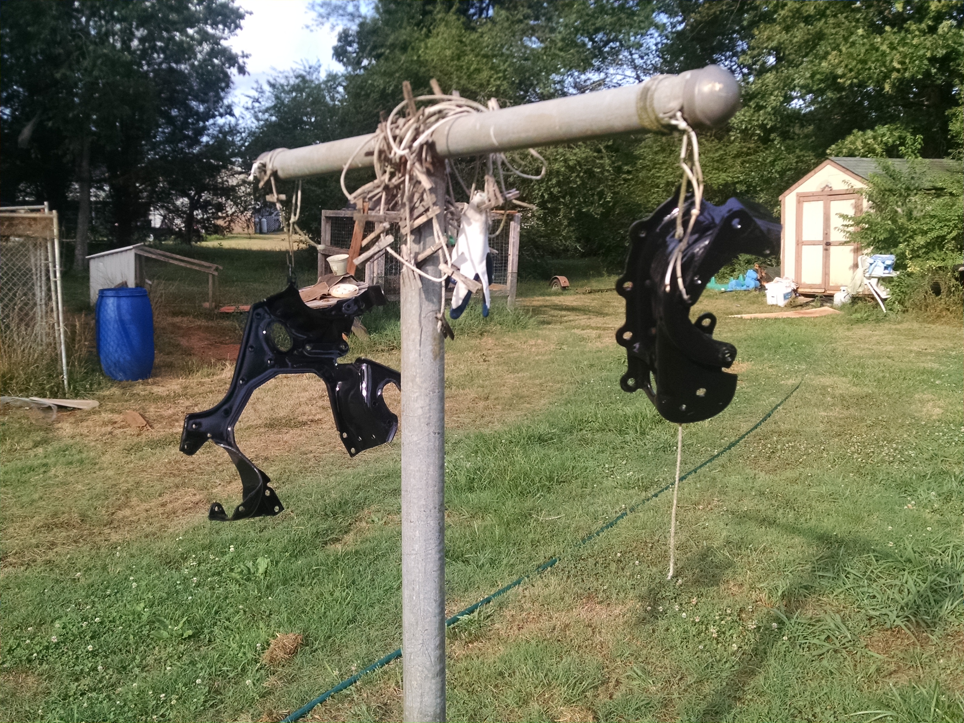

Painted the Exhaust
Putting the lineless clothes line to use

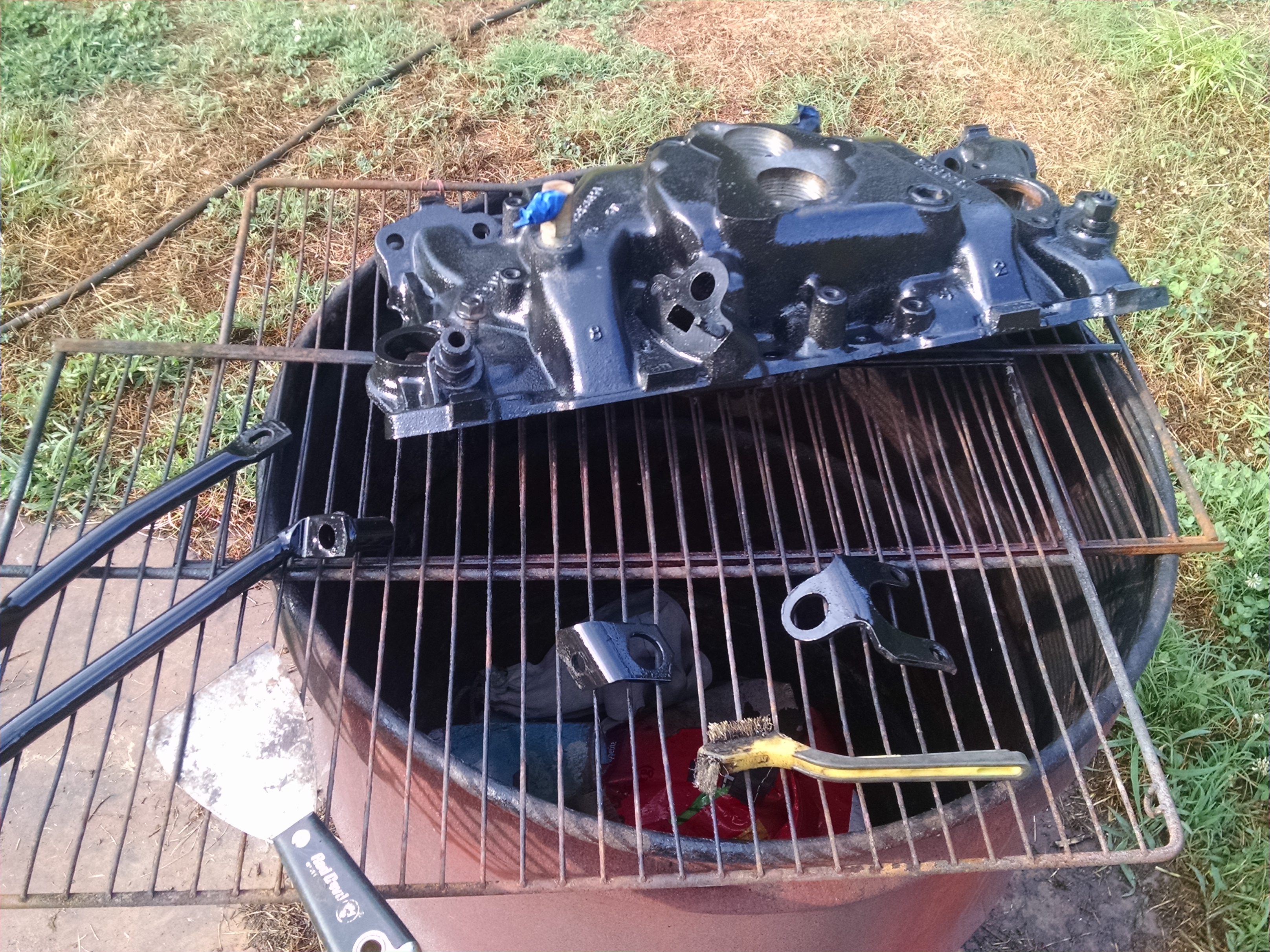

Intake and other parts clean and painted

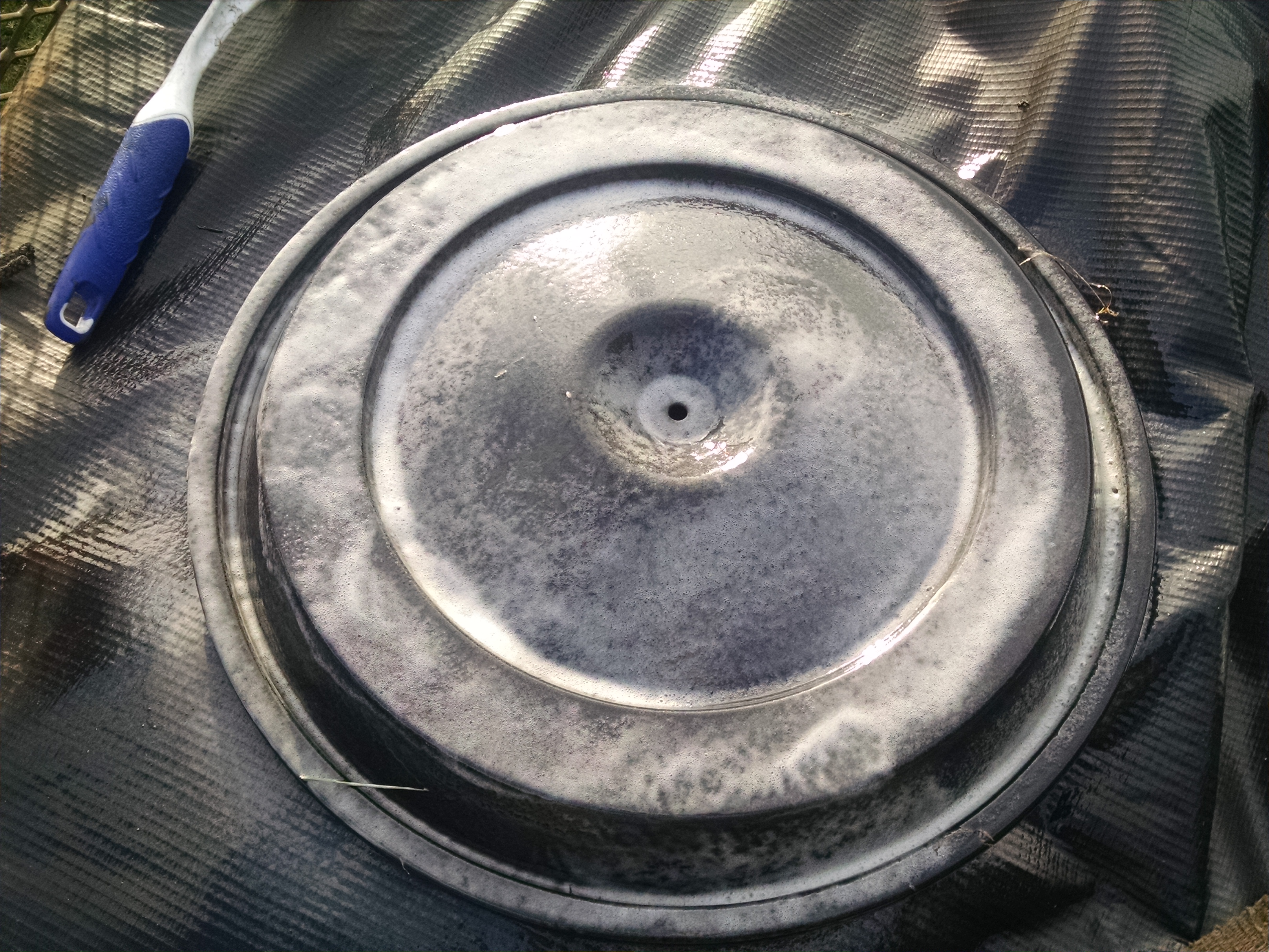

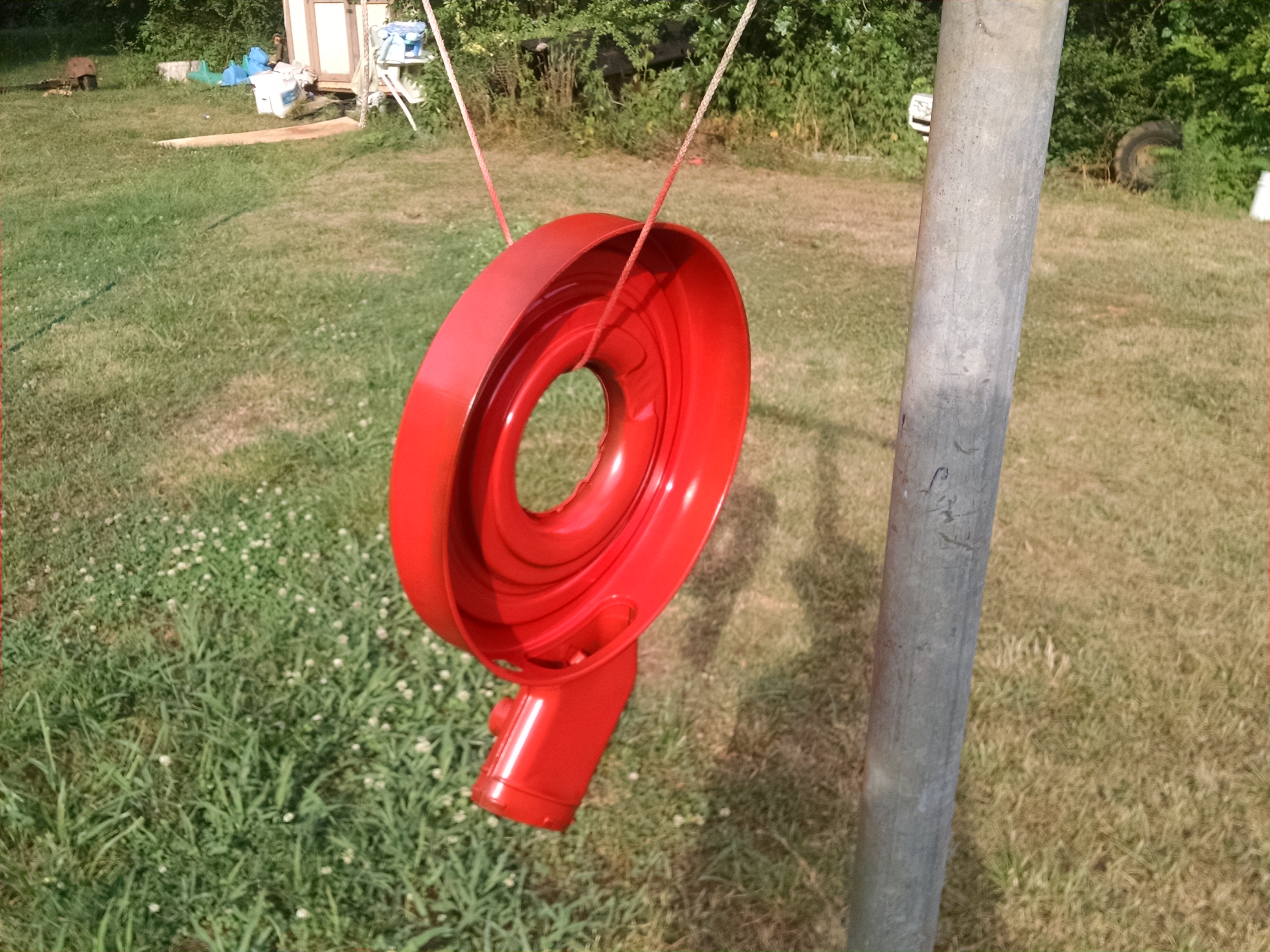

When I started to paint the lid it fell into the grass. I hosed it down with oven cleaner to strip it again.

Painted the Exhaust

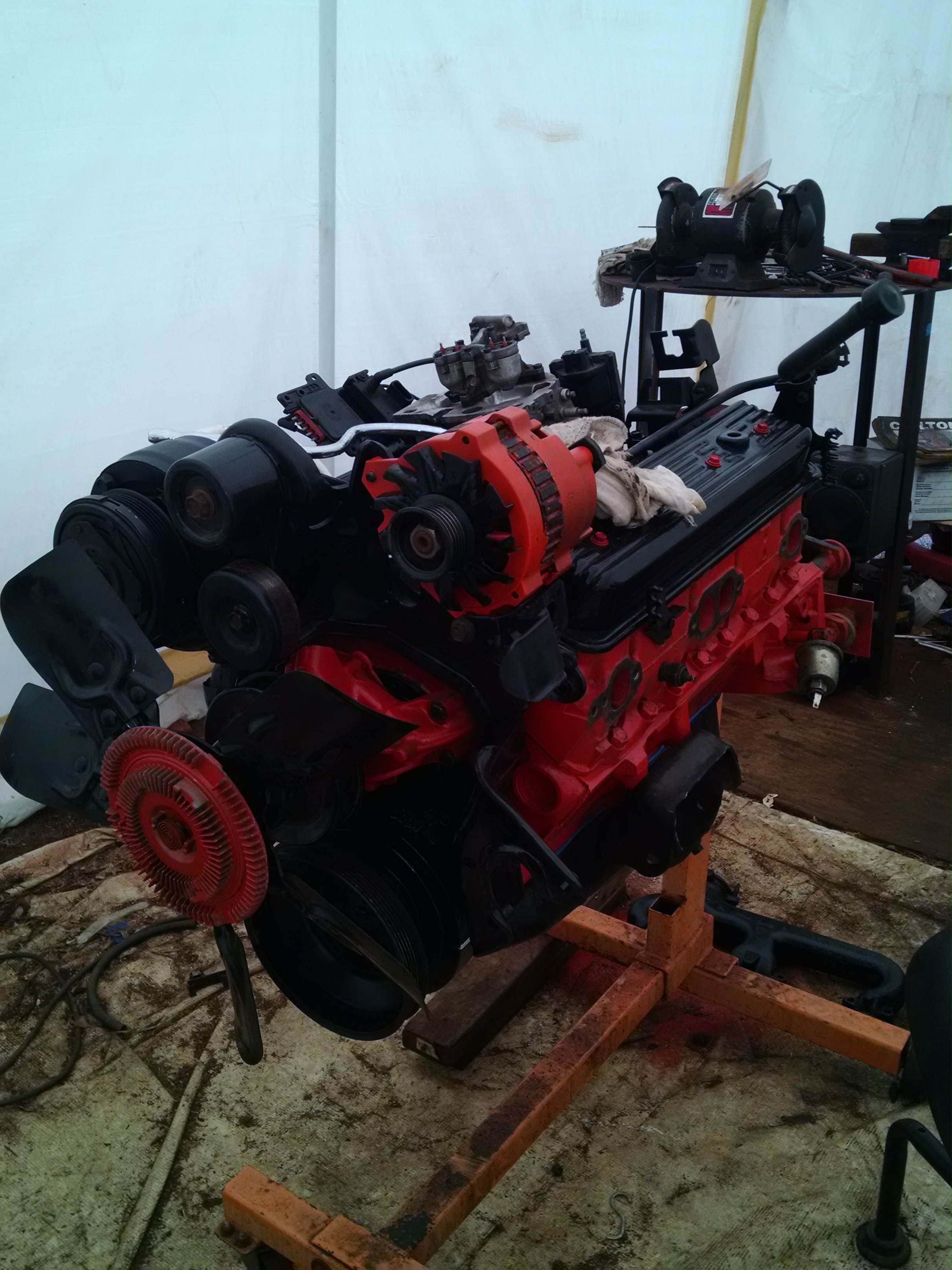

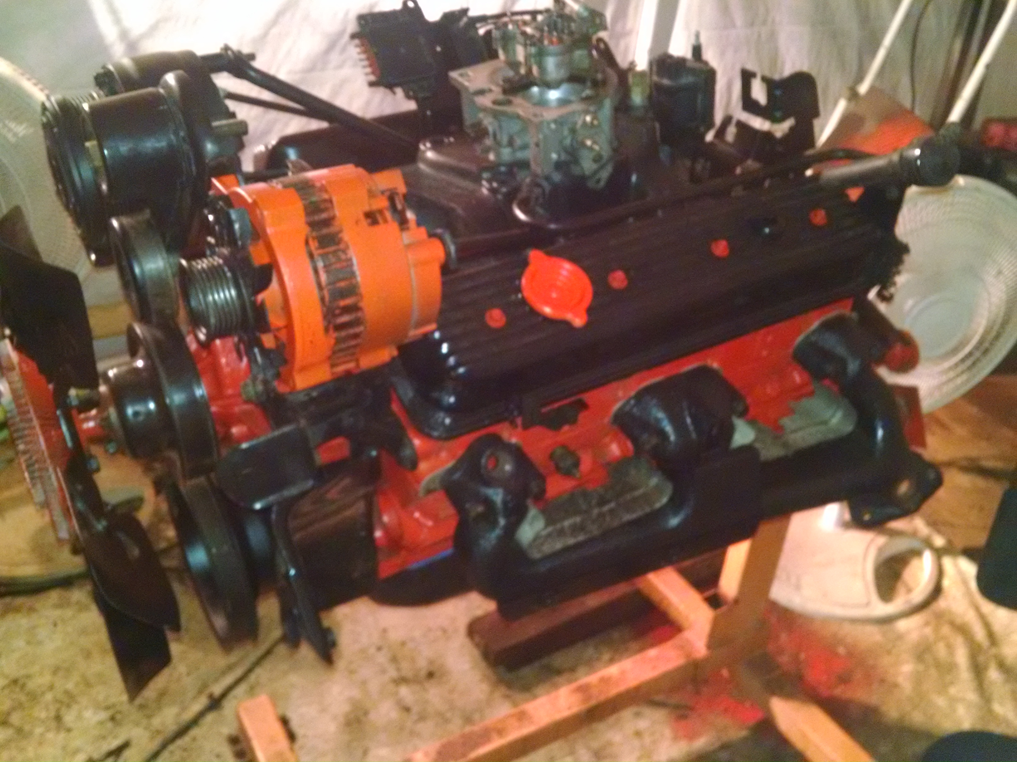

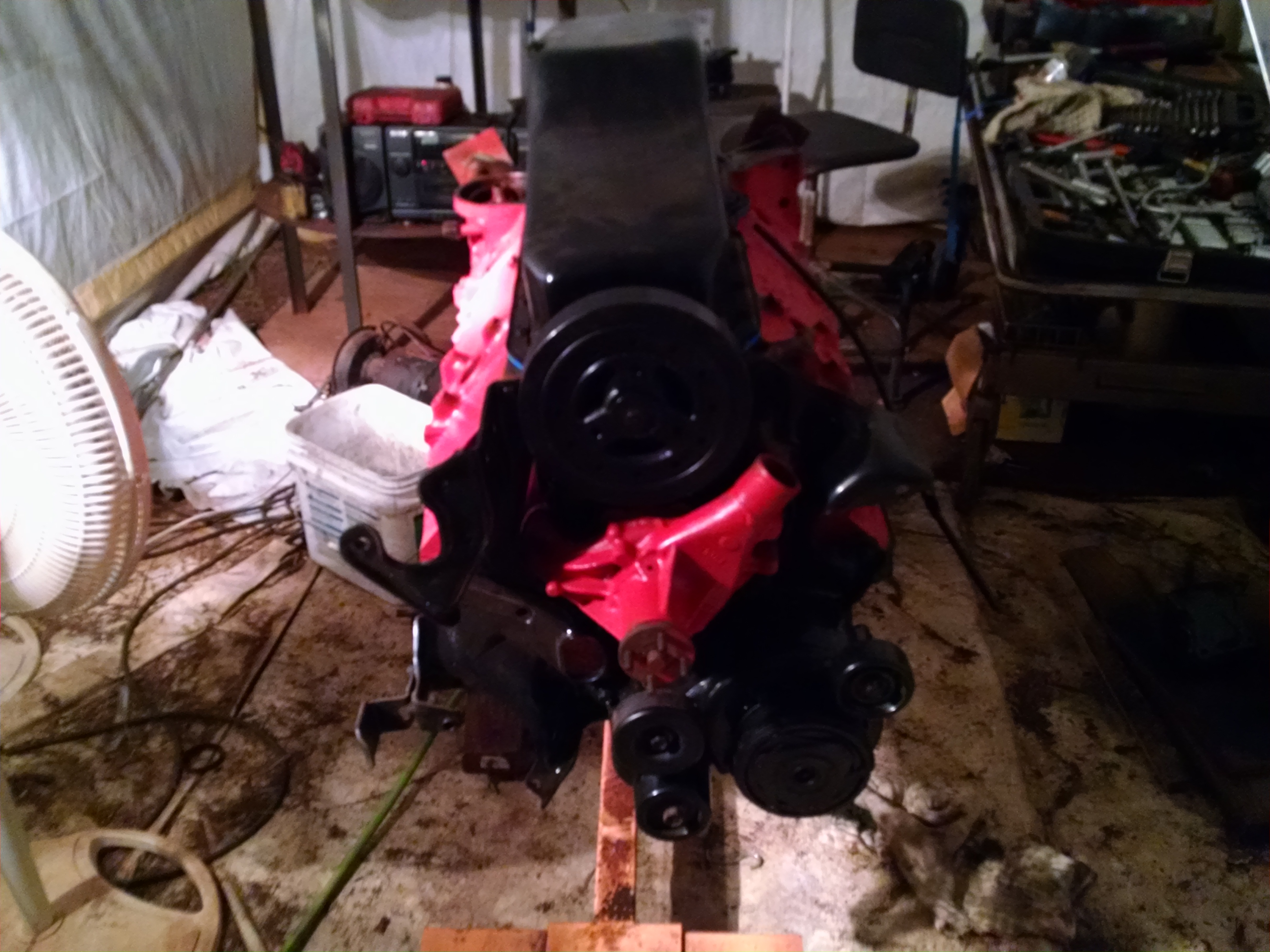

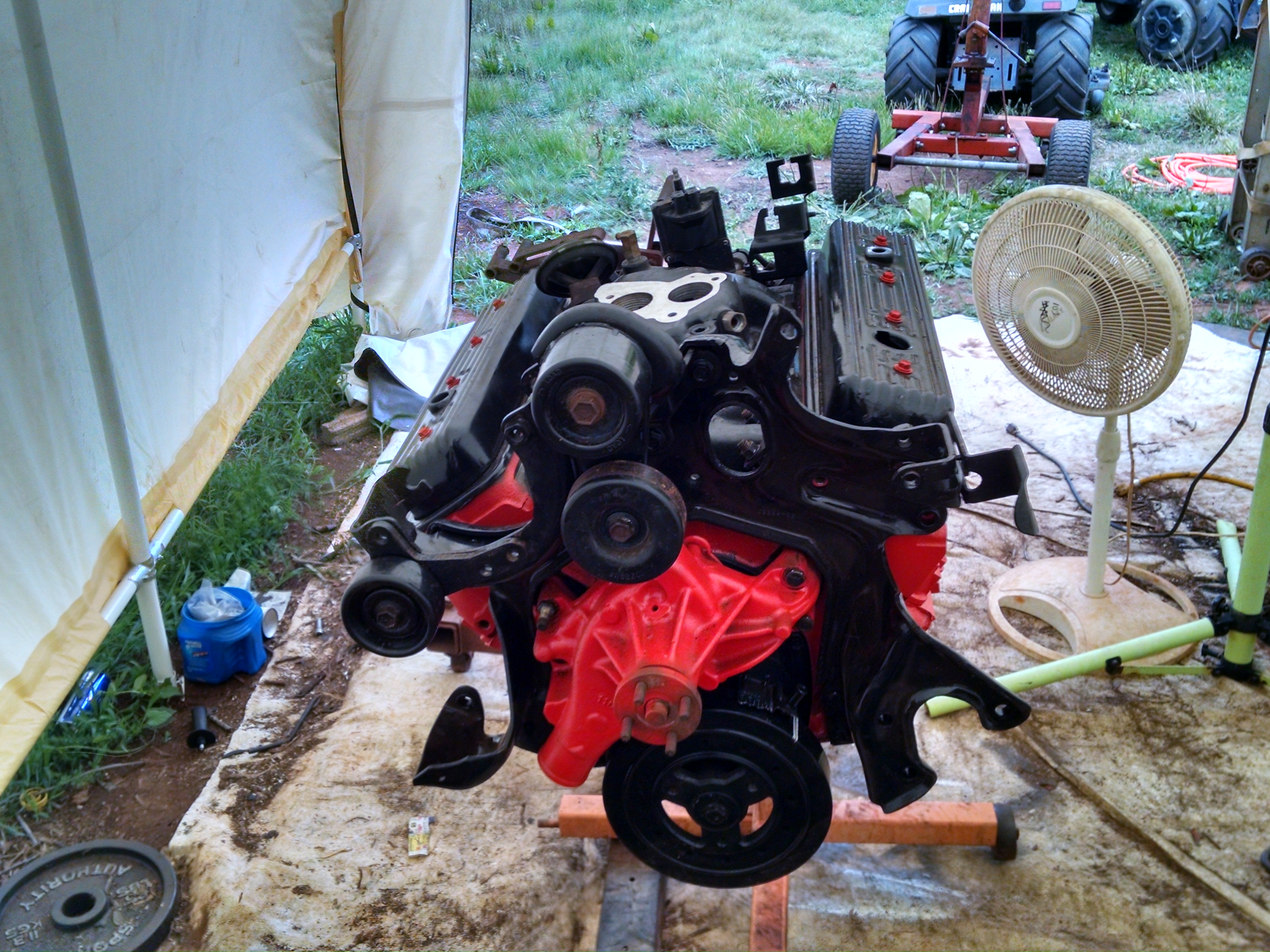

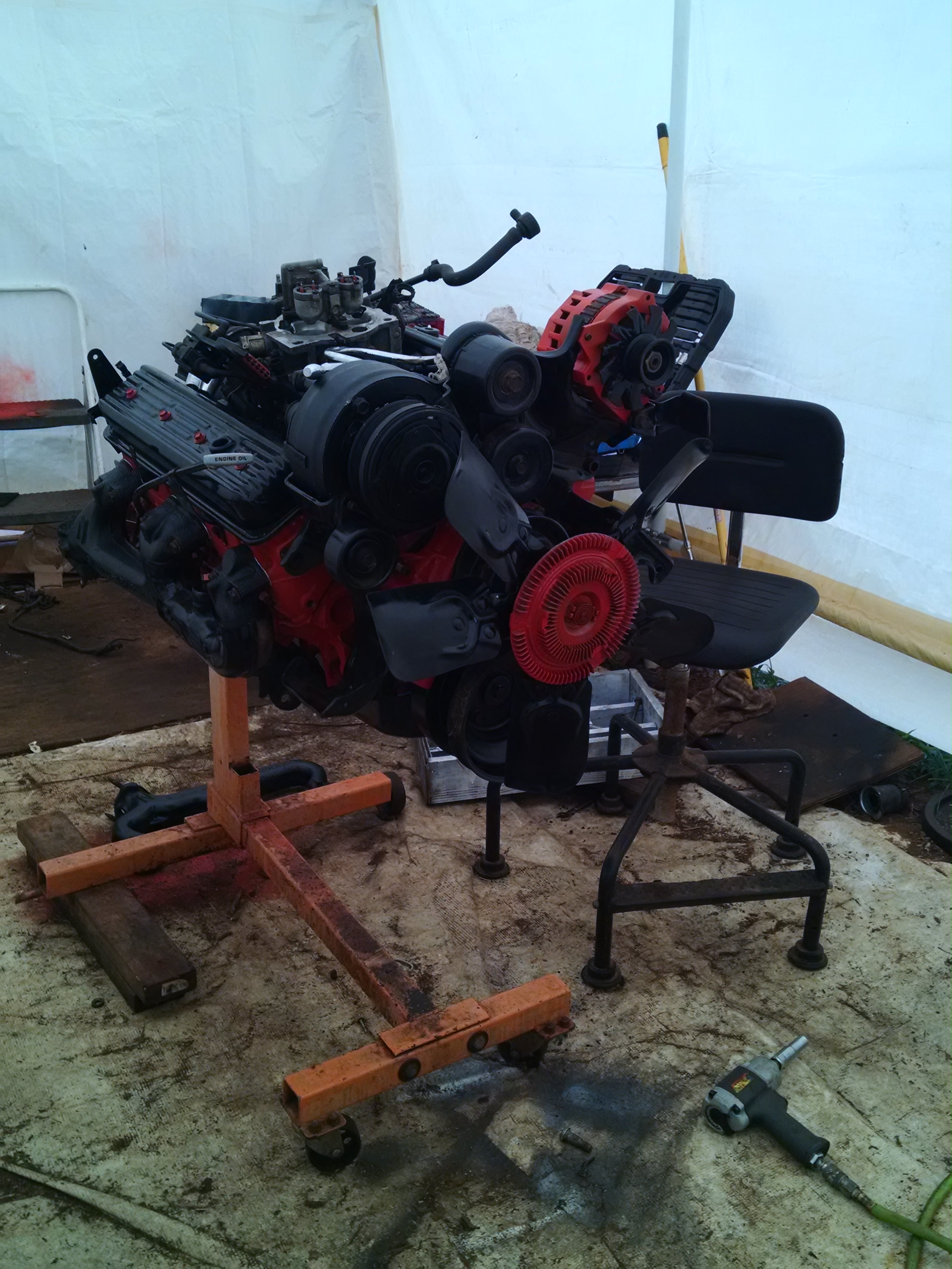

Looks like an engine
I wrenched my back trying to rotate the full dressed 350 on the stand. I also had Carpal Tunnel surgery so thing have been slow. Today I hobbled around like the hunchback of Notre Dame. Adjusted valves, and installed timing cover, harmonic balance, intake, and valve covers. The gasket set I bought was the only one in stock and it was opened. They marked it on the receipt, Discovered a missing EGR gasket today. I was hurting so it was time to stop anyhow. Wife ran down to get the gasket.
Spooky

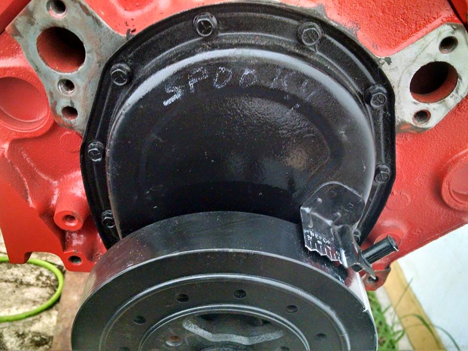

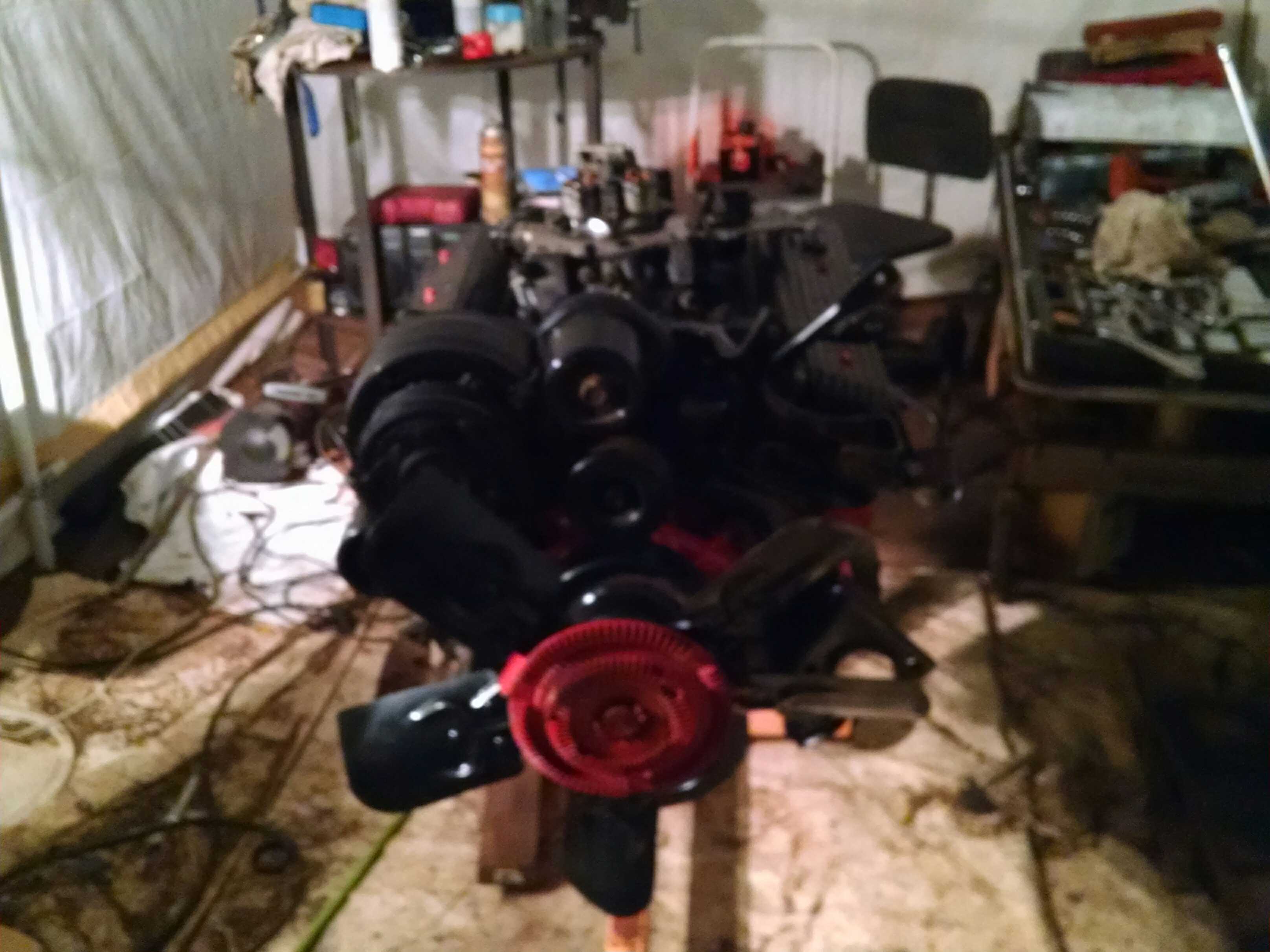

Finally the truck has a name, The wife said the black and orange looked like halloween. You can also barely see where I made the timing marks more visible with white paint. I painted over it with a white paint pen then gently wiped it off so it left paint in the letters. Spooky is barley visable in person.

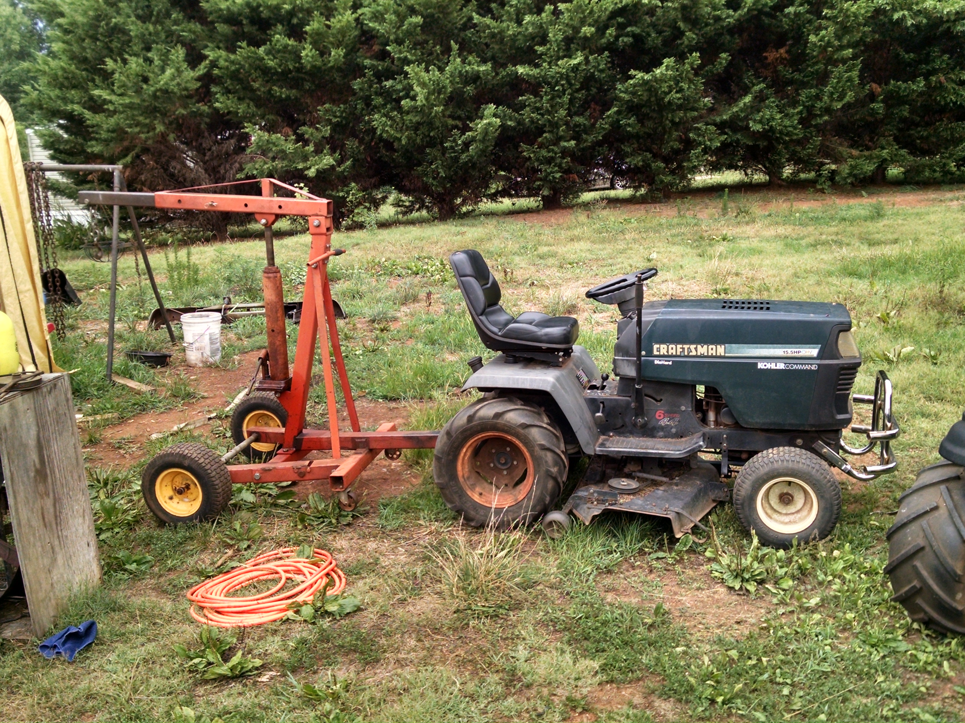

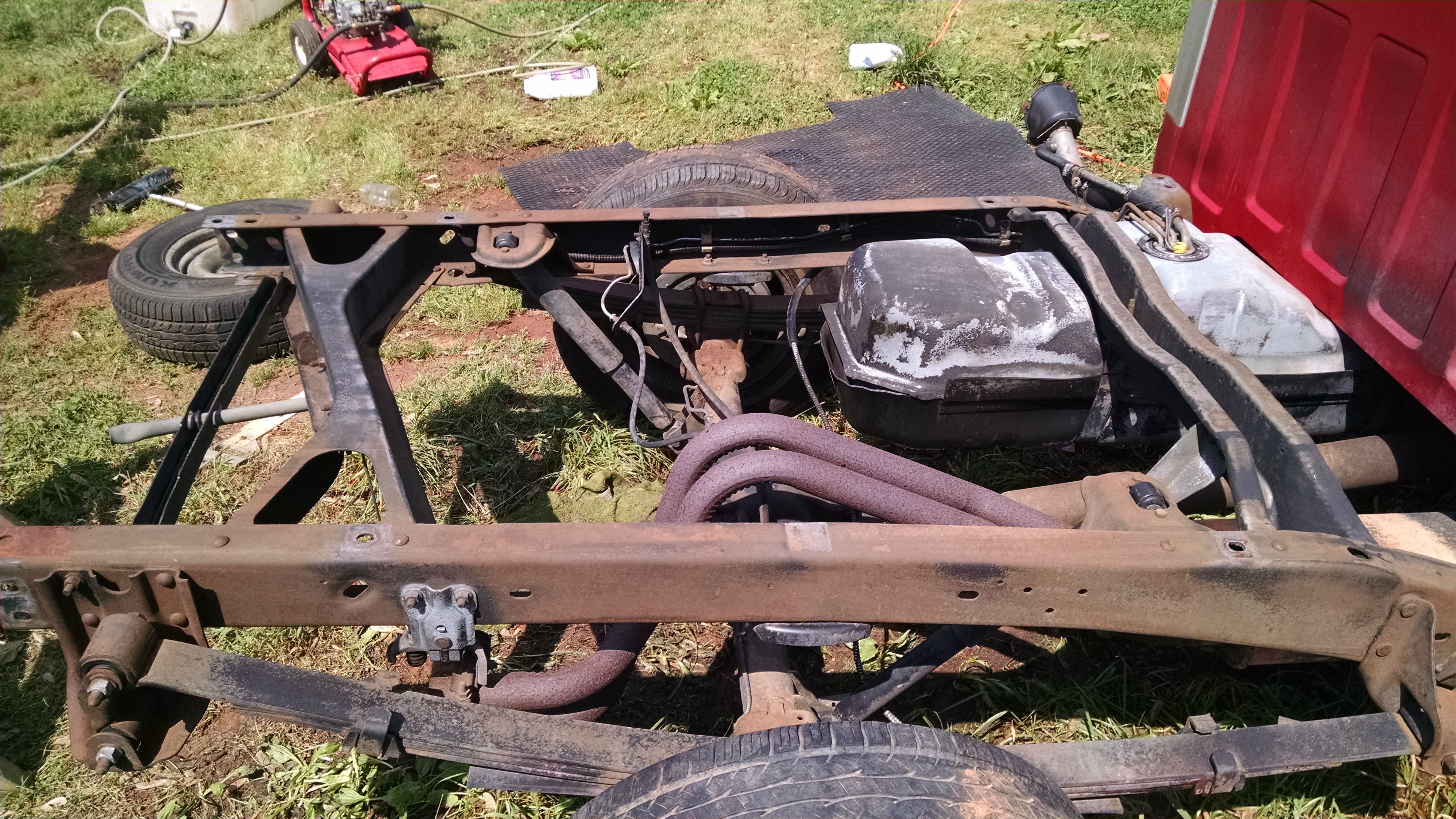

Moving day.
I hooked the mobile crane to the Falcon and moved the bad engine out. I have taken all the parts off of it that I am going to. Then I moved Spooky (LOL) over to the middle where it is easier to work on. Less clutter in the tent now.

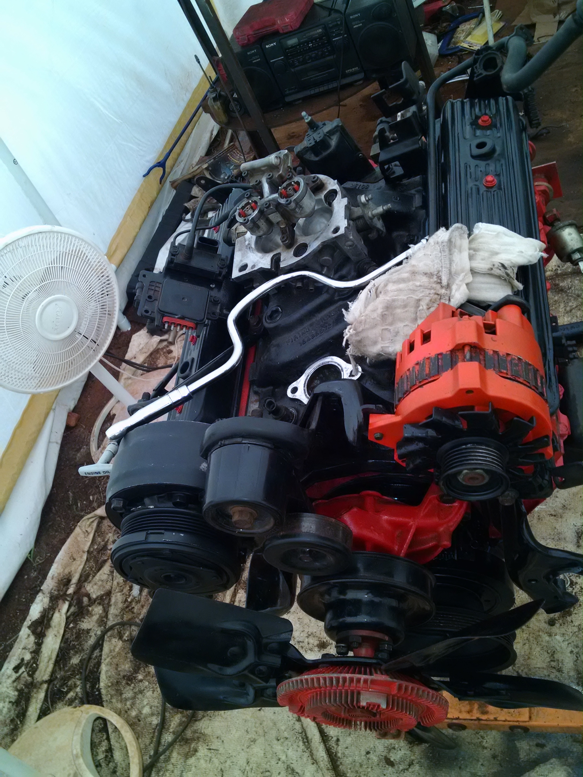

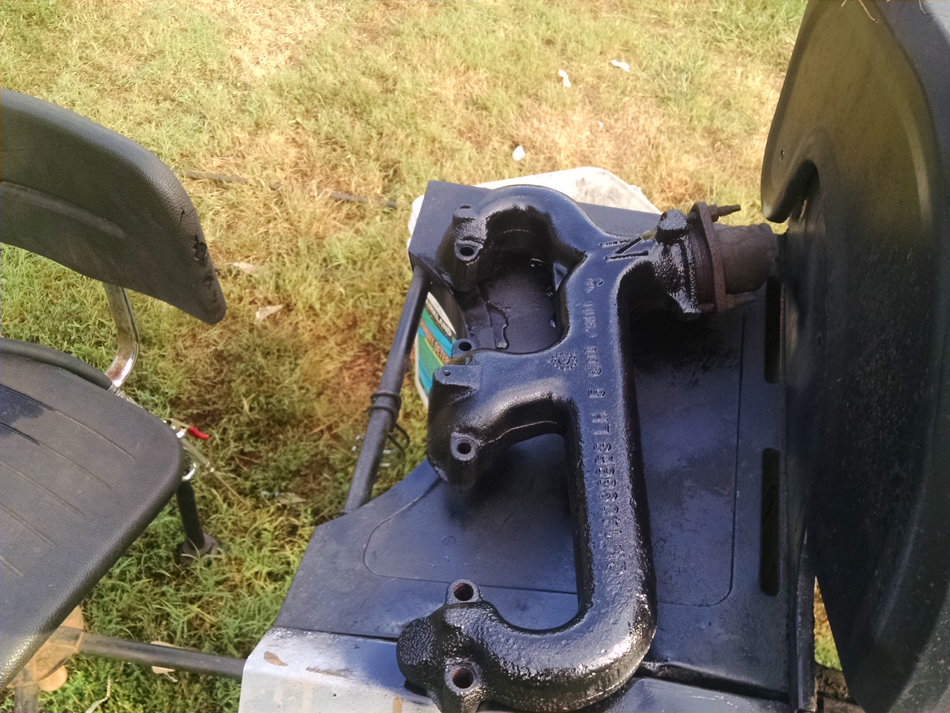

No Exhaust manifold
This engine came out of a van. I didn't realize the difference in the manifolds until I had them both on and the one of the drivers side was a good 8 inches in front of the passengers side. Since the original engine was smogged I had to fight the smog line out of the manifold and I will go find the right sized plug for it. It appears the passengers side is identical except for the bung for the smog line.

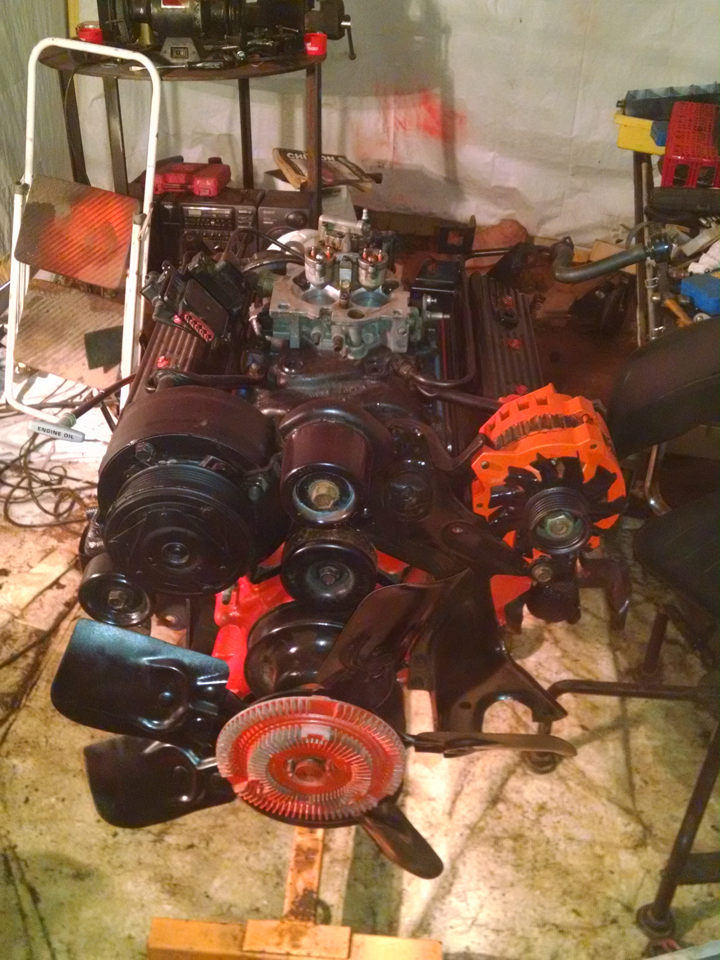

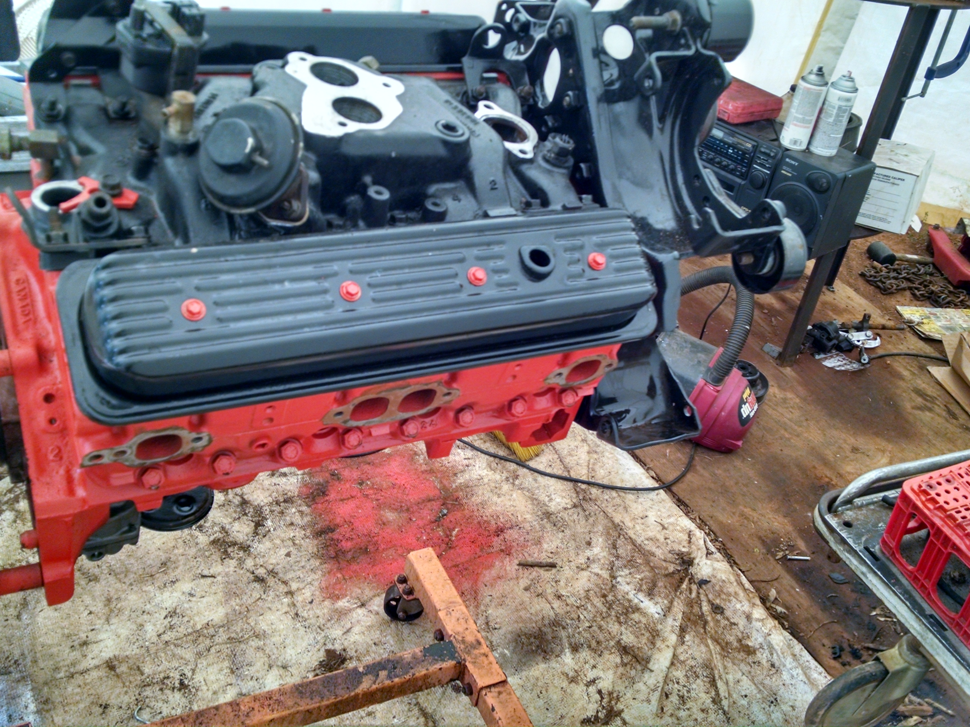

Alternator will look better in a while. I put Vaseline over the black. It will wash off and look better.
More stuff on.
I like to have never figured out how those stupid sensors went on the bracket. I played with it for about 30 minutes. Finally I found one picture in the Haynes manual that happened to have the sensors in it.

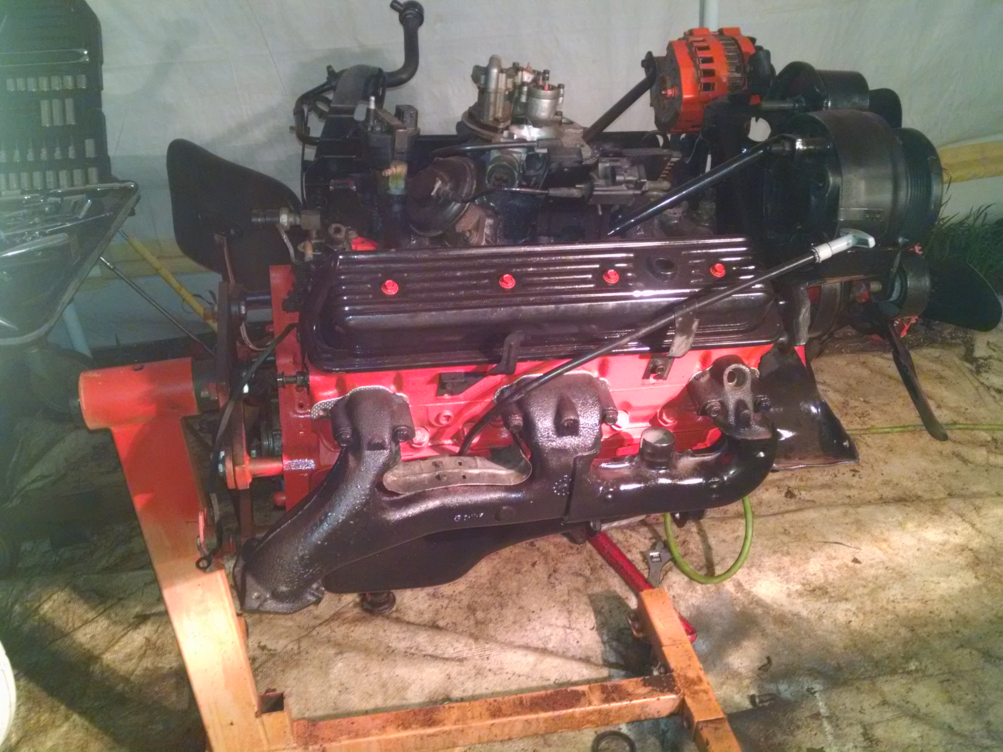

Passengers side all dressed up.

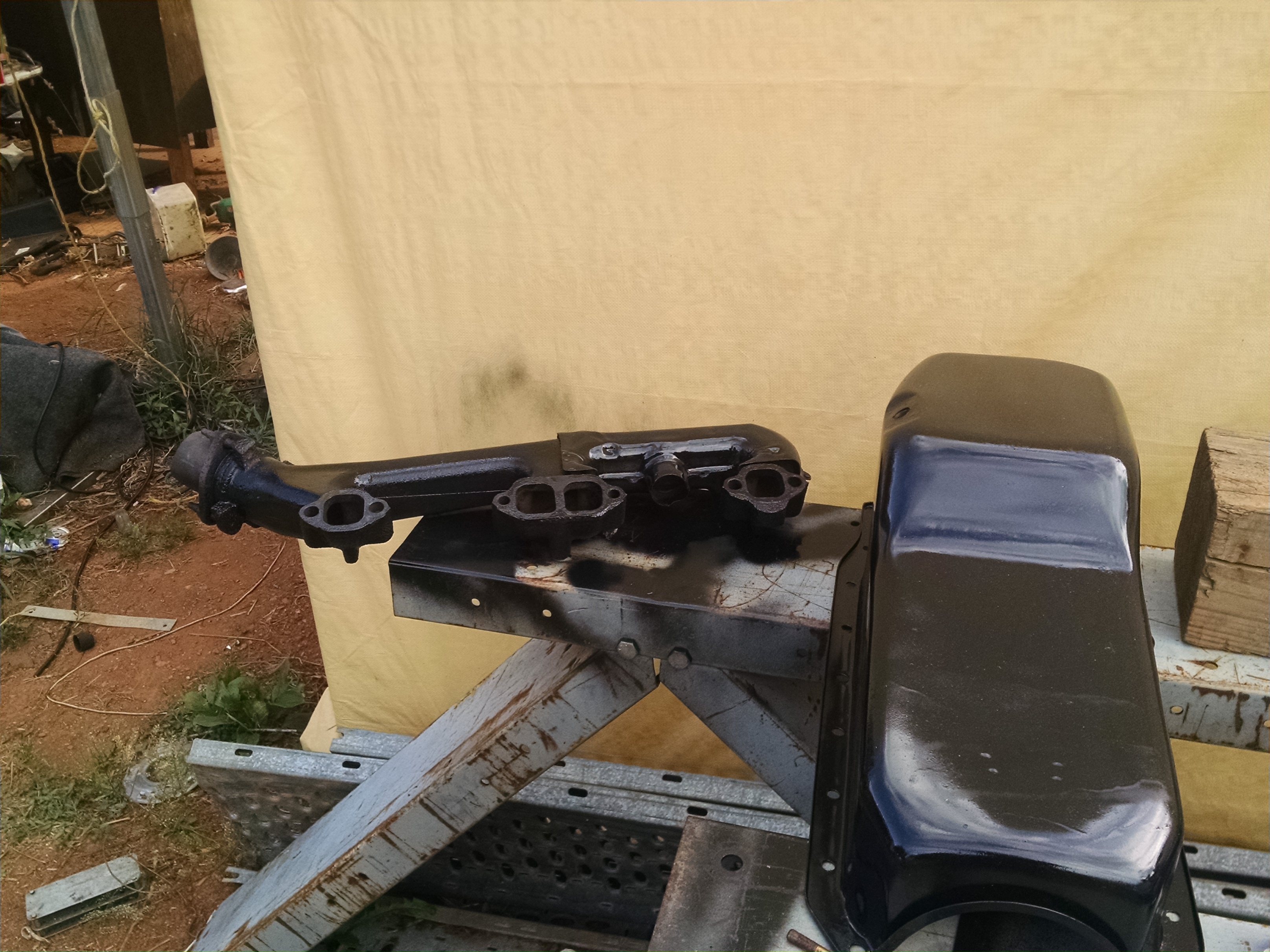

The original manifold was nasty ( and the other side was already painted) so I painted it. I will get it on later tonight.

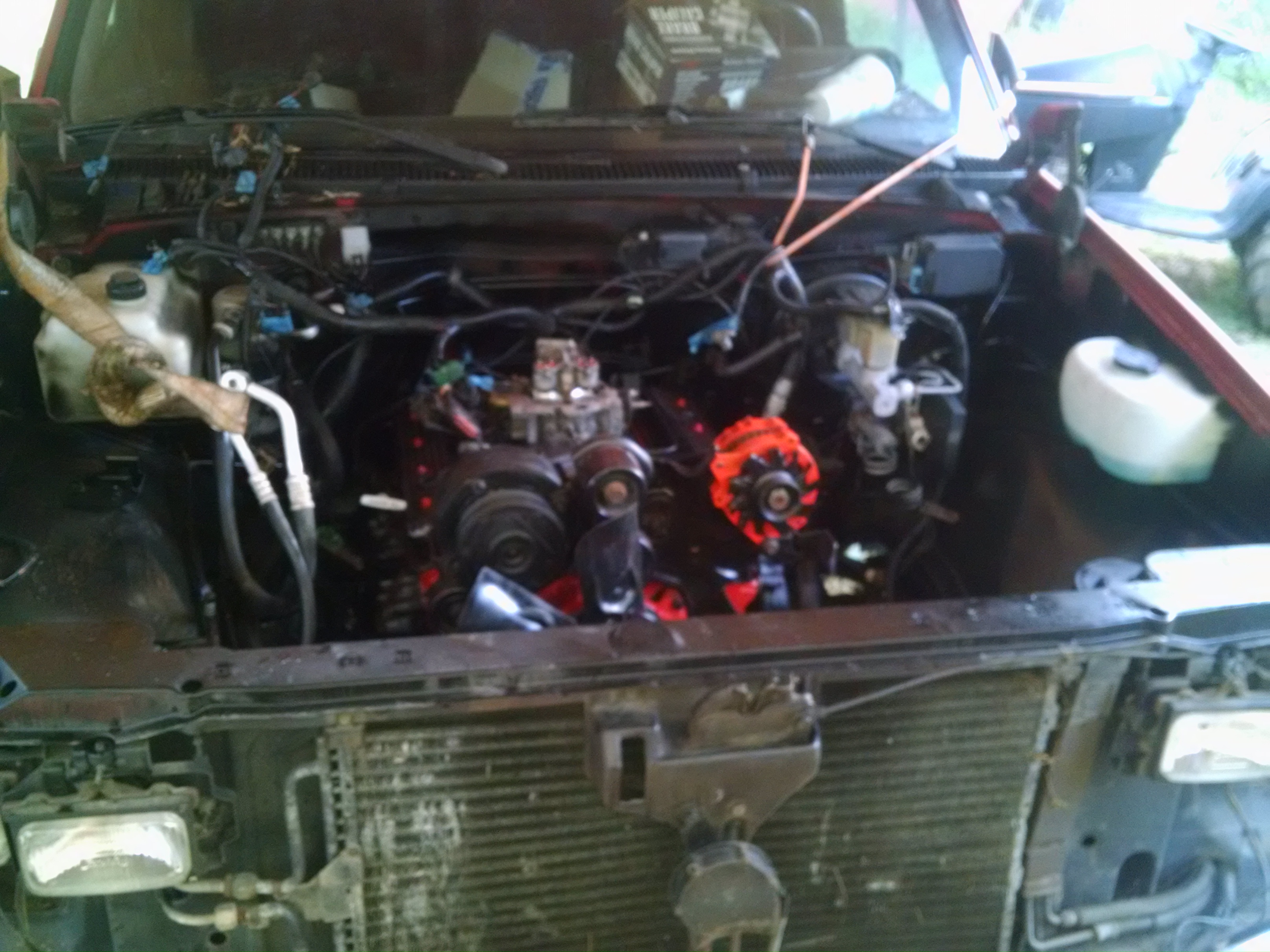

Progress.

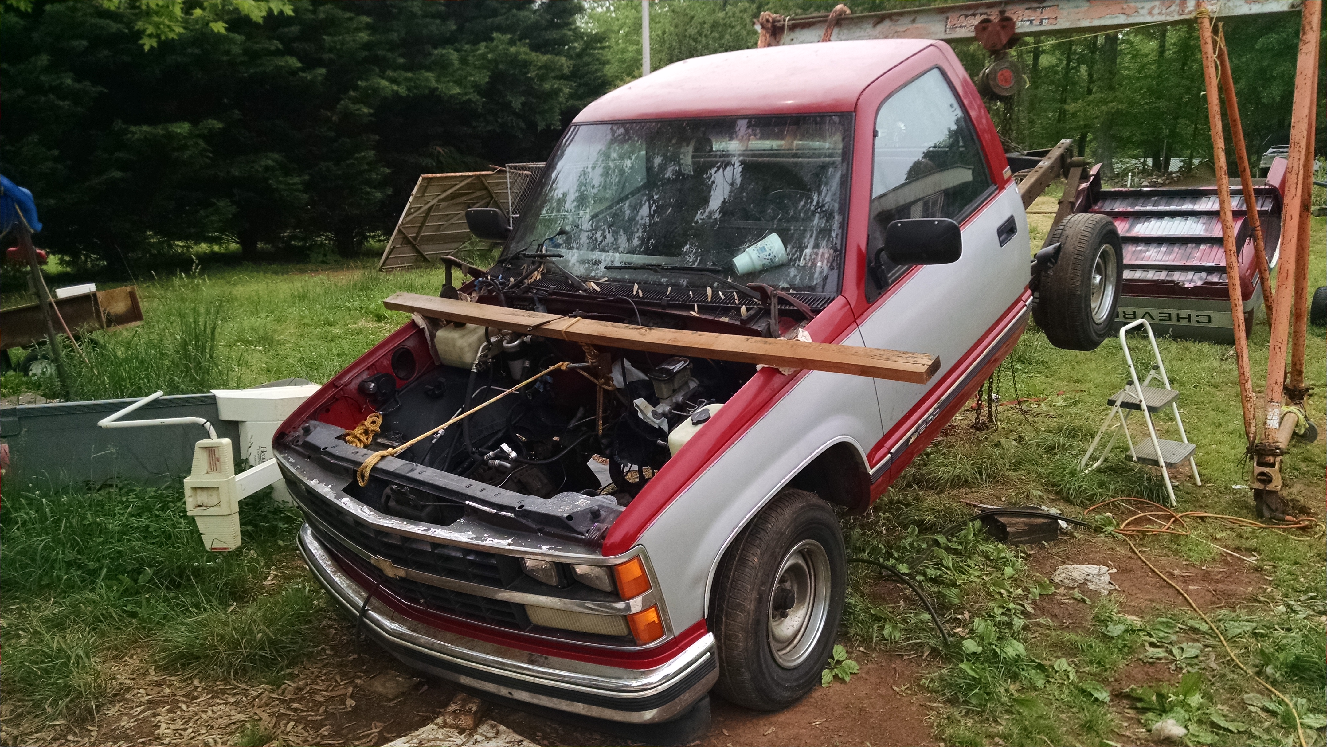

After taking care of a few housekeeping items today we got the engine dropped in the truck. Also put the Torque converter back in. All I lack now is finishing.
Lowered the pop up canopy and called it a night.

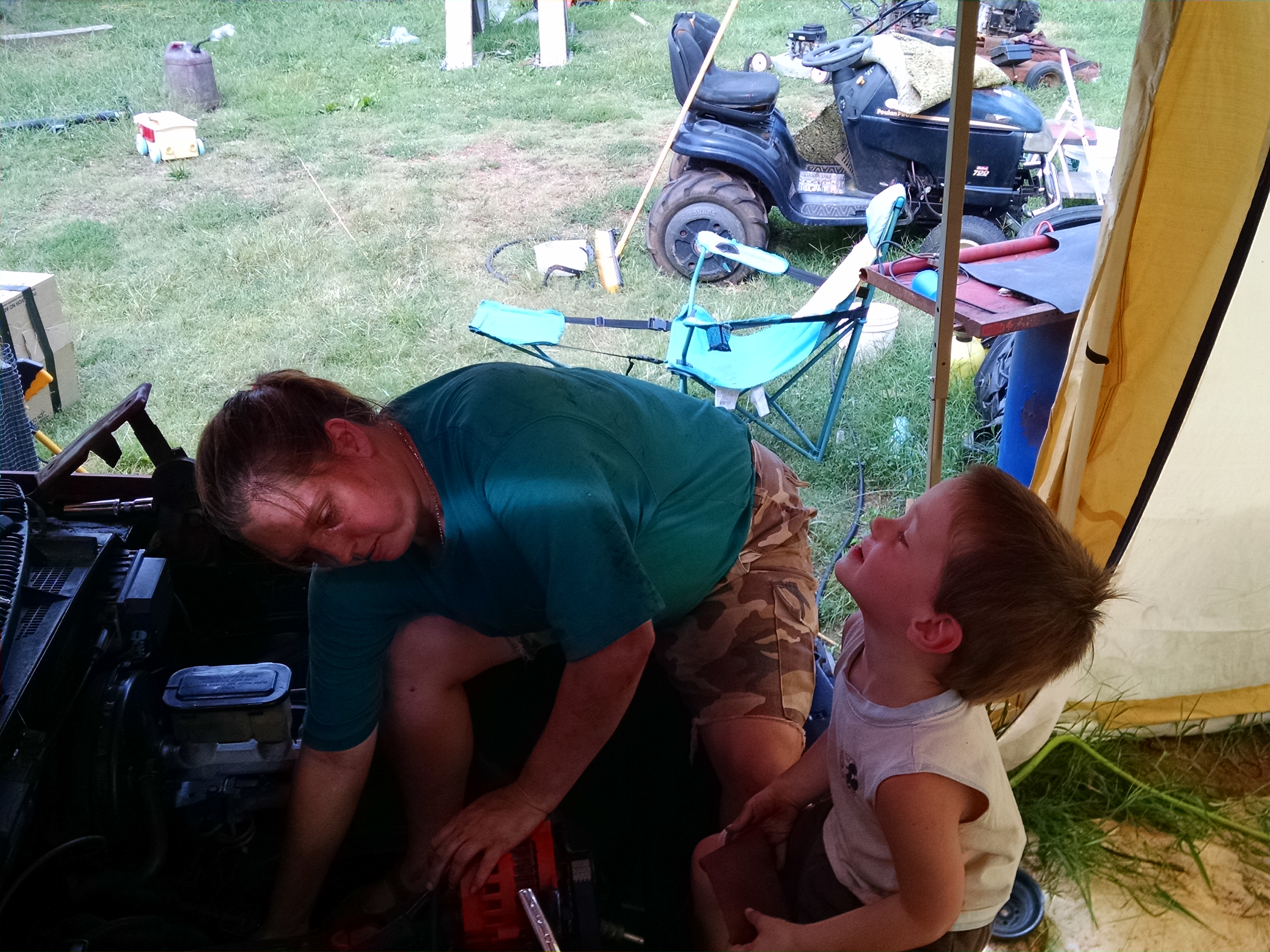

The work force
Steph and Heath lending a hand.

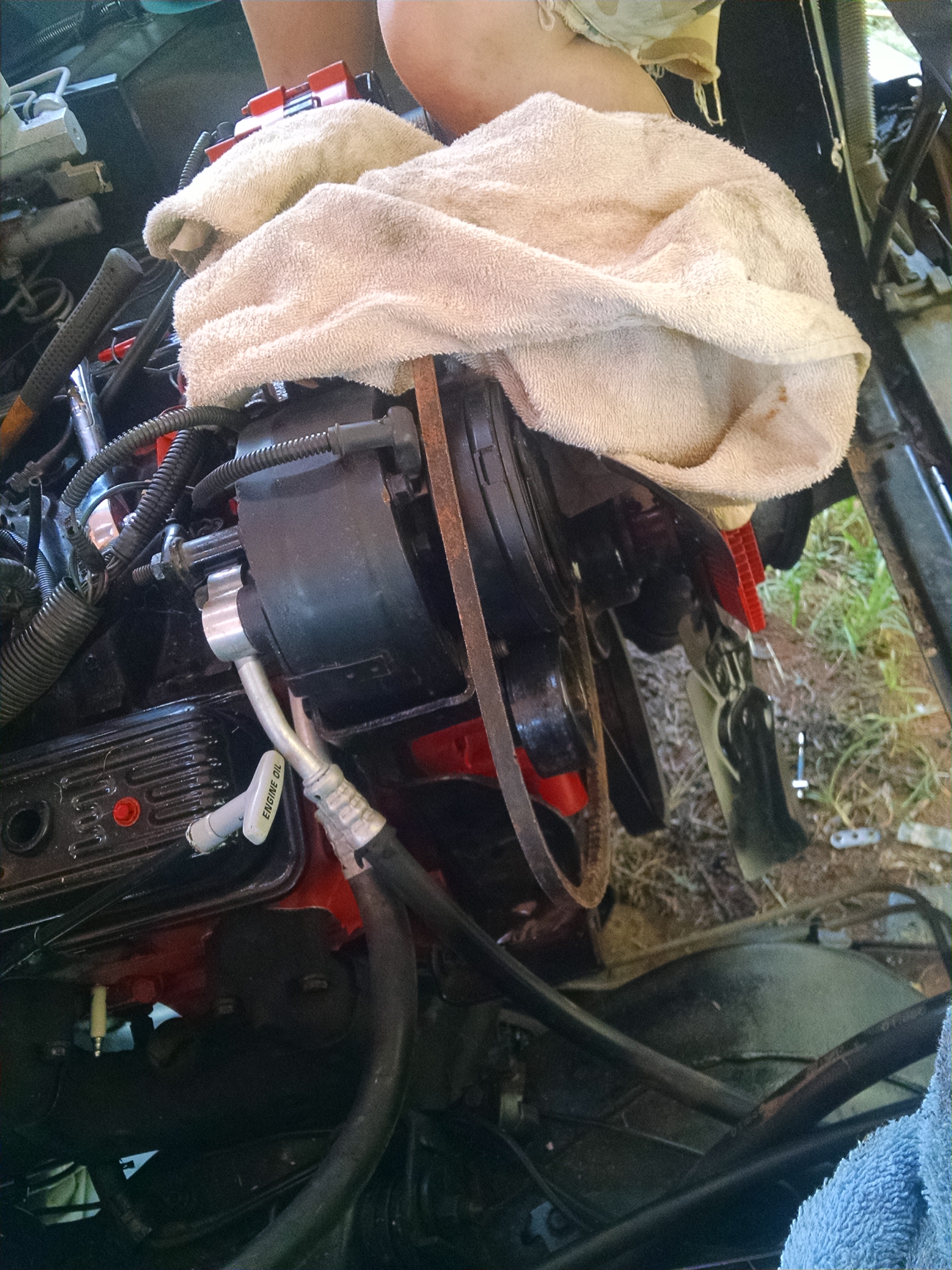

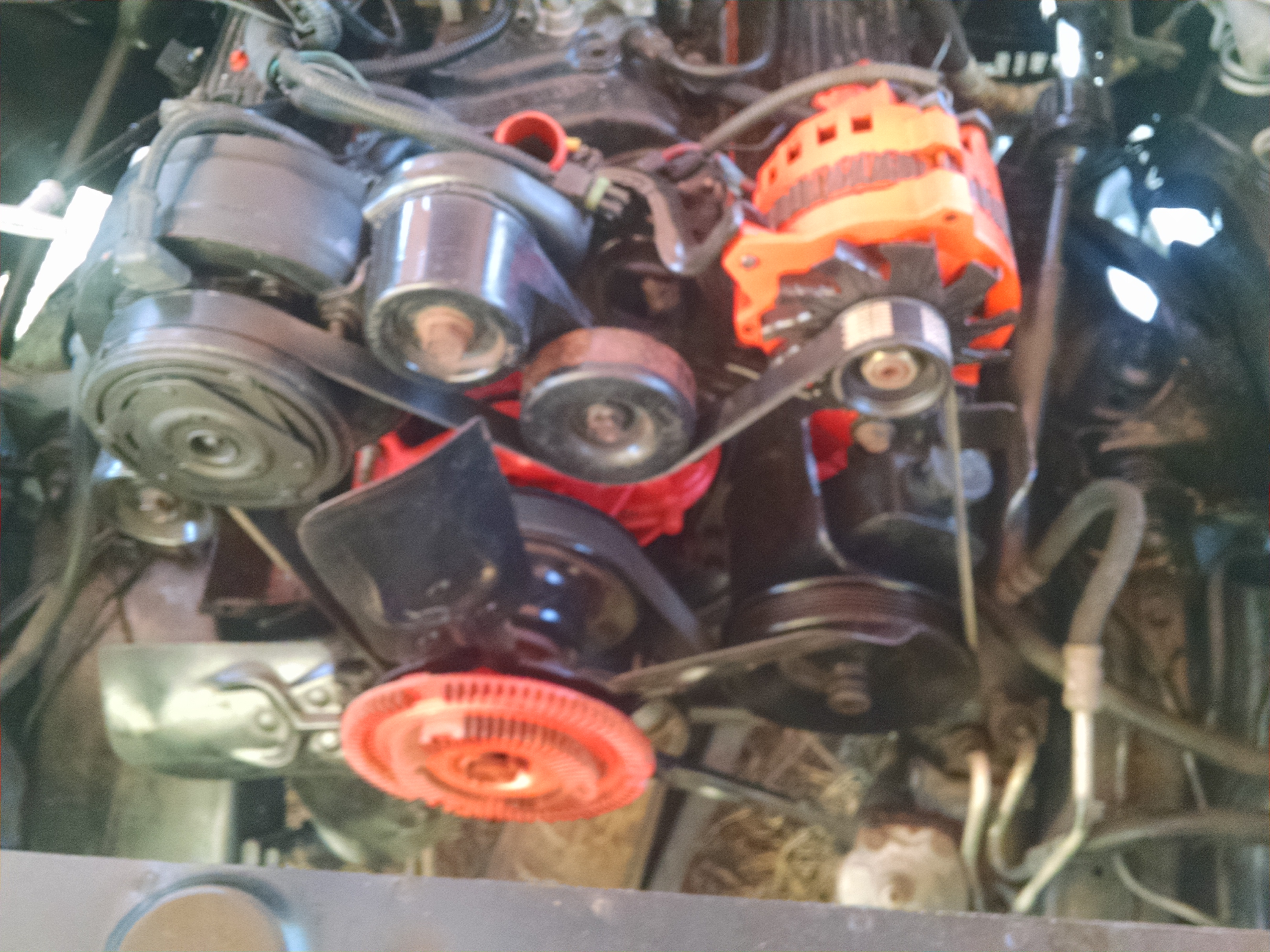

Got the belt on finally.
Had to try three times to get the right size.

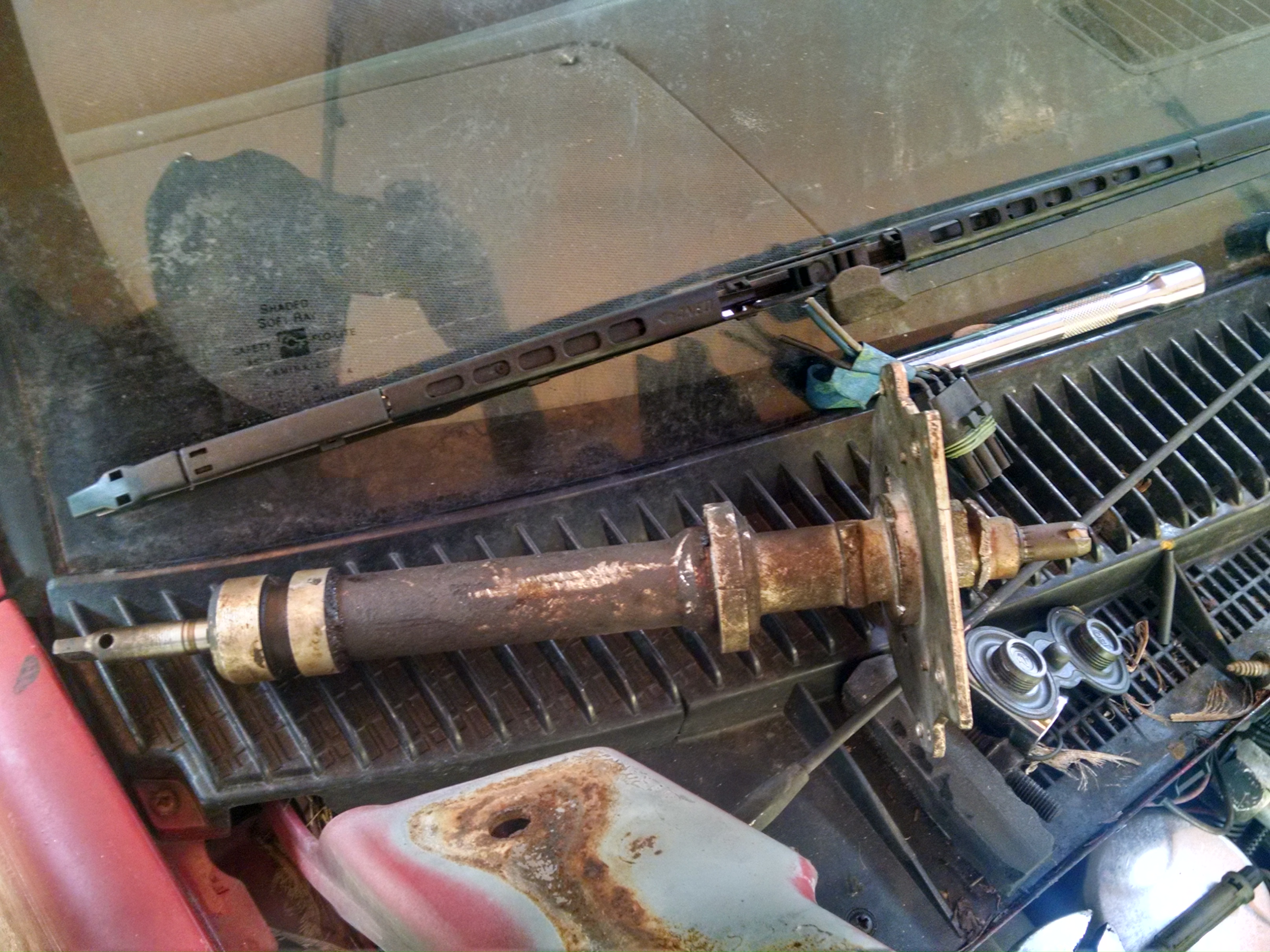

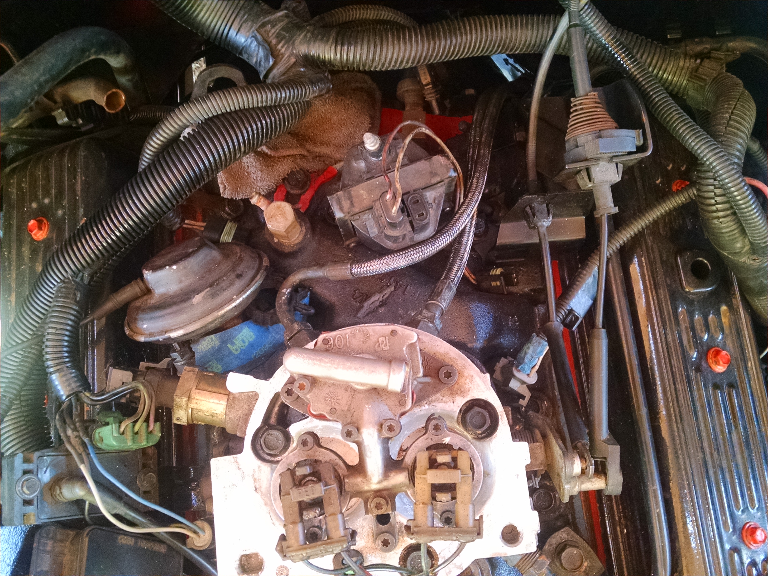

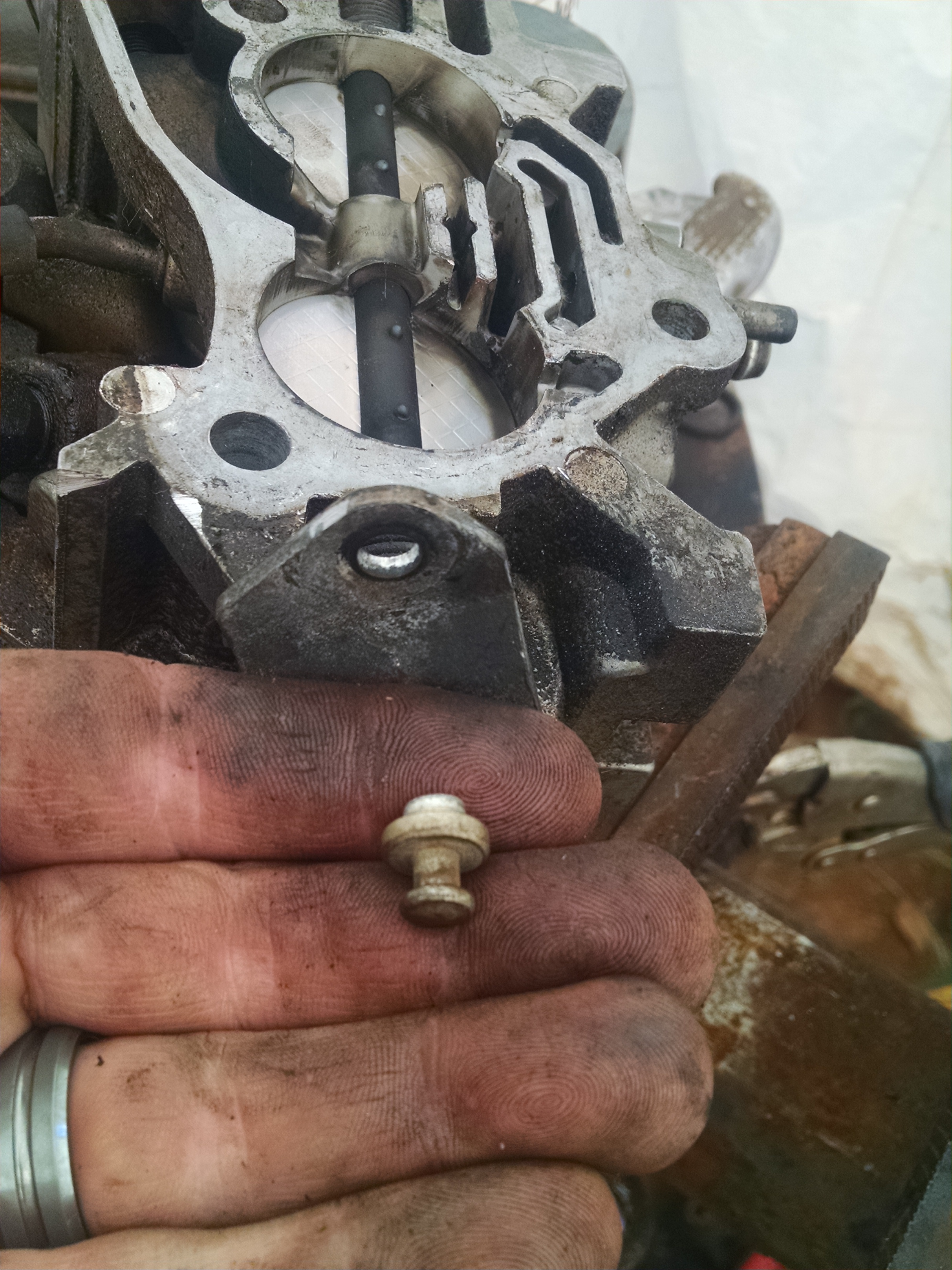

The TBI I am using is off a 94 truck. It has all the ultimate TBI mods done to it . Only problem is my 88 transmission has a kickdown (TV) cable the 94 didn't so there is no provision to hook the cable up. I spent some time removing the stud from the 88 TBI.
Not much there to work with.
Good thing is I have a friend who has a machine shop. I dropped it off with him and he is working on it now.

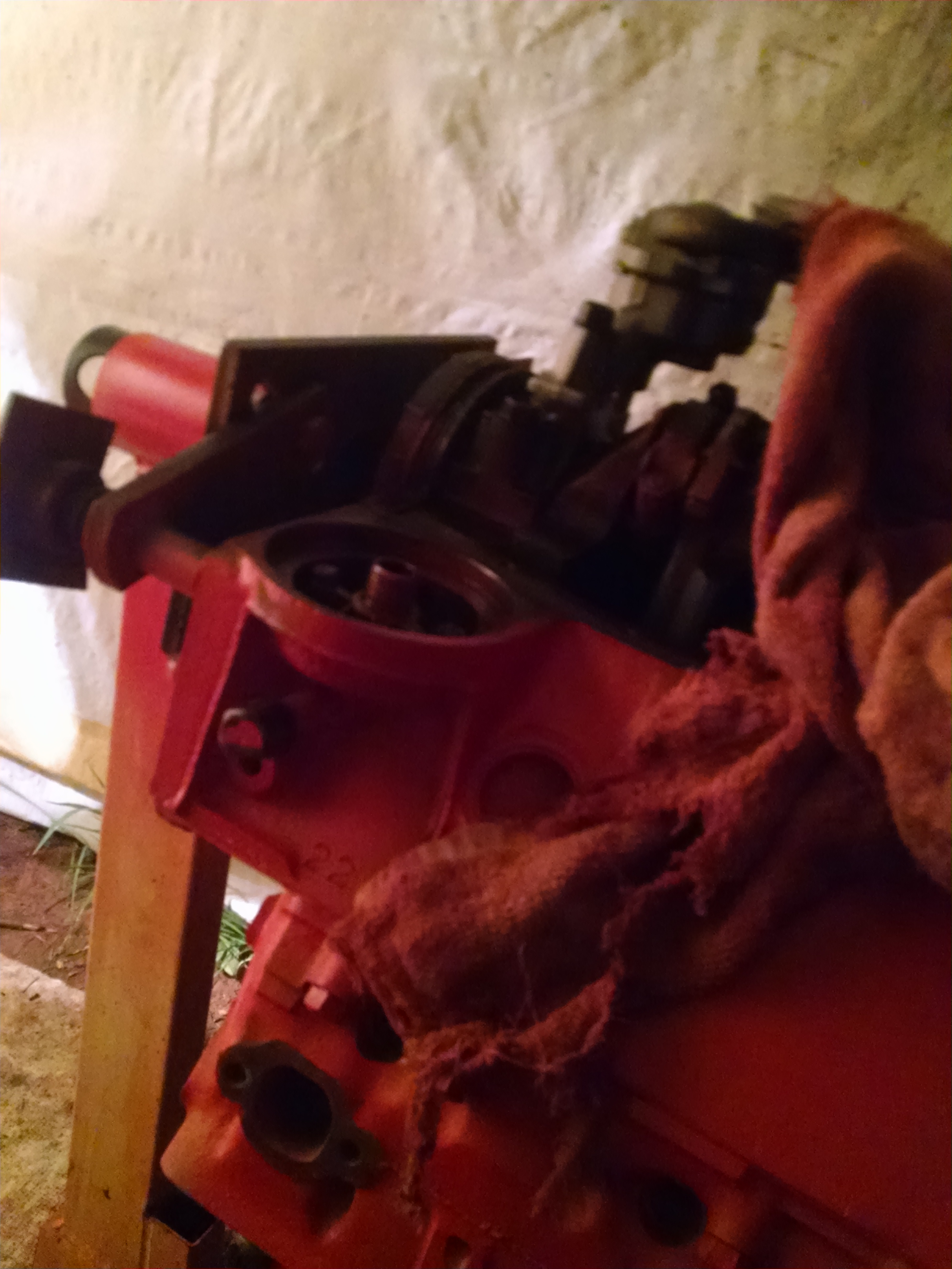

This old distributor was locked up and no good. A little work on the bench and I have it freed up and ready to use to prime the engine with oil when we are ready to start it up.
