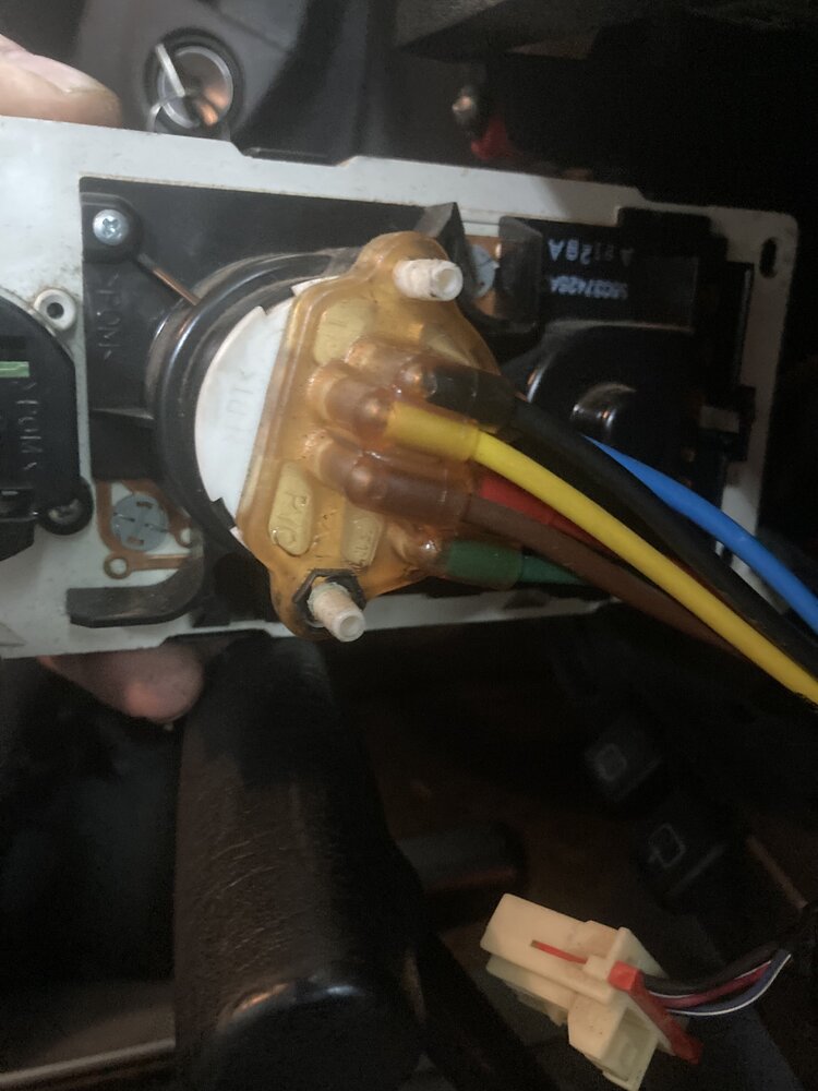

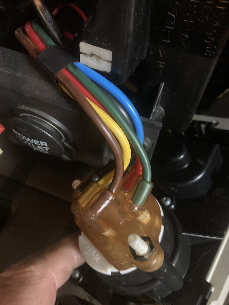

Look again on the HVAC controller, there are wires there too.
There are wires for the fan speed switch and wires on the hot/cold blend switch but none on the ac switch
The vacuum lines are for HVAC control for the mode, recirculation doors, etc. The PCM sees the request when AC or defrost is selected. There are electrical connections inside the control you can't see

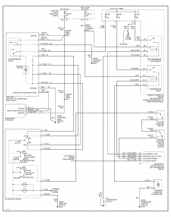

Here is a wiring diagram I found online that should be for a 99 XJ.
I've seen the high pressure switch fail a time.or two. Many times it is a poor connection at the HVAC to body harness connector.

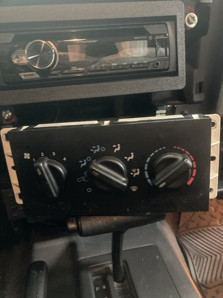

Back to top. Still no AC. I even replaced the control switch panel out with a working one. I am beginning to think it cold be the pcm ??
