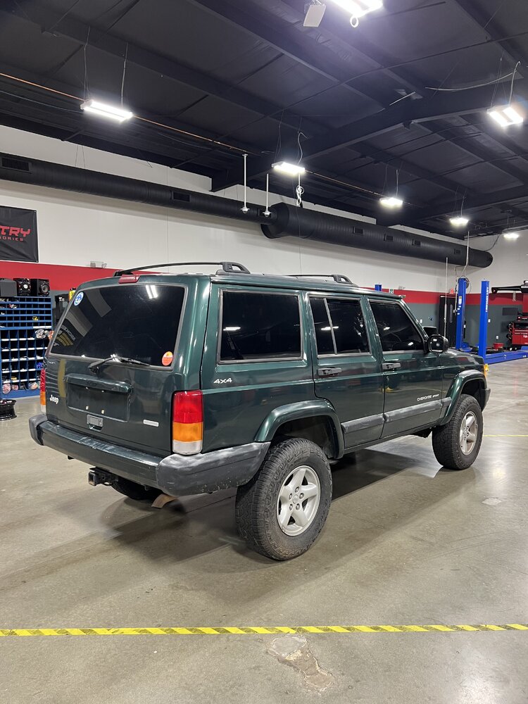

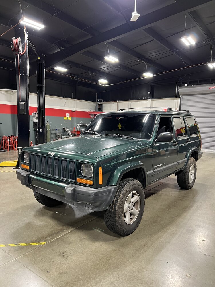

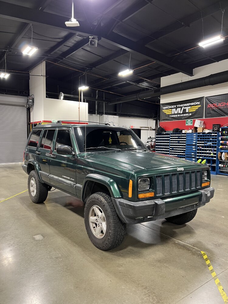

Gonna start a thread on this xj I picked up for my wife last week. 2000 xj, 4.0, auto, 205,000 on the clock yadda yadda. Here is the plans for this build as of now… (subject to change lol) 05+ sd60 up front, 14 bolt rear and a flipped Dana 300. Gonna keep it coils up front and leafs in the rear. Frame stiffeners front to back. Gonna try to put 40s under it and not absolutely hack the body, I wanna keep the tub as clean and stock as possible. Also gonna keep the interior as stock as possible, other than some por15 and sound deadning wich I’ve been working on getting done this past week. But anyway here she is, hopefully it won’t take too awful long to get put together

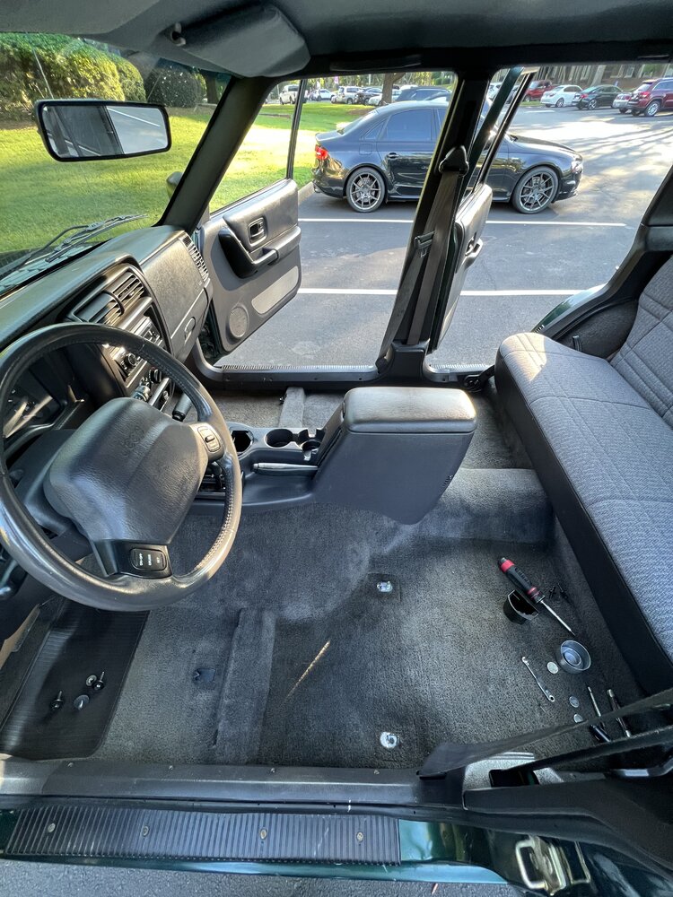

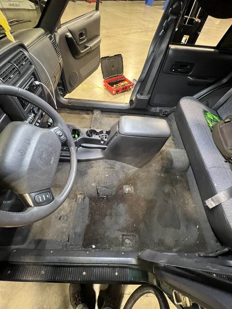

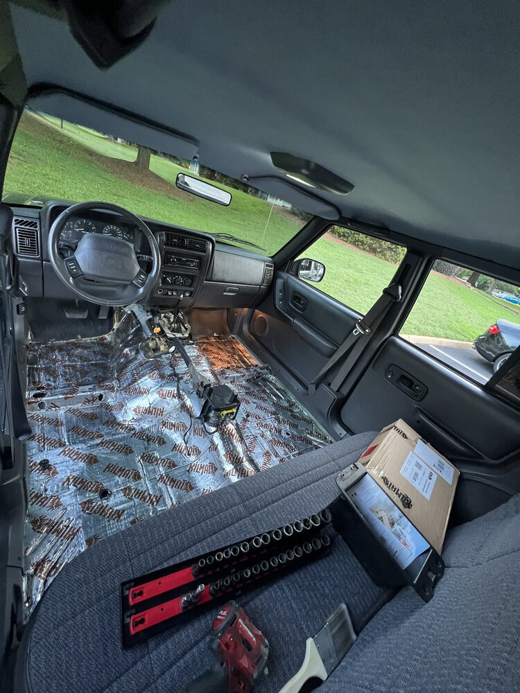

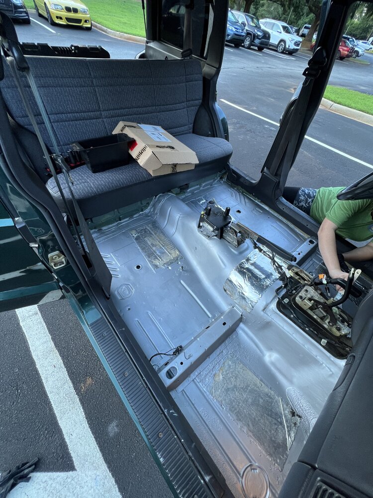

Got the interior put back together this morning, I’m pretty pleased with how it turned out. I ended up pulling all the carpet out, and hitting it with some cleaner and my extractor to get almost all the stains out. I also put down a coat of rust prevention paint on the floorboards just to play it safe. Lastly I put down some 80mil sound deadening on the entire tub
