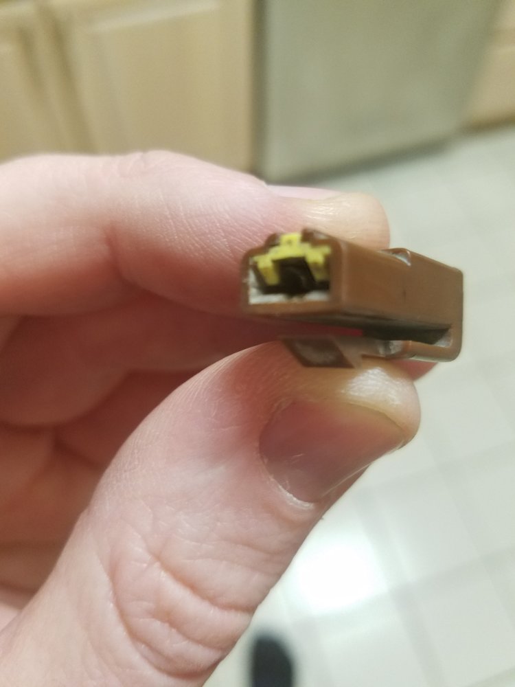

This is the "on" signal connector going in to the starter on an 86-95 toyota pickup.
Broke off right behind connector :kaioken::sniper: So fixing/reusing is impossible.
I know this is a fairly
standard single-wire connector, but what is it called, so i could find one?

thanks for the tip. It does look like that, but it also has that extra tab parallel to the bottom, and no ta locking tab on top.
Its hard to see but I do think the inside is the same though. Unfortunately I can't see into the connector on the starter to see what the mate looks like.

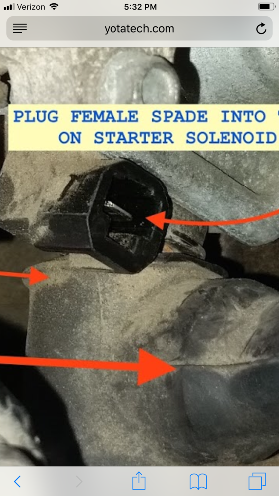

I found this picture of what the other side should look like.
Should be able to take the connector you have apart with the proper tool and reuse it after soldering the wire back on.

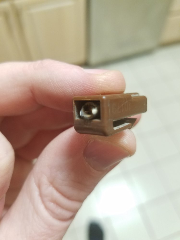

Im not sure what the proper tool is, but I dont see how it would come apart. It looks like you'd crimp/solder the internal connector on, then slip it into the plastic case, which has a press-fit snap inside. So once its snapped, you cant really un-snap wo breaking it.
May be possible, o just dont see how.
This is like most other automotive connectors with a double lock plate. The yellow part is a double lock plate, and it keeps the latch inside the connector from being able to move and release the connector terminal. You slide that out and the latch can be moved, and the terminal can be slid out.
You can reuse the housing if you can find the terminal.
Which is Toyota part number 82998-12060 (160mm long pigtail) or 82998-12580 (500mm pigtail).
And the housing (the brown part with the yellow double lock plate) is Toyota part number 90980-10179 (the 10179 on the connector is actually a Toyota part number, usually that would be something like a connector manufacturer part number).
I would say that connector is a Delphi Metri-Pack 630 Series Unsealed, but they have a rear double lock plate and not a front double lock plate. Probably AMP/Tyco instead.
