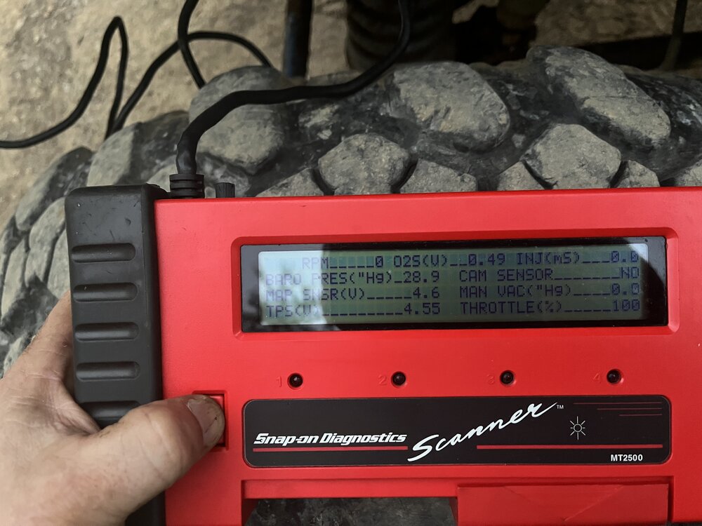

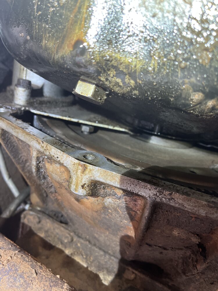

Made it up here. 2 stand stills. One on I20 in Columbia with a wrecked semi. The other on i26 with construction. Stopped in Landrum, SC at the Hare and the Houmd, an amazing Irish pub. Got to Putney 9 hours after we left. It’s 6 hours drive time. An hour out had to stop and deal with a work issue which took about 45 min. Jeeps acting up and consensus was torque converter bolts.

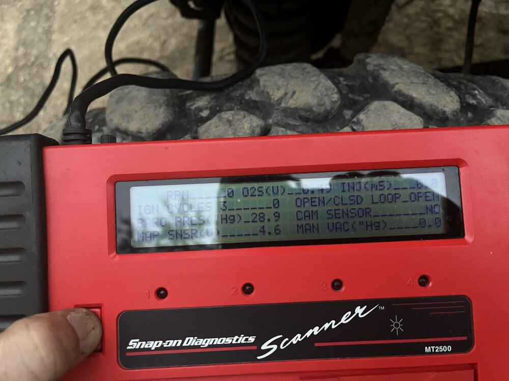

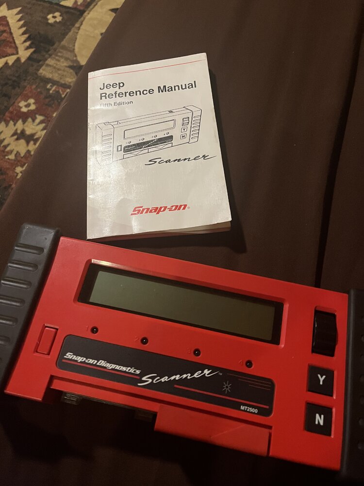

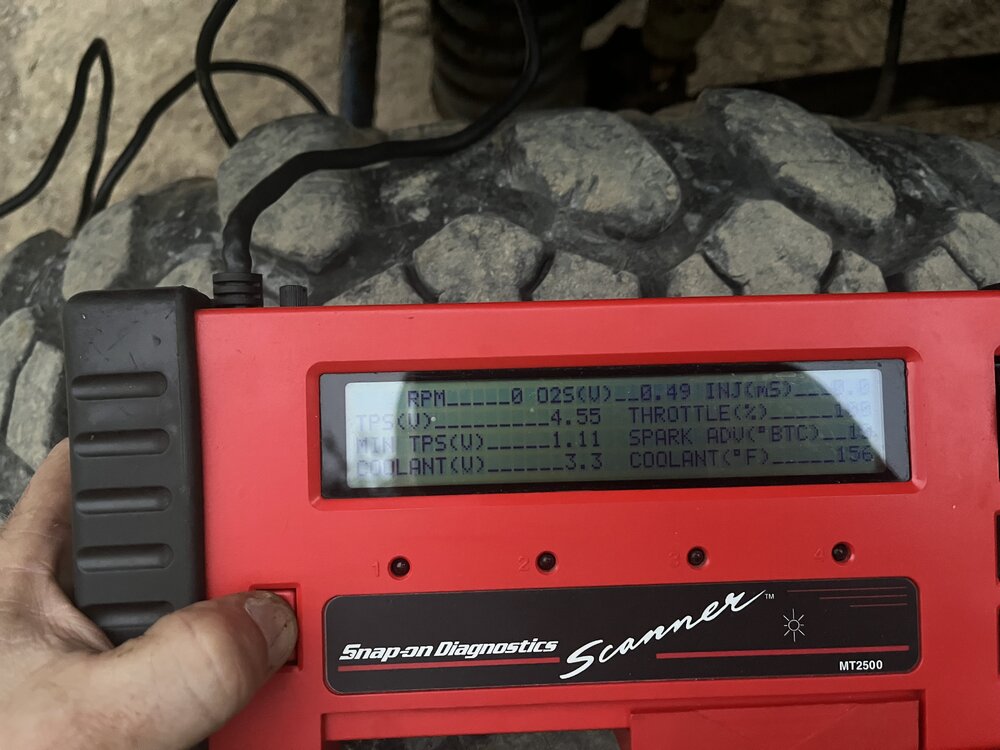

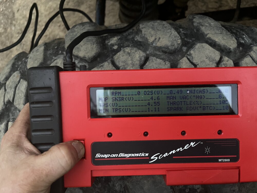

So after tightening all 4 I went for a spin through the campground. CEL and staling. So I broke out the brick.

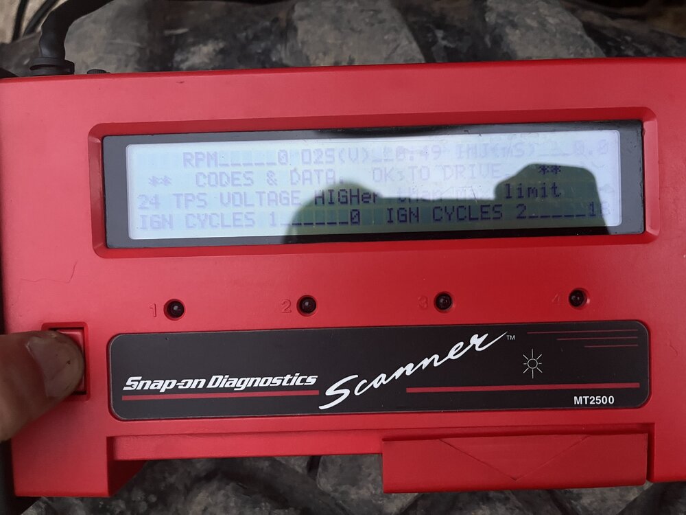

Looks like a TPS issue. So I’ll try a reset tonight and see what happens tomorrow when I go across the road for gas.
TPS seems to have fixed the problem.
