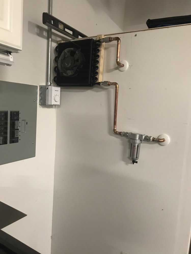

anyone added a condenser to the compressor to help with moisture? i have seen several ways of doing this in the past but, this look pretty clean and economical.
I have. Auto trans cooler, trap from amazon, and a 12V fan I had laying around. I think I measured the piping at 350° in and 125° out. The fan is on a switched outlet so I have to turn it on manually, but it'll catch 1" of water in the trap when filling my 60gal compressor from empty on a summer day. I'm still sorting out the plumbing because it will blow apart a solder joint between the compressor and the cooler above 125psi. Compressor is in a closet I built to cut down on noise.
Are you using silver solder? The soft pipe solder won't hold the heat/pressure.
looks like a nice setup.
