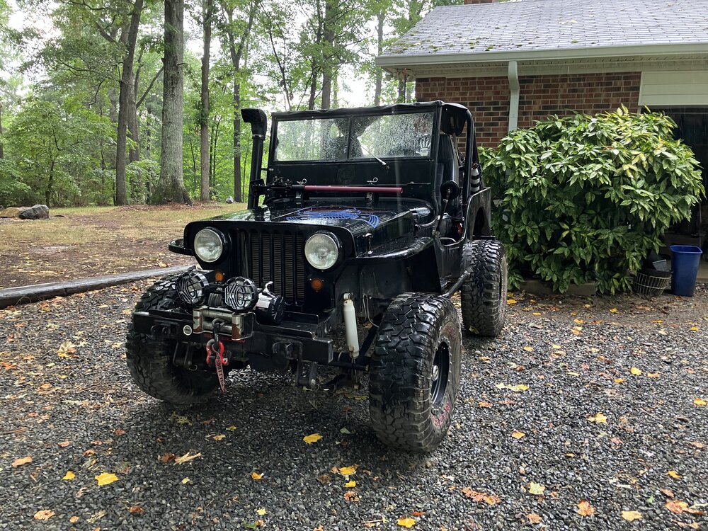

I’m looking for a shop around east side of Charlotte to build a 1947 jeep Willy’s frame. The jeep is currently running and driving but the frame is done. So measurements could be pulled from the jeep if that helps? It can be cut and welded together instead of bent. The jeep is around 2800lbs so it’s light. I’m looking to do yj springs as well. 225v6, t18,Dana 20 and Dane 44s. Any recommendations?

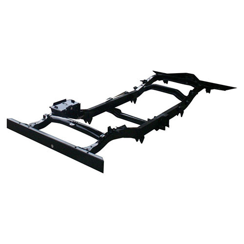

Box in the stock frame, maybe some additional bracing, and add mounts for steering, springs and motor mounts. They have free shipping and you'd still be cheaper than a one off.

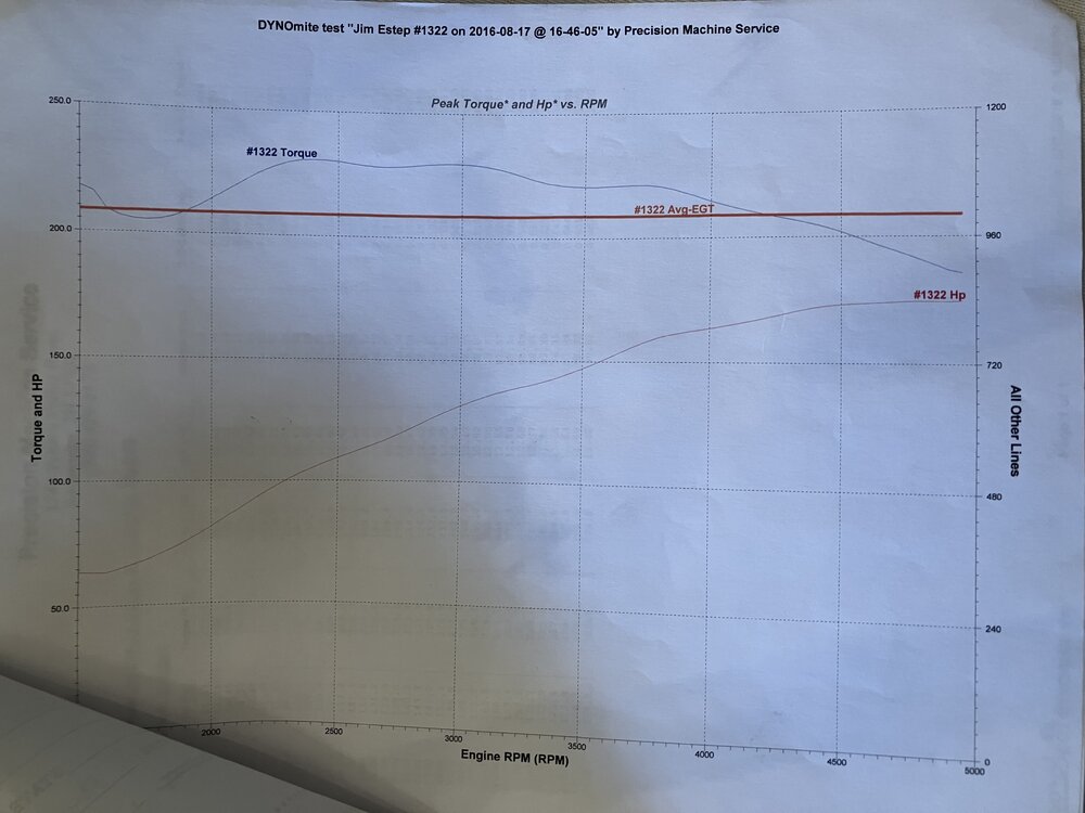

What HP do you expect to get out of the V6? I would think a boxed frame would hold up to most V6's
It dynoed at 178hp and 238fpt. It has forged pistons, howel fuel injection and a custom ground comp cam for Lowe end torque.

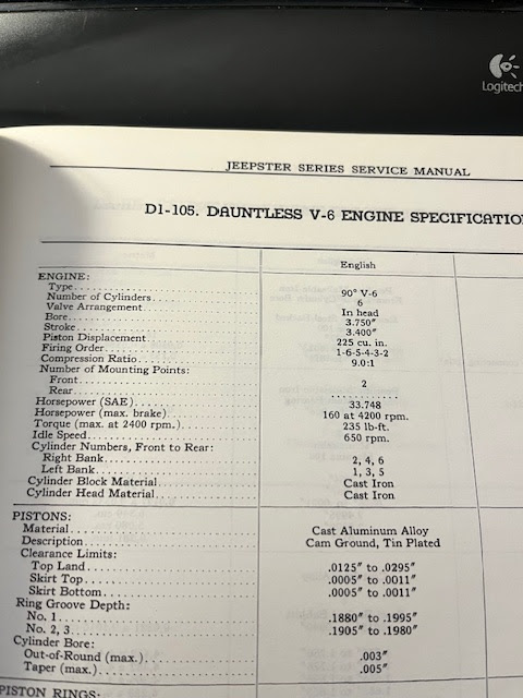

Got out my Jeepster Service Manual for my answer. This is stock numbers. Dauntless is a torque monster especially with the 50lb flywheel from back in the day. Howell doesn't give you spark (timing) with the odd fire. You could do (or surpass) these numbers with an Offenhauser intake, RV cam, and a Holley 430 carb and some long tube headers. A 225 SCREAMS with long tube headers!
Yeah the stock 160hp is sae and not net. 110-120hp is what I’ve seen for a stock engine. But that is still better than the 258i 6. Plus the v6 is about 50lbs lighter than the factory L or F heads that came in a factory Willy’s. I want to say the L head was rated around 65hp? So it’s i big hp jump just with a stock engine. Mine is somewhere around 60hp more than stock. In a 2800lb Willy’s it feels like a ls swap lol
