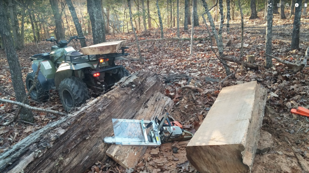

I turned this:
Into this:
Using a Gaston County Kiln:

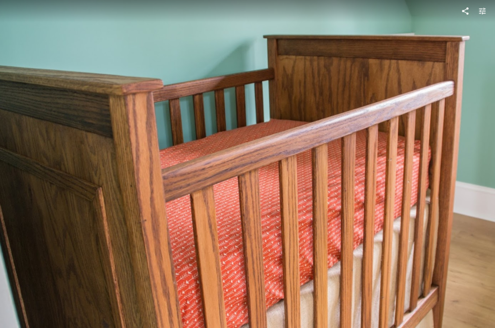

Damn man I like that! I wanna make a crib for my new one coming sure hope it turns out that nice... lol
It was a lot of work, but well worth it. Once the wife stained it and we got it in the room, I realized I hadn't just built a crib, I had built a family heirloom. :cool:
