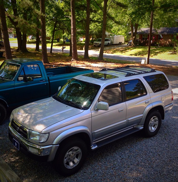

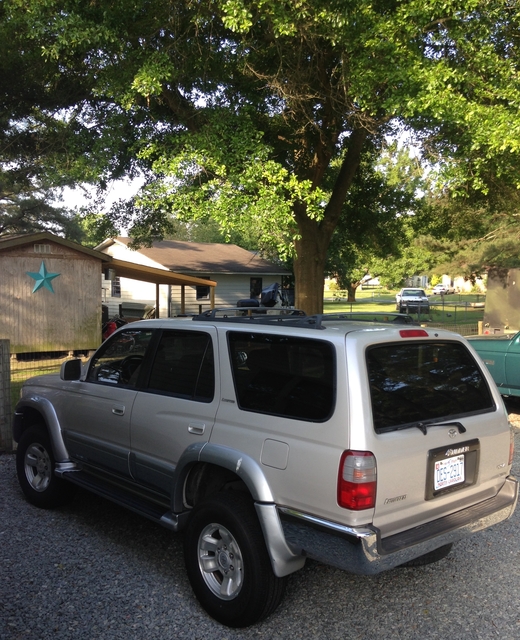

Look hard and you can find a nice 3rd gen 4runner in that range.
3.4 v6 gets good mileage and auto trans is reliable.
Almost all have moon roof, I love my power rear window and they are easy and cheap to lift a little for larger tires.
Mine has rear Elocker, it is worth the extra search in my opinion.
Great off road and take plenty of stuff with you.
I just lifted my Limited for under $100.

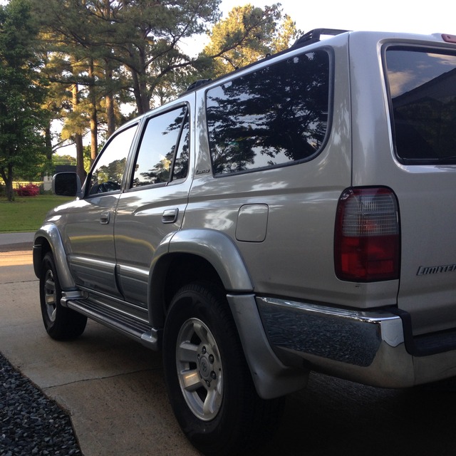

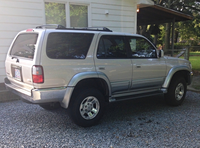

This was pre lift
