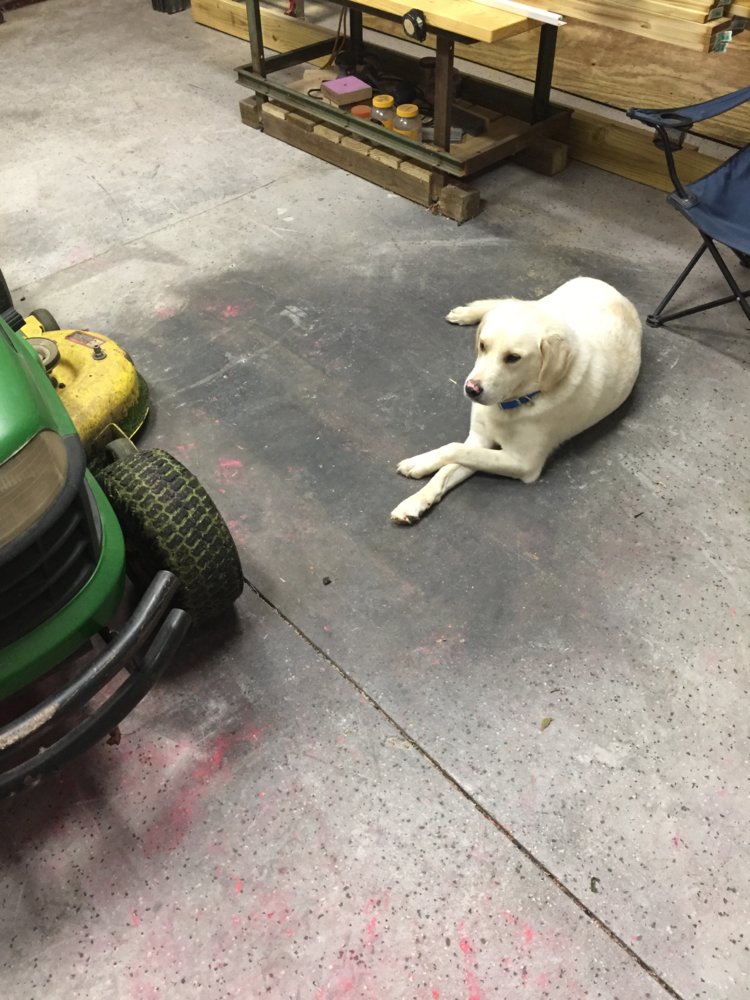

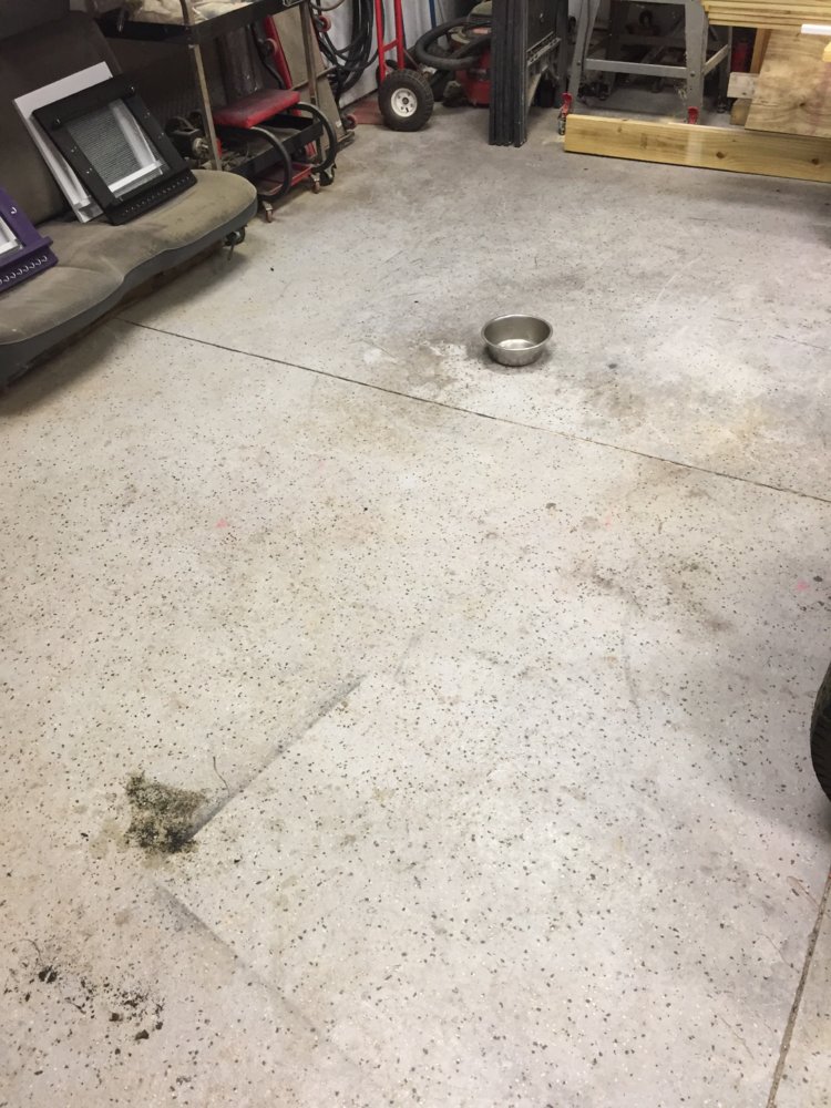

I Know Paint comes up. Not that familiar with epoxy, but I can see it getting scratched up too. When I moved in with a full basement, the concrete floor was nice & seemed clean. I consulted with a friend that was in Paints & Stains. First, we determined the floor had Not been sealed.{Water will soak through}. Then I cleaned twice with Muratic Acid. Then after a few days of drying, I coated it Twice, with a Red Clay colored Stain. It soaks in some, so that's a good reason for the second coat. It will also Seal the floor. It Will scratch, if you drag steel across it, but it wont Peel or or pop off! Looks Good & wasn't that expensive. I got a picture in today's "Random Picture", that shows some of the floor.
