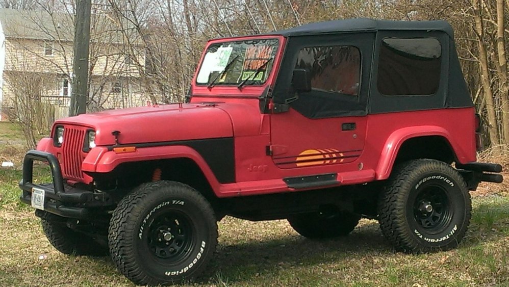

Here's a picture of it what you think

check the frame behind the rear spring hanger!
Also pull back and carpet etc, look at floor boards.
Check steering box for any cracks where it bolts to frame.
2.5l or 4.2? check the rear main seal area for leakage.
I would want to know if that fender was replaced at some point or painted for fun. Check the soft top for holes and see if the zippers work. As mentioned already, check the frame for rust behind the rear hangers. While you are pulling back the carpet in the floor board, take a look at the firewall for any evidence of a water leak from the cowl/windshield. With a flashlight, you may be able to see the amount of oil sludge build up (if any) thru the oil fill cap. Make sure all the gauges work, especially the fuel gauge.
