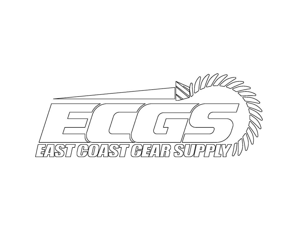

Need GIF converted to CAD (DXF)
What ya'll think? Let's try photobucket since I can't seem to figure out how to upload today?
I still need to touch up a tad and ESPECIALLY set the lines to be drawn in order so I don't break any CNC machines.:beer:

Cperry, I'm thinking that either that what you uploaded isn't an eps, or NC4x4 image upload converted it to a gif. That's what it's calling it be, and besides that, .eps's don't display on web, and that file is. not sure if you emailed it to me, but I'll check when I get to the office in the morning.
yes thats just a GIF I uploaded, I emailed you the EPS file. I just posted logo so people could see it big and we all new what we were trying to create, and when I say "we" thats excluding me, I am just using 3 letter symbols that I have no idea what they mean or stand for or do.
When I google eps file it tells me it's a Photoshop image file? That ain't vector? If someone wants to try to convert, hit me with it. If not, the only way I know is the old fashioned way of tracing? The ring gear didn't turn out like I wanted so I'm going to take another stab. I am only pleased with exactness...
.eps stands for Encapsulated Post Script. and you are correct, there is an .eps photoshop file and yes it is Raster. But there is also a more widely used format that is Vector. The most common and best eps (at least that I have dealt with is an Illustrator .eps) There are other Vector programs that save to .eps, like Freehand, but if you want to get technical, Freehand actually save a Freehand Vector file and then saves a tag in the file info that says "Hey treat me like a an eps so other programs can read me. In actuality it's a fake eps file.

now with the .eps that Cperry sent me, I did this in about 15 seconds. NOTE: this is not the CAD file, just a .gif to view online. I'll email the dxf in a minute.
If you can convert this to DXF then the work is over half done. Next a person needs to assign line directions and order so the CNC laser ain't picking up so many times and going so many directions.
The 3d thing you're seeing is probably just screen res and image size issue. that is just a straight up line art single outline of each object.
And you were certainly right earlier, that ring gear isn't round. and the teeth aren't the same.
Cperry, I just spent the last 30 minutes, cleaning out some junk that was in the file. and Merging some objects that didn't need to be seperate pieces. i.e. the end of the Pinion where it meets the Ring Gear teeth and overlap. that was 4 different pieces when it should be one. as well as overlapping text in red. I also simplified the ECGS Gradient Parts and pieces. There were random artifacts here and there in the file and the Teeth on the ring gear were....not as clean as I would have sent you had I built it. ;) Please don't take those comments the wrong way, My thing is Vector art and I'm particular about line art structure. :beer: I'll email you what I have and you can do with it what you want.

May want to ask a CNC person on here of how deep to set the lines if any? And if the characters need to be solids so the laser cuts it out and not just individual lines?
