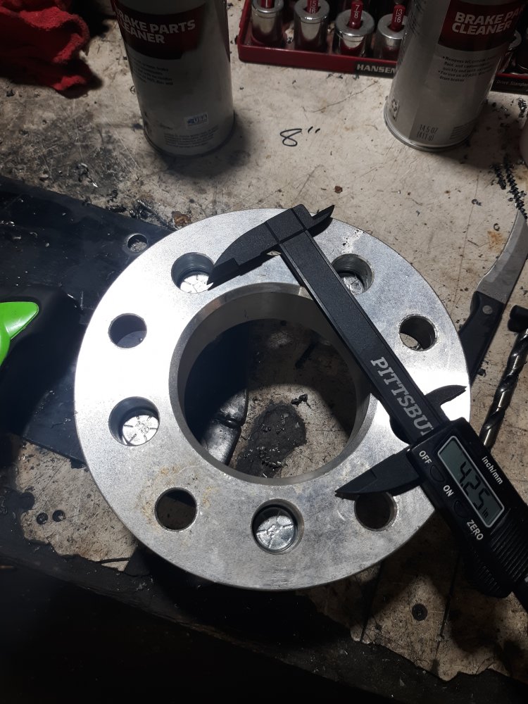

Found a good deal on a set of JK/JL steelies that might work out well on my cheapo Sami project. The price is definitely right, but I need to find a way to actually run them. I've found a few 5x5.5" to 5x5" adapters out there, but most are hub-centric with a ~87mm or smaller center bore. Not finding anything with the larger 108mm bore.
I could buy a set of the smaller bore models and have them machined, but I wonder if they don't exist because it wouldn't work/work safely. My rough math would say that a 108mm bore (~4.25") would leave about an 1/8" before you'd get into the lugs on the 5x5" pattern - is that just not enough to be safe? I'd have to do the same thing to the wheels as well.
I want to keep the rig cheap, but not at the expense of safety.
If you get some ill bore the centers out for you cheap, but it definitely sounds a bit sketchy on the clearances. You'll have 1/8" wall IF they are 1/2" studs WITH 1/2" shanks.

I've got a set of them I used for mock up. 100$
4 5.5 to 5x5 adapters with the 87mm center bore
@1stgenxxx Do you mind measuring them to see if the 108mm would fit between the 5x5 pattern with any material left? You'd be contributing tech that would help 1's - possibly 10's of people!
I'm thinking that's gonna be a hard no
How deep does the 108mm bore need to be? Its no issue if it cuts into the stud counterbores.
good question. I didn't think about that
It looks like the first inch or more would need to be in order to clear the hub bolts. I'd have to pull the wheel to know for sure. And the lip and mounting face of the hub may be more like 106mm, which probably doesn't make a huge difference. The hub body after that is around 90-91mm (3-9/16" ish)
well just go ahead and buy these or trade me something cool
Don't think it's gonna work for me hoss, easier if I just use some wheels with the right bolt pattern to start with. But I appreciate your help figuring it out.
