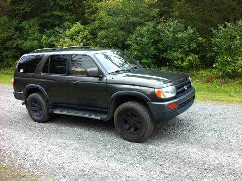

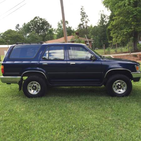

1992, 4 door, 4wd, very clean. 3.0v6, 150k miles, asking $2850
1998, 4 door, 4wd, very clean, 172k miles, 3.4v6, asking $4500
Is the 3.4 worth the extra $2000? Its newer, looks very nice, but the 92 is very nice as well, just not as many modern touches to it. Just curious what you guys thought would be the better choice for the money. Thanks.

They are firm at 4500 on the 98, which is above book value. Is it worth it ?
ask about service history, look radiator trans cooler lines very close ( if you buy it, install remote cooler and abandon cooler in radiator, they are a known problem for mixing fluids due to cooler failure) check trans fluid, it should be blood red, not pinkish
ask about timing belt and water pump (unless they have recent proof, plan on doing this asap) if the belt breaks, no big deal, line it all back up, put a new one on, if the water pump goes and you over heat, the heads are gone. don't do one without the other
all tires same model and size ? turn radio off on test drive, listen for noise from rear axle, pinion bearings are an issue, not tough to fix, but not cheap easy either.
if you buy it, grease EVERY fitting in front and rear driveshaft (there are 5 fittings on rear shaft)
